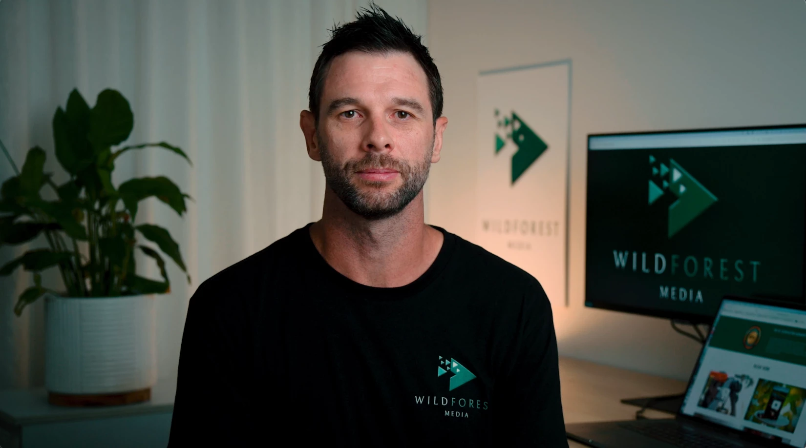

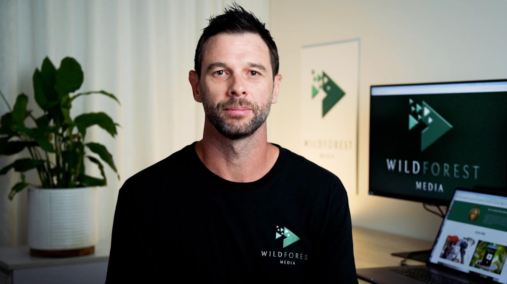

If I export in Premiere Pro (ver 23.1), the rendered file looks good. However, if I send the sequence over to Media Encoder (ver 23.1) to export (and don't change any settings - i.e. no presets applied or export settings changed), the resulting file is massively over exposed. I have re-installed Media Encoder, resetting all preferences, and am still experiencing the issue. (Exporting H.264 file). Any idea why the massive difference between exporting in Premiere vs Media Encoder? Please see the screenshots attached for reference. Using MacOS (ver 12.5). Thank you.

Please find a link to a short video below illustrating the issue. Note the massive difference in the exposure of the two different previews. I didn't show the final renders, however, the final renders look exactly the same as the previews so I didn't bother.
