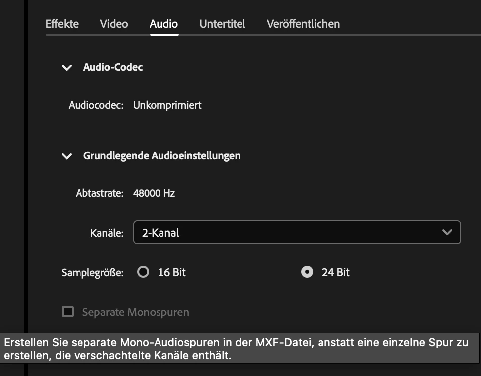

MXF XDCAM audio tracks option "separate mono tracks" is greyed out: counter-intuitive and confusing
Many formats have the option to choose between joint stereo channels or separate mono tracks. For broadcast, separate mono tracks are often required. When choosing the XDCAM codec this option is greyed out in AME. The tooltip on mouse hover just says what the option normally *would* do, but not *why it's greyed out*.
To make matters worse: depending on which preset you're coming from it is either shown as checked or unchecked whilst still greyed out either way, making it seem as if it's not active in some cases and not even possible to activate, because it's greyed out. Took me quite a bit to realize with this codec the option is *always active* despite being greyed out and sometimes incorrectly shown as unchecked.

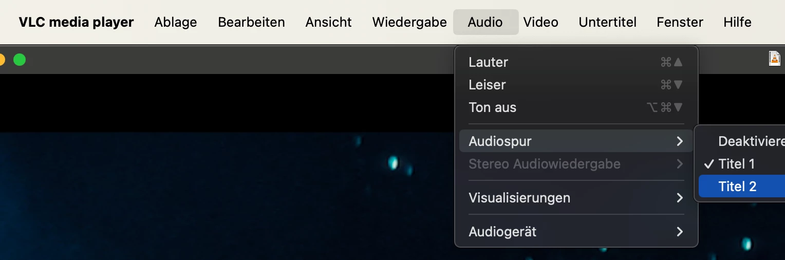

Further adding to the confusion: Premiere is interpreting the files we exported automatically as one stereo track by default. For practical purposes that would be fine– IF it didn't lead us editors to believe we weren't exporting separate mono tracks as required. This behavior is quite misleading in this context without any indicator showing the actual audio track structure in the file. There is no good way to check without using third party software (we ended up using VLC to verify that we actually did have two separate tracks) Even "properties" shows it as just "stereo" in Premiere, not 2 mono channels so there is no way to tell. This cost us a lot of time.

1) AME should indicate clearly that MXF XDCAM is exporting as two mono tracks and that this is not only the default behavior, but the only behavior. Greying out the unchecked checkbox implies the opposite so that option should either always be shown as checked or hidden altogether.
2) Mouse hover should in this context change from the current description to instead state that this codec only allows mono tracks.

first of all thanks for reaching out to us and give your feedback on our apps. Regarding the checkbox, only IMX and AVC codecs will let you make changes in this settings. For XDCAM it is greyed out, because we will output discrete channels only, following the XDCAM standard. I do understand that showing a checkbox, which is greyed out is confusing and yes we could consider to hide it completely for XDCAM or work on adjusting the tool tip. On the other hand, the XDCAM MXF integration is widely accepted and there is currently no plan to work on this area except for bugs of course.

I'm unsure if I understand your reply correctly. What is valid? I have the issue with MXF XDCAM, I haven't checked if it also persists with AVC-i or IMX as I usually don't deliver in these codecs.
The main issue in my view is that the greyed-out checkbox for separate audio tracks is inconsistently displayed as either checked or unchecked.
Separate audio tracks seem to be a forced behavior here, so the box should always be displayed as checked maybe with a mouse hover hint explaining the limitation to avoid editors losing time unnecessarily on troubleshooting.
