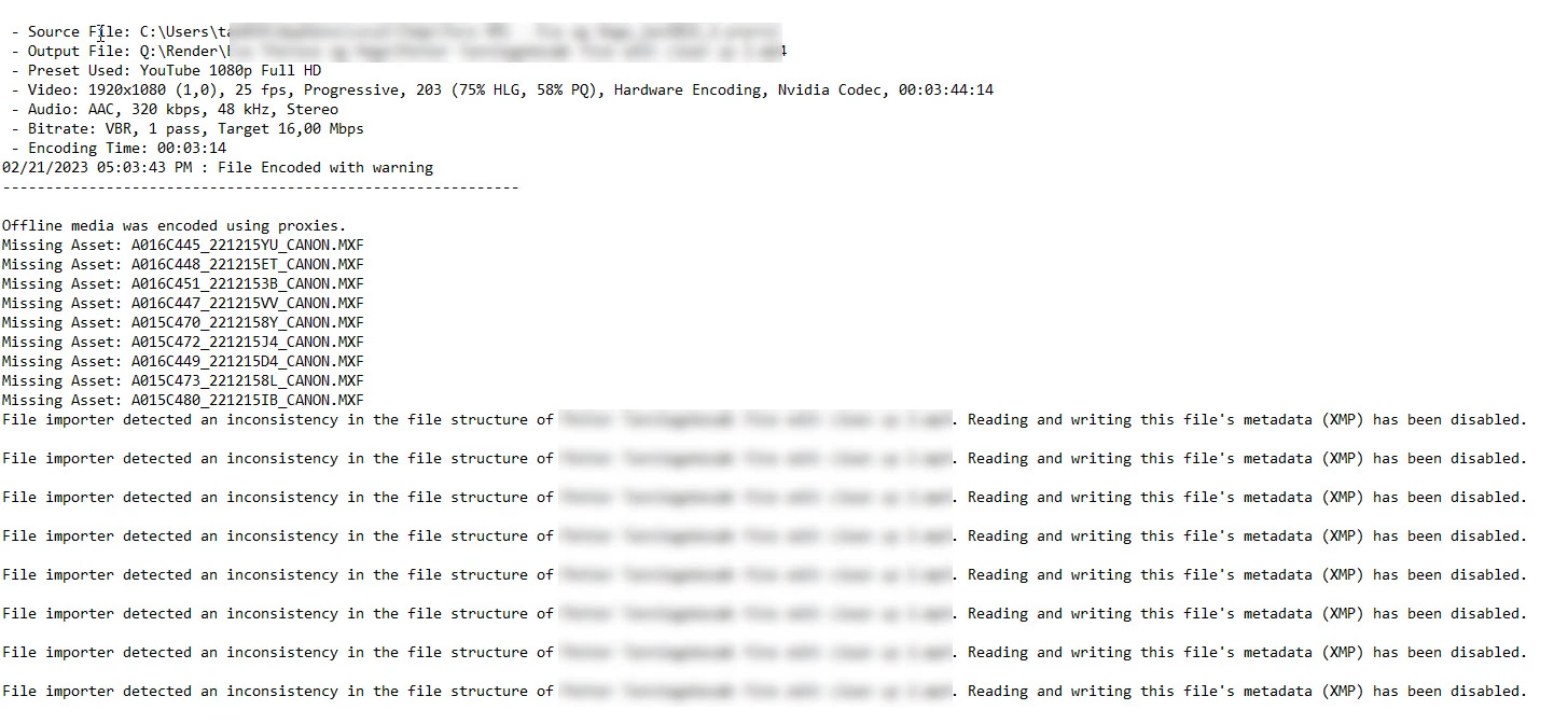

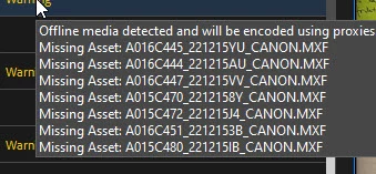

I've exported a sequence from Premiere to be rendered in AME. No missing or offline files are reported in Premiere, but when AME opens I get a warning.
"offline media detected and will be encoded using proxies"
I don't know why this happenes, but the files are not offline and I can render the sequence just fine from Premiere. But AME use the proxies files when it renders. There is no reason for them to be "offline" in AME and not Premiere.
Please help, thanks!

Turns out the new AME render didn't use proxies, and didn't give any warning before starting the queue. But it did give the rendered file additional text in the filename (underlined in the log below) and a warning once the queue was finished about some problems:
02/22/2023 06:41:13 PM : File Encoded with warning
File importer detected an inconsistency in the file structure of filename_AMEnewSetting.mp4. Reading and writing this file's metadata (XMP) has been disabled.

I though you ment natively import the sequence from AME, but that gives same error/warning.
But now I realize "import sequences natively" is a preferences setting.
Once I unchecked that the sequence imported without any offline files and proxy replacements. Don't know what I risk by this, but the problem seems to be solved.
