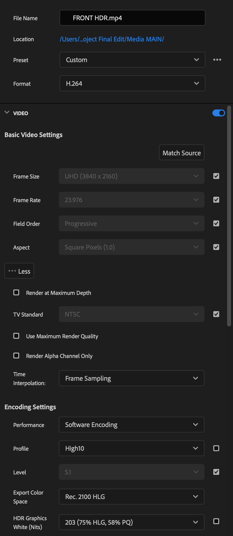

I did an HDR export using Media Encoder from a sequence from Premiere. I noticed I was having poor shadows and highlights compared to the preview from the sequence.
I rendered all settings identical but exported natively in Premiere and everything looks normal.
There is something wrong with Media Encoders export quality.
I rendered two videos with identical export settings between exporting through Premiere vs. Media Encoder in this dropbox link: https://www.dropbox.com/scl/fo/ieukixvapaxscde37qpnw/AJ8_Ayp-fd-MgD-DZwmNQEc?rlkey=grxpm8ohdv7ewjvfa8i2z0z81&st=iv56wwhd&dl=0
Please note that dropbox preview does not display HDR footage, so you'll have to download the video files to see the difference.
Below is the screen grab of my export settings.

Hi, are you able to share the source clip with us aswell? Did you try if the issue persists in the latest beta versions? Could you also share the hardware you used on export? Thx!

Can you try in AME Beta as well? Would you be able to share project and files for us to look into the issue?

I reverted to Media Encoder version 25.2 and export quality is back to normal. The bug is specific to 25.3.
