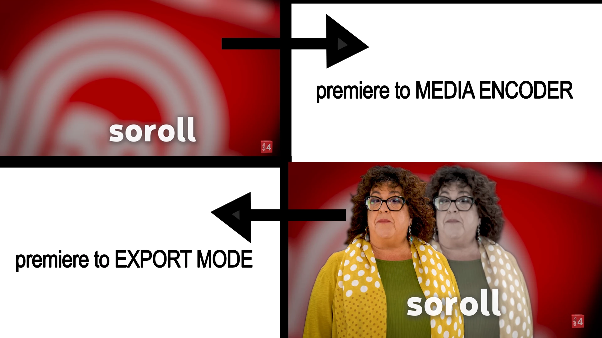

    I’m happy to share a consolidated project, but I’m getting the similar results as ​@shernandezlechuga below. The subjects in the foreground drawn with Object Masking do not appear or I get flickering similar to viewing the interlaced frames individually. The masking Pen seems to work oddly enough in those frames, but more importantly exporting directly from Premiere resolves the issue, but watch out because Frame IO uploads work fine as well and might give someone the impressionable is good.  I may test interlaced VS non interlaced. File type export MXF Op1A and MP4
    shernandezlechuga
    February 12, 2026
    Estoy teniendo el mismo problema al enviar la secuencia a media encoder para exportar. No exporta los segmentos donde he utilizado la nueva herramienta de máscara de recorte. Si lo exporto desde Premiere el video se genera correctamente. Pero no lo hace si lo exporto mediante media Encoder
