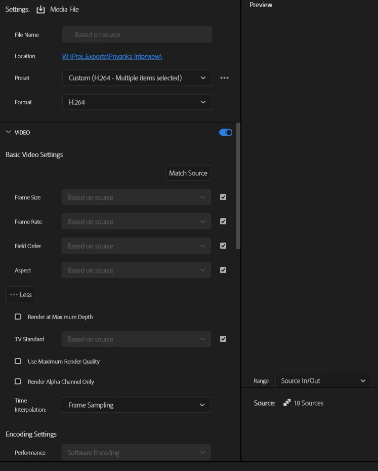

I am experiencing this same behavior. Windows 11, Premiere 25.3.0. I can a master sequence into smaller sequence clips. When I select all those sequence and export them to Media Encoder it ignores the fact that I have "Source In/Out" set under "Range." Each clips is the full 18 minutes of the master sequence. When I check it's setting in Media Encoder, "Source Range" shows "Sequence In/Out" but has the entire sequence selected. Aggravating. I will have to render all 17 one at a time.
Premiere:
Media Encoder:
