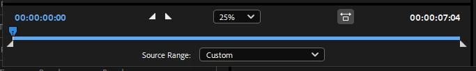

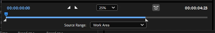

When encoding a PP sequence in ME, if the source range is set to Work Area when in PP in the Export pane, I am having the in-out points change when more than one preset is applied to a single source. In ME I check the export settings for that source, the first instance will show the in-out points to be the full work area from PP
when I apply a any number of additional presets and check the export settings those instances all will show a truncated in-out points on the out point end.  (see screen captures of the in-out points).
Changing the range to Entire Range will return the in-out points the full sequence (work area).  Or I can manually extend the out point - which creates a Cusotm range.

But now the odd behavior is that the renders from the additionally applied presets are truncated or shortened, but the render from the first applied preset is the full Work Area.  When I redo the renders I have to now also confirm that the in-out points are indeed the full Work Area by moving the out point from inside the Edit Settings pane - and when I do that the Source Range updates from Work Area to Custom.  That is what my screen captures were showing.
