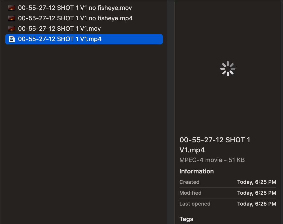

Transcoding Prores 422 Mov to H264 Mp4 (match source high bitrate) simply does not work
And this has been bugging for years.
On Intel Macs and My M1 Max 16" Macbook pro.
AME 2021, 2022 both do not finish packaging the file resulting in a 51kb file.

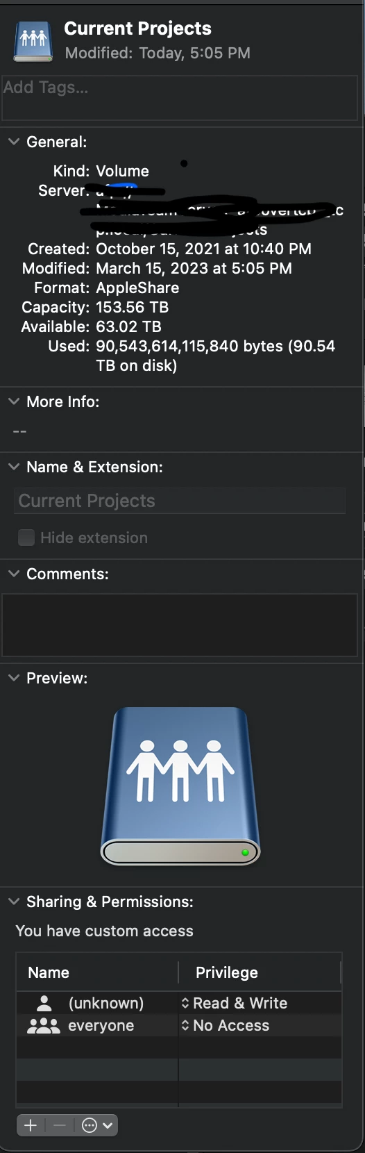

Here's the get info page on the shared volume. Format is Appleshare and requires my login to access the drive.
It's bizarre that MOV and general editing works but this only interferes with mp4...

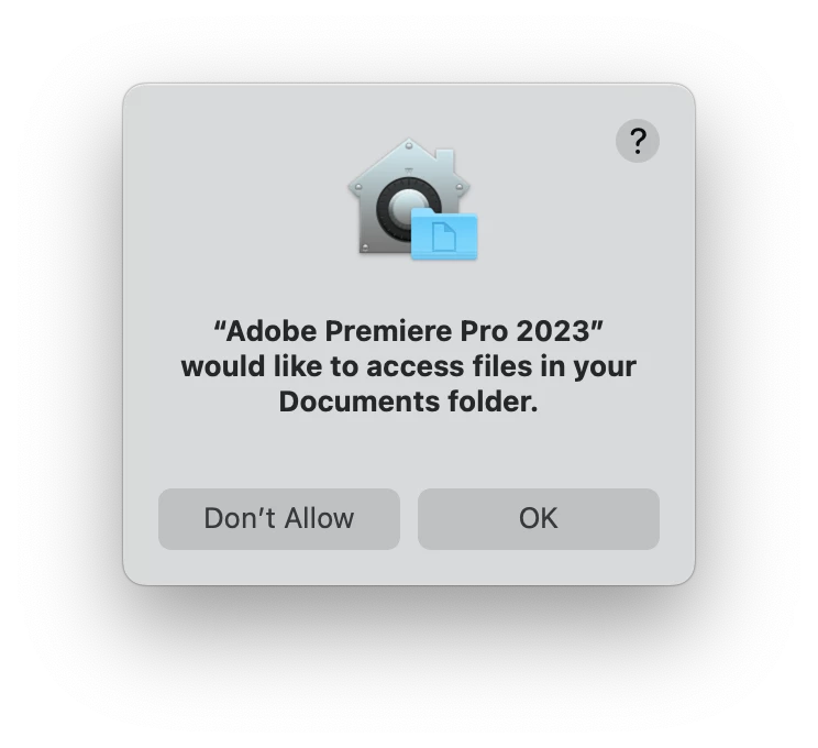

When macOS prompted you to grant access to Adobe Media Encder, did you choose "OK"?
Here is a sample of what that looks like for Premiere Pro.
What format is the "Current Projects" drive?  HFS+, APFS?, ExFAT?  FAT32?

The 51kb looks more like nothing was written and that accross all versions (2021/22/23) while working in 2020. If possible please share the original MOV file for reproduction together with the Export and Error Log files (Menu->File->Show Log/Show Errors) to see if there are some more information or any error message in it. I assume that other files are working correct, right? The sample image shows the ...no fisheye.mp4 with a thumbnail.
Nov 3, 2022 10:31 PM UTC
If I choose another preset - youtube 720, vimeo 1080, etc same result - an unfinished file that either plays only the first half or doesn't load at all, again with same 51kbish small file size.
