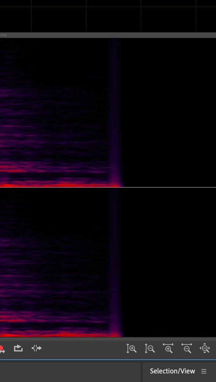

I'm a voiceover artist who does a lot of eLearning narration. One client has a particular requirement of audio files split by file name, with 150ms of silence added to start and end of each file.

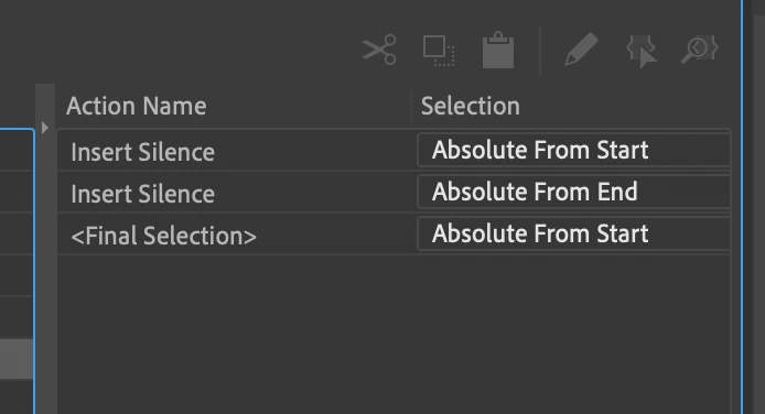

I have a favourite called 'add 150ms' of silence and after I've split the files I batch process the files by dropping into the batch process window and running my favourite. Works great - HOWEVER sometimes audition adds an audible click to the end (and sometimes the start) of the file.
As it's not constant I therefore have to go through each file and check the start and end of each file to ensure the click isn't there and using auto-repair keyboard shortcut to remove.
Given the inability to navigate the files area with the cursor keys, it means I have to go through EACH file by double clicking - which is a ball-ache.
Why does audition add this click sometimes? Picture added to help explanation.

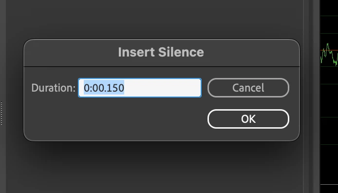

The 'add 150ms of silence' shortcut is shown in screenshots...

Almost certainly zero-crossing errors, if it's random. If you join silence to either the start or end of a recording, and that start or end's waveform isn't at what's called a 'zero crossing' - which is where the waveform passes though the zero point between a positive and negative, you'll get a click which is generally full bandwidth (yours are) where the waveform trys to jump instantaneously from zero to whatever the start or end point is on the waveform - which it can't do.
Fortunately the cure is simple. Right-click on the timeline, select Snapping, and then select 'Snap to Zero Crossings. Doesn't particularly matter what other settings you have in it - that's the important one. And make sure that snapping is enabled. Now, when you make a selection, the ends of it will always be at a xero crossing - so joining silence to it shouldn't cause a click.
