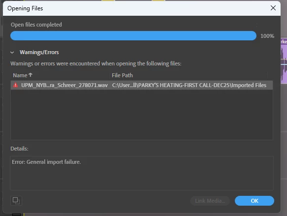

    ​@SuiteSpot I had a similar thought yesterday, I’ll get into that in a minute. But looking at the .sesx file in Notepad, the file exists in the Absolute Path listed in the .sesx, which is in the session’s Imported Files folder. This session happens to be a copy of another in the same folder on OneDrive (created by using Save As) - I had to do versions for different radio stations, with different VO in each, so made copies of the first completed session, to replace a couple of lines in. This session opens fine in my older v25.3.0.71, but fails to open three audio files when using v2026. Link Media button is greyed out, so I hit OK. Session loads, but uses dummy clips for the files that didn’t load. Right clicking on the dummy clips and selecting Link Media brings up the same Opening Files window telling me there’s a General Import Failure, and Link Media button is greyed out.

    To add to this situation, I copied the folder of a session that would not open in Audtition 2026 to my desktop from OneDrive… thinking it was an issue with filepath length coming from OneDrive. I still get the error in Audition 2026, but Audition 2025 will open the session. Also note that the Link Media button is greyed out.

    I see the ‘general import failure’ so if it opens in 2025 then this needs to be brought to the devs attention as a bug
