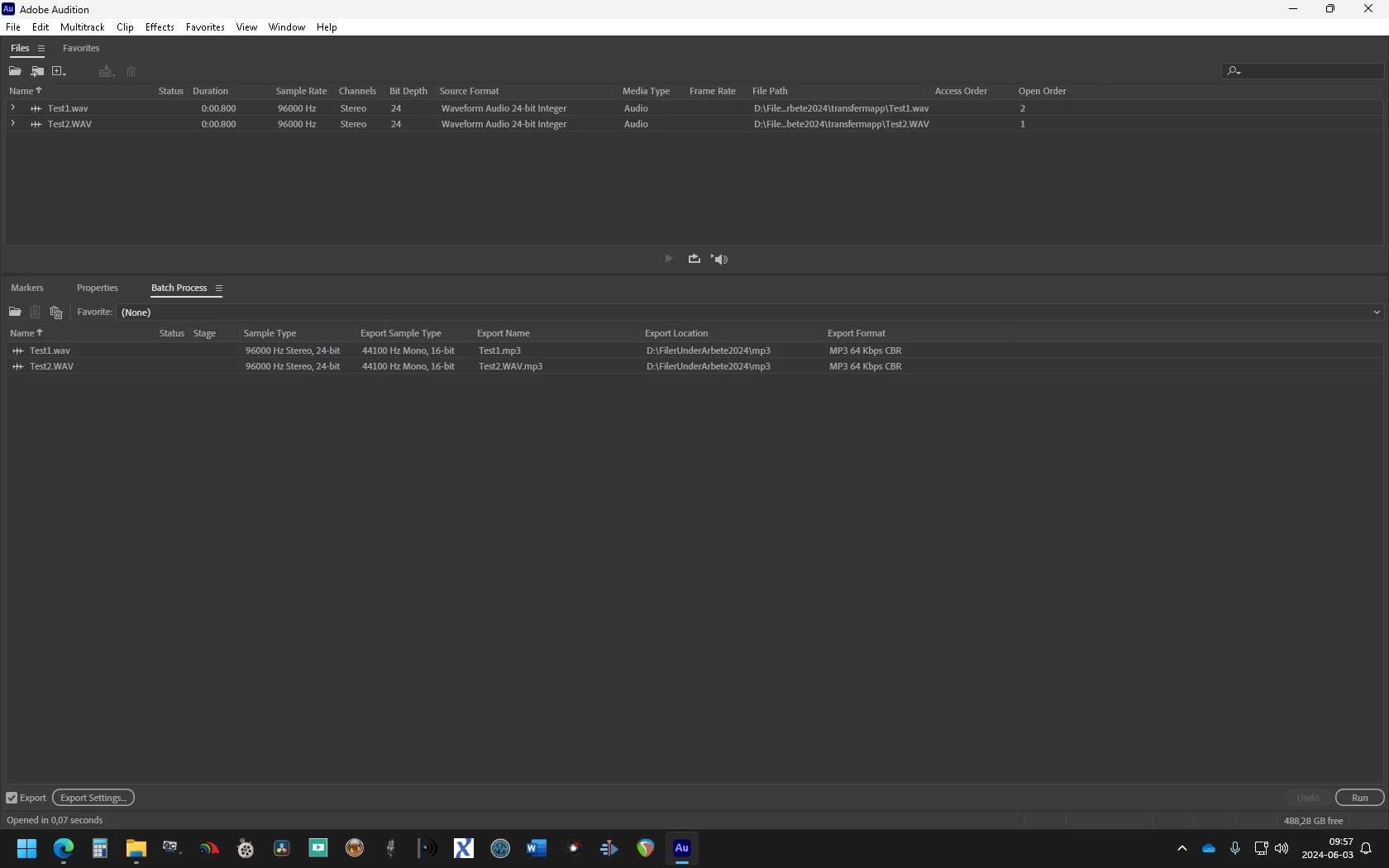

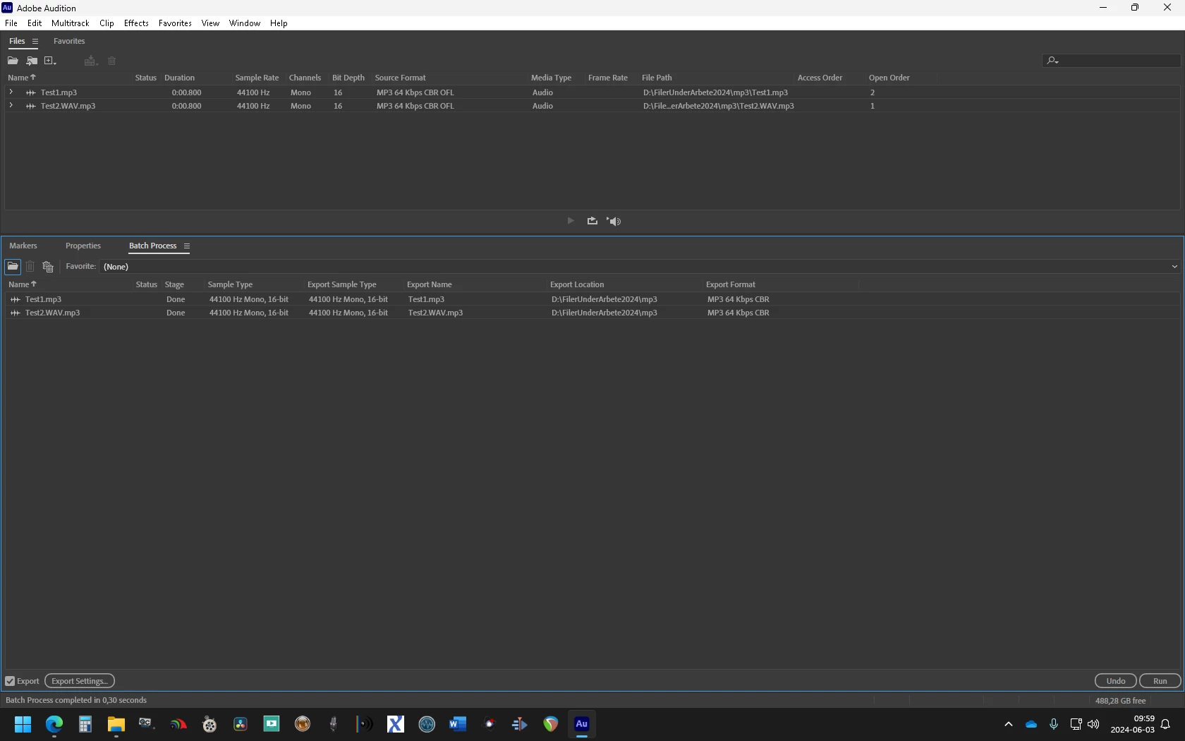

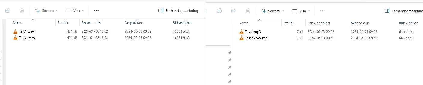

Jun 3, 2024 8:04 AM UTC
Before batch process:
After batch process:
In explorer view I always have Show file name extensions enabled.
I have the same problem on three different computers, with both Windows 10 and 11, and with several updates of Adobe Audition.
