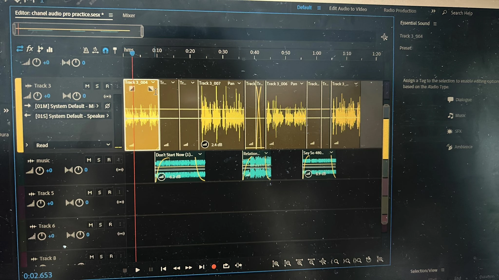

Exported file have no audio
when i try to export my audio as multi-track mixdown, i can't hear my own voiceover recording. My own voice over is removed entirely and i can only hear the soundbite audio. I tried the audio hardware mapping and the settings, but when i recorded and exported it again, i couldn't hear my own voice.For hardware settings, i set mine at IO buffer size 64 and sample rate 44100 With machine specific device defaults turned off

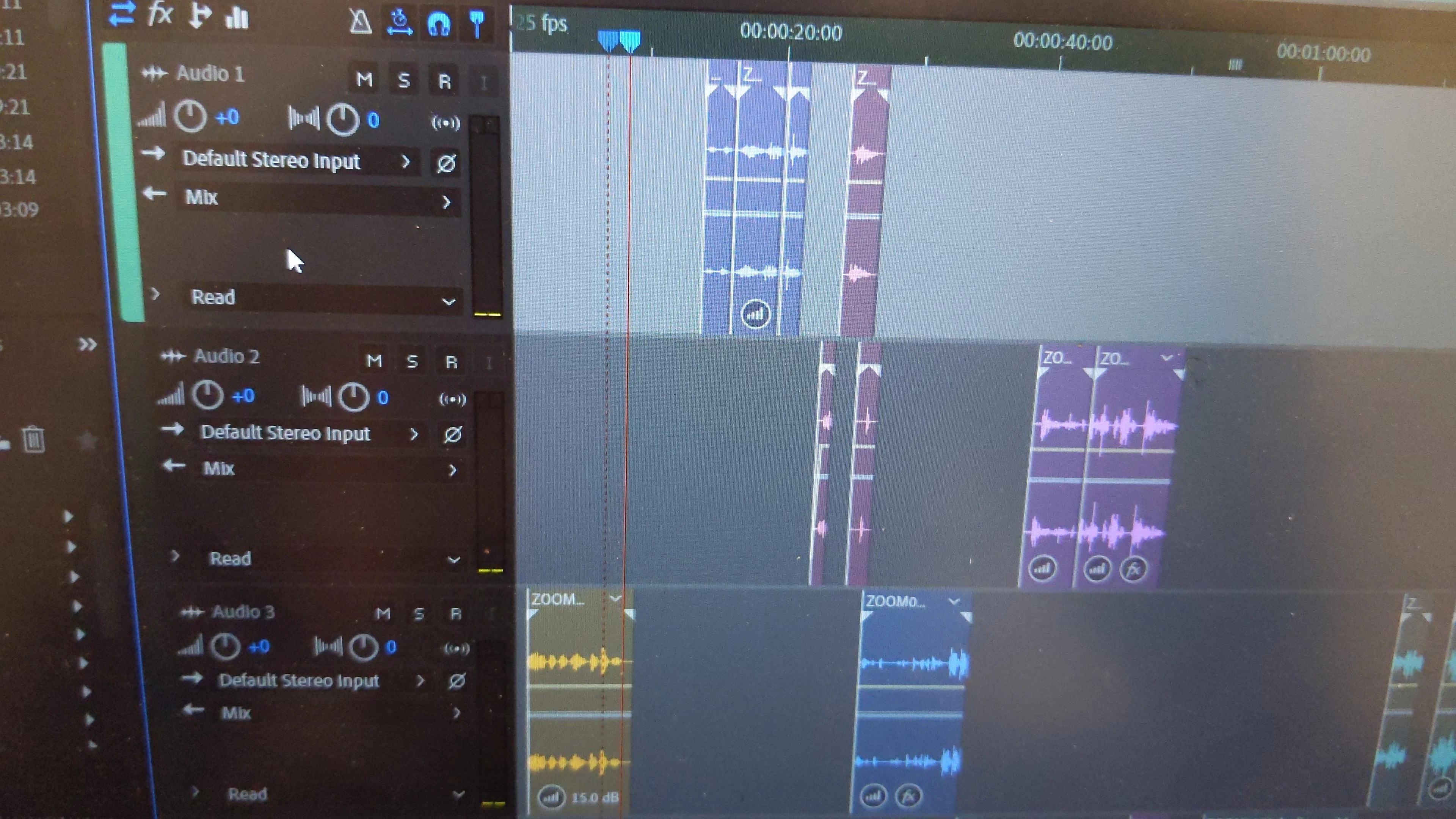

Haven't seen the mixer view, but I can tell what's wrong anyway - with the track you've got exposed, its output is being fed to your system speaker, rather than 'Mix' (or Master) - which is where it should be sent if you want it to be included. The idea is that you send all of your tracks to 'Mix', and only the Master output to your speakers.

May 20, 2023 8:18 PM UTC
Buffer size has nothing to do with exporting, although that does seem a little small, I must say. None of the hardware settings affect this either - it's purely a software function. Generally what you are experiencing is directly related to track and mixer settings in Multitrack view - screengrabs of your session and mixer settings, and all of the subscreens in the Export panel might give a bit of a clue...
