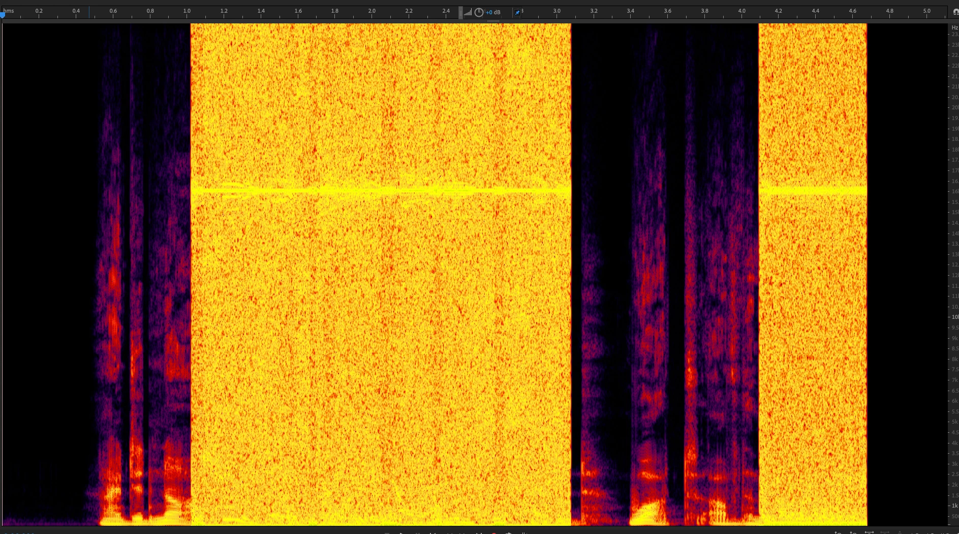

I've been having the exact same problem, except more prevalent, happens to 1-10% of files when batch processing. This has been a problem for the last few years and just assumed it was a problem they would fix eventually, but even on the most recent version of Audition it is happened, if not more now, than before. For reference, looks like below:
I have now changed the concurrent file processes to 2, but wanted to ask about the advice on setting audition temp files to a "non-shared space", where do I find the temp files, and are you suggesting I need to purchase a whole other external SSD just for adobe audition temp files?
