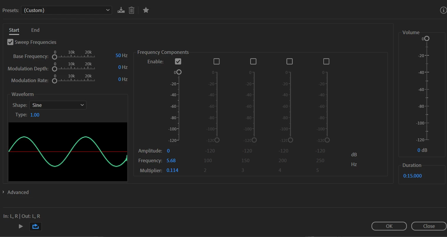

    This is my settings. Please check this one.
    SteveG_AudioMasters_
    Apr 28, 2026 9:17 AM UTC

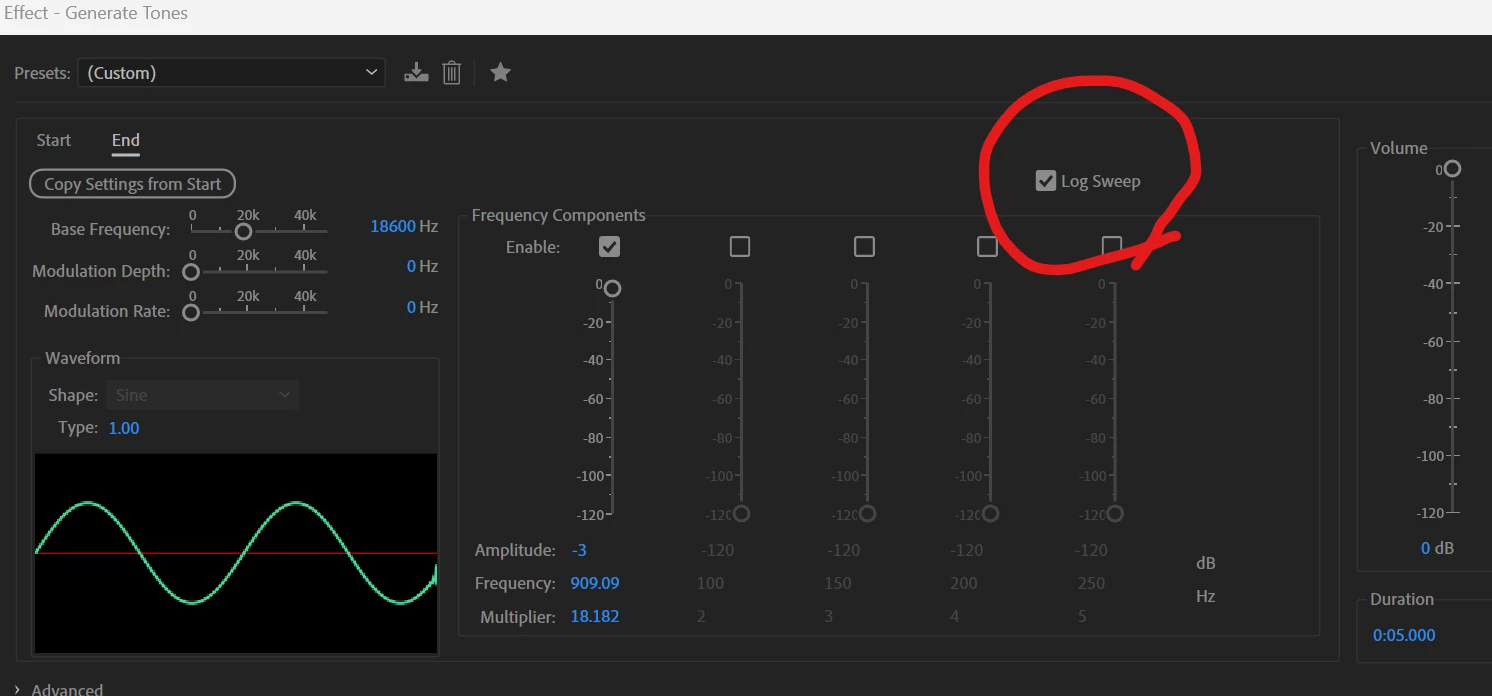

    When you generate a sweep, the Frequency and Multiplier values are important, and will cause errors if set incorrectly. Importantly, the Multitplier value should remain at 1. At this point the Frequency value will be the same as the Base Frequency you have set. At the end of the sweep, if you copy the values from the start settings, all you will need to alter is the End Base Frequency, which should be transferred to the Frequency box in the Components selection at your final value (if it isn’t, then change it manually so that it is). The multiplier value remains at 1. If you set a duration, and do all of this, your sweep will be fine.
    The important step in this is to make sure that the multiplier value at both ends is 1. Not doing this will cause all sorts of strange things to happen.

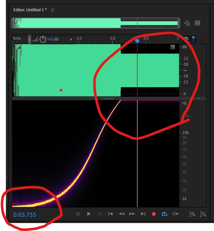

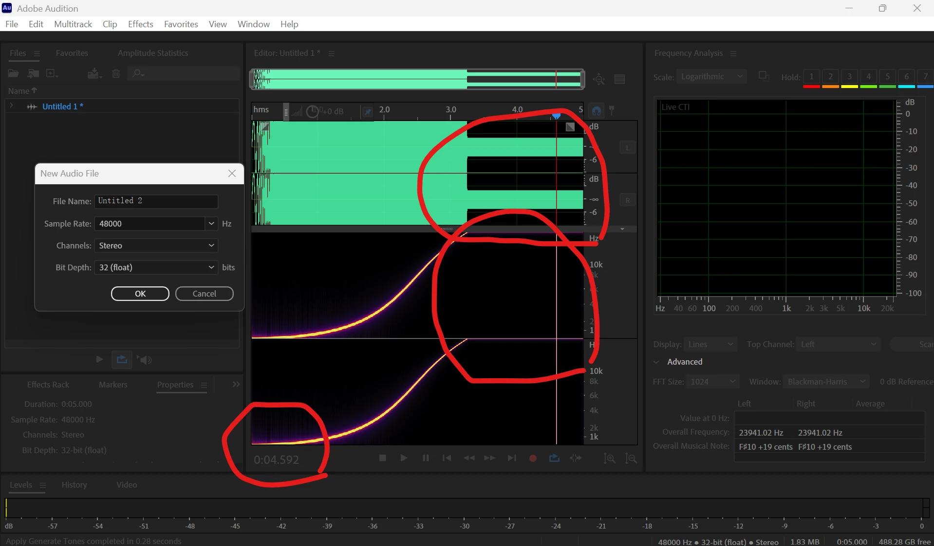

    So strange. I can’t get those signals. Still the signal showed like this.

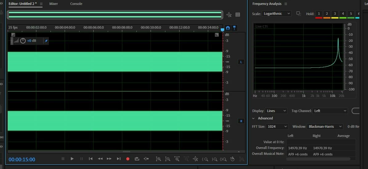

    Okay, tried it with a log sweep - it makes no difference:
    Starts at 50Hz, ends at 15kHz. And I tried it at different sample rates and levels as well. Works fine with all of them, and in mono. So, how are you setting this up?

    Please check this and then run again.

    This is problem that I can meet in my pc. 0dBFS is going down -9dBFS out of bandwidth.
