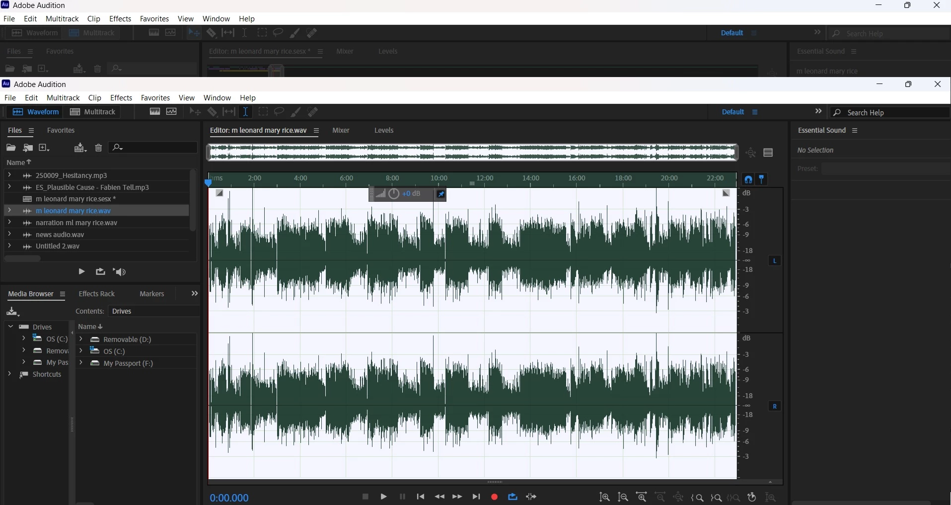

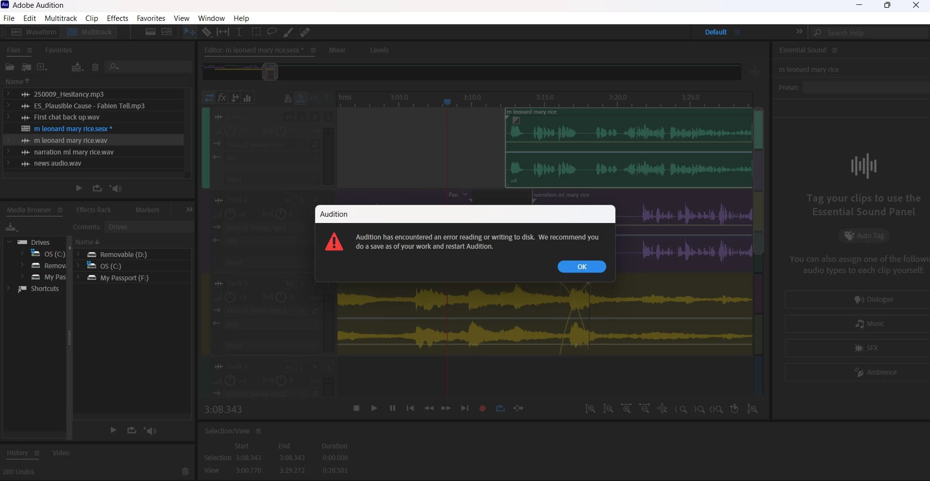

I have been continusely getting this same error message and now I have lost over 20 mins of recorded audio. The file visually appears to be there but the audio has gone! I did not save over the audio I simply closed the program and re started when I open it up and try and play the file there is nothing. An entire days work is now gone.

I don't know what to say other than the file is there yes but when I bring it over to Audition theres nothing on it, its blank. This has happened before. In other files though when this warning has come up and I have closed the program when I re open the file some of the recording is there and some isnt.

If you saved the audio, then it is almost certainly there. Since the message has occured while you are in Multitrack mode, and everything else is okay, then it may well be the session file that has failed to write correctly. It may just be a case of locating the original audio and putting it back into the session - although if you do that and find it, the safest thing to do is to save the whole thing as a new session file as well.

Hi Steve, I wasn't recording in multitrack I was putting together an episode of my podcast. The error messge came up while I was adjusting some clips in the multitrack session. I did save at the end of my recording, the audio was saved and located on my external hard drive, this is again why I dont undrestand why the audio is gone, I did not save over anything at all. When that warning came up I did as it saud and just saved what I had done during the multitrack session and then closed. When I re opened everyhting audio wise was fine exept this one file where it was just gone.
