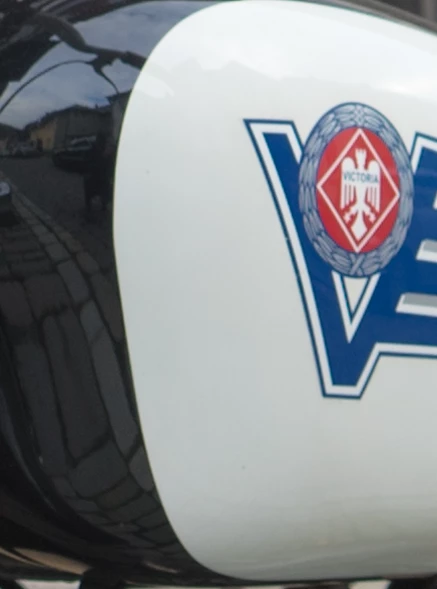

I noticed some unpleasent artifacs on hard edges in many of my raws captured with Sony. They seem to appear as soon as the clarity value is raised.
Here is an example:

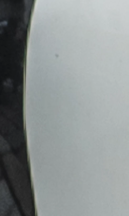

And enlarged:
When leaving the clarity at 0 there are no artifacts visible:
The raws were captured with a Sony A7II camera (uncompressed). I do not know if these artifacts only occur with Sony raws or also with raws of other manufacturers.
Note: I already posted about this issue here https://forums.adobe.com/thread/20652...

You are correct. The RawDigger TIFF shows the same aliasing with Remove CA checked or unchecked, so strictly an aliasing issue.
ssprengel
January 15, 2016
If you look at the bottom of the Lens Corrections Profile area, you'll see that there is a built-in, always-on lens profile being applied that specifically removes CA in Adobe's rendering.
And if you zoom in on the gas tank edge in RawDigger you can see there are alternating columns of red and blue pixels that Clarity (and other adjustments with similar effect) accentuate the differences between.
It looks like the camera doesn't have an anti-aliasing optical filter and maybe Adobe's toning algorithms need to be tuned to not accentuate differences that are quite so small and not pick up the difference in red and blue pixels. It could also be that the toning algorithms aren't using the right red, green, blue weights for computing luminance map of the image their toning adjustments are manipulating.
