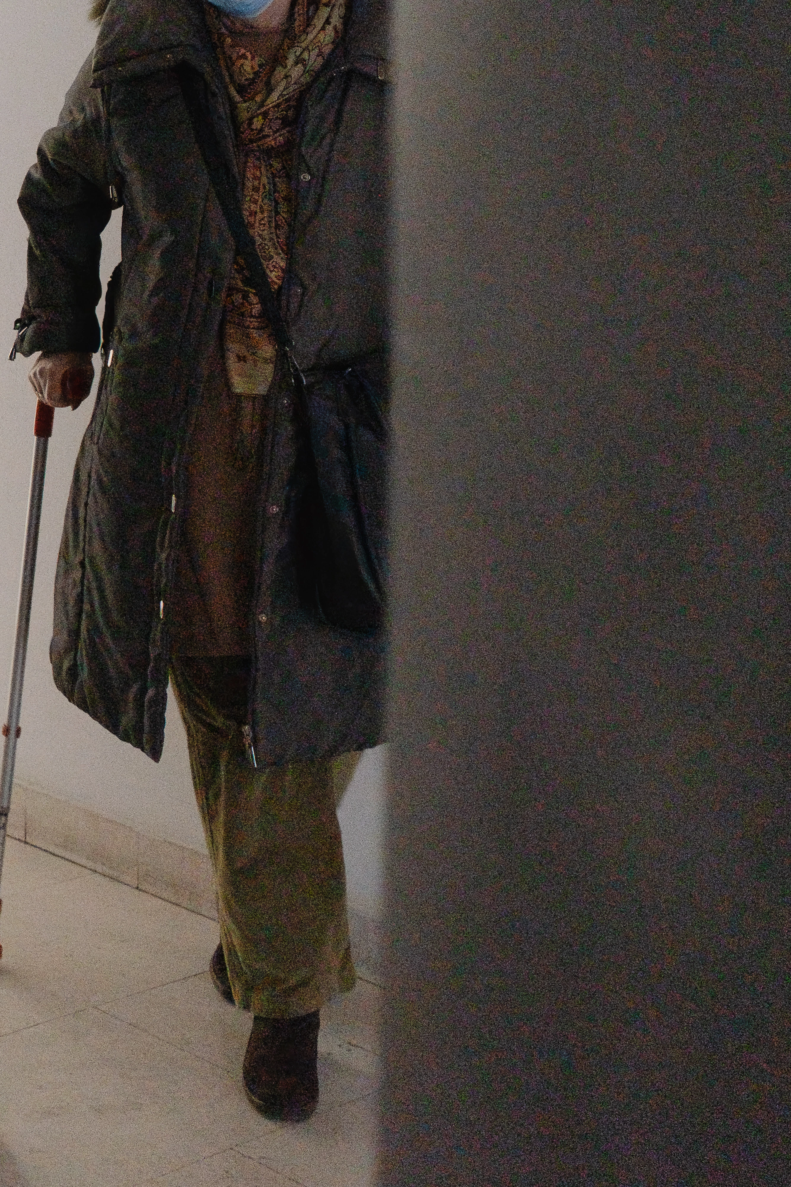

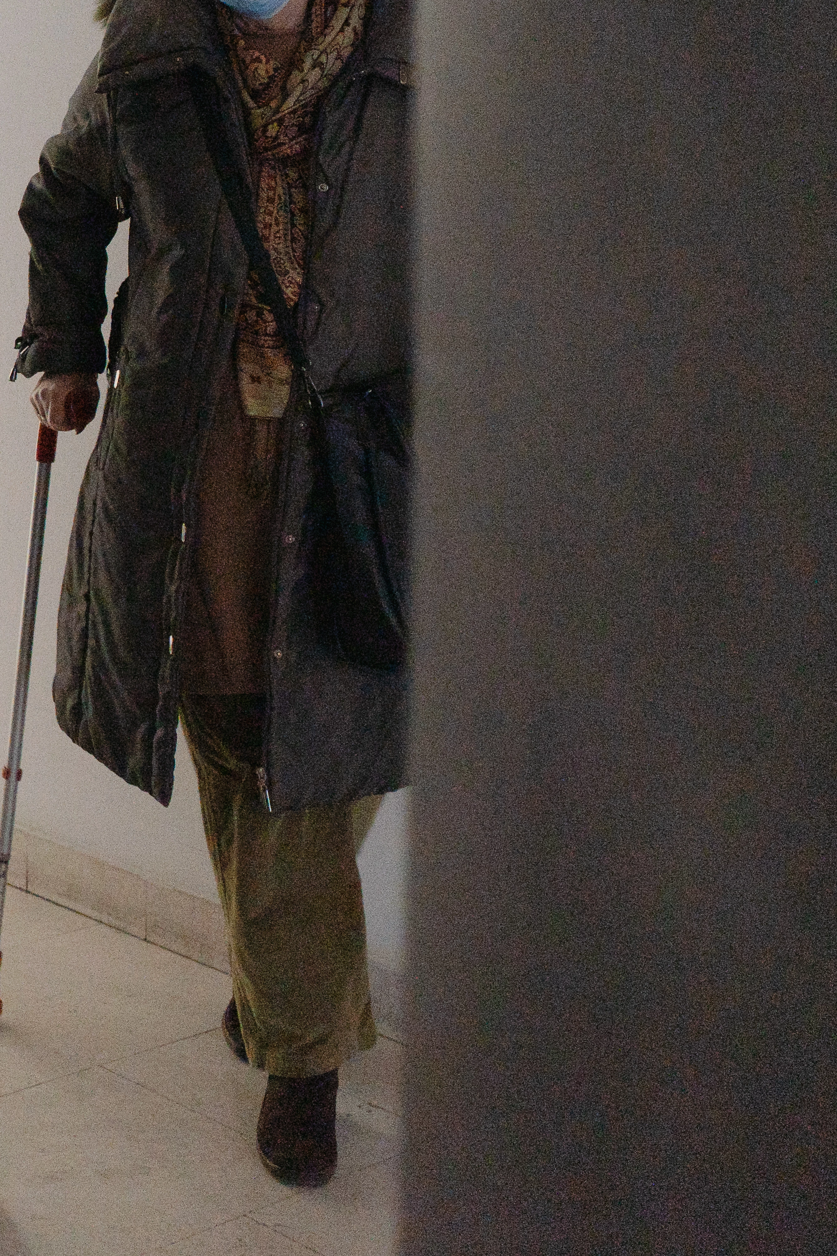

Jan 2, 2024 3:26 PM UTC
Issue:  Ricoh GR3 raw files rated as compatible. After applying denoise to the file not much changes no matter of the scale of applied denoise 0-100.
Lightroom Classic version: 13.1
OS and version: macOS 14.12
Expected result: Lightroom Classic should do denoise reduction comparable to files from other cameras.
Actual result: Lightroom Classic does not apply denoise properly.
 Uploaded  Test files.
