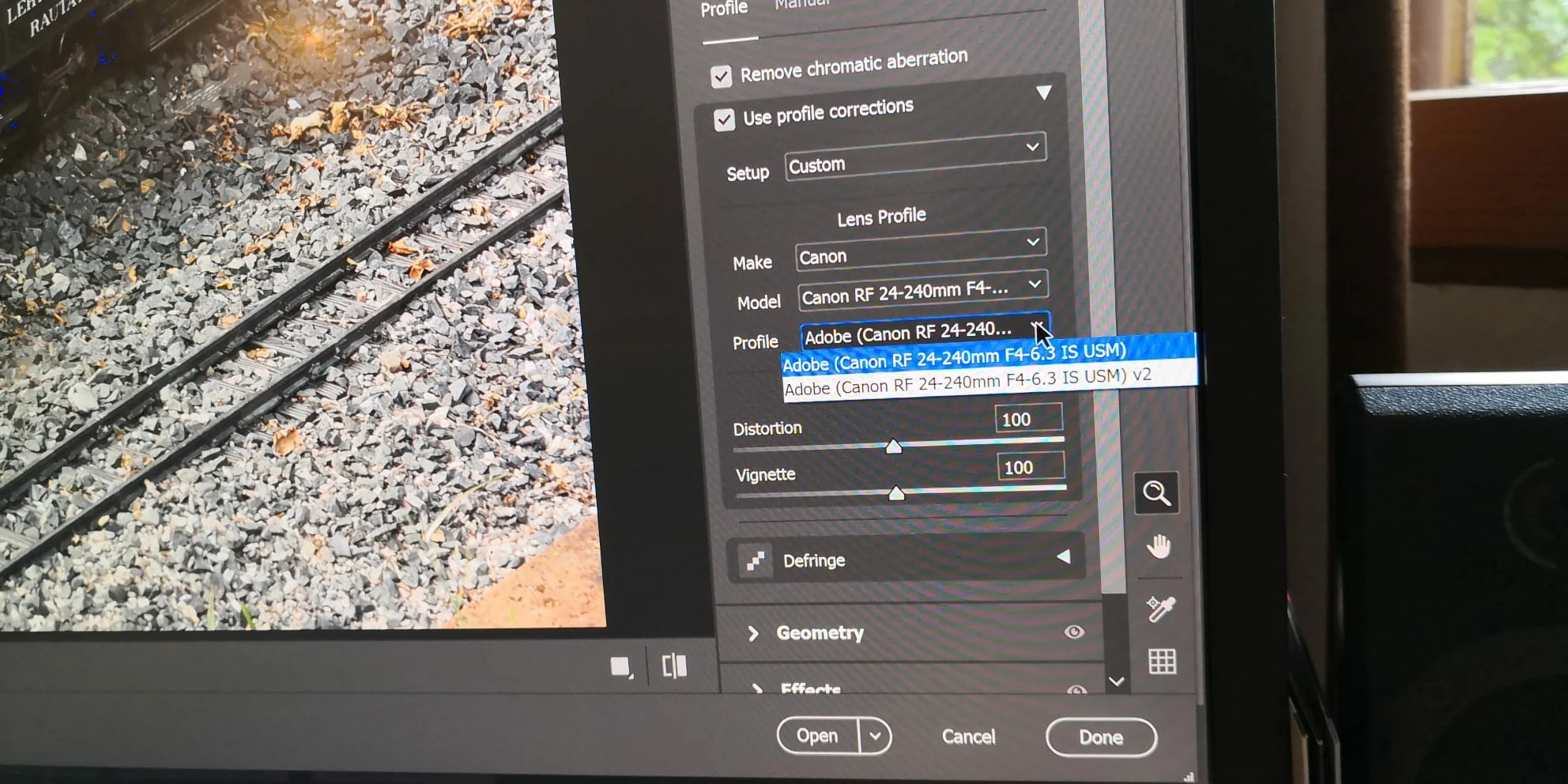

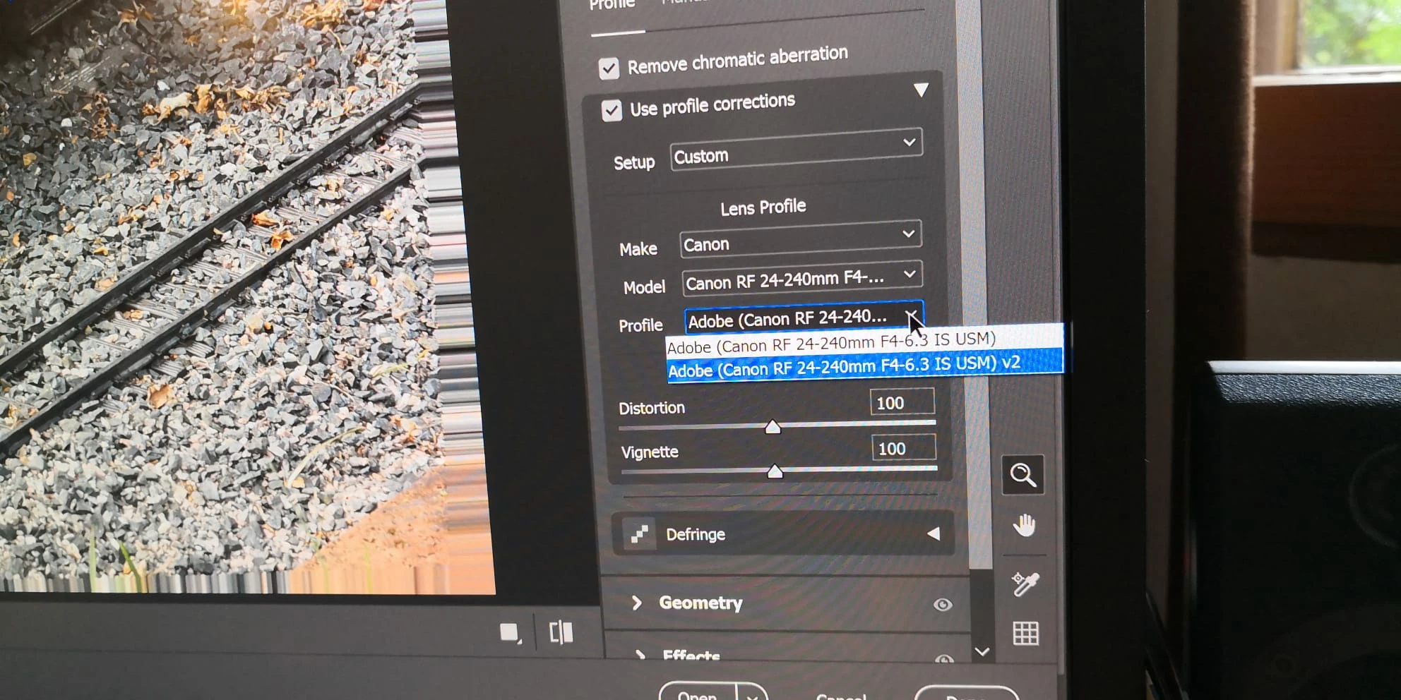

Aug 25, 2021 3:40 PM UTC
After latest Adobe updates Canon RF 24-240mm f4-6.3 IS USM lens profile works wrong.
There is in Camera Raw now two profiles for this lens and profile "Canon RF 24-240mm f4-6.3 IS USM v2" brings
pictures outer bordes some distortion. Profile whithout v2 works fine. It seem to be so that v2 is default profile and it affects also in Bridge.
Is there coming fix for this problem or can profile whihout v2 install to a default or remove v2-ending?
I am using Canon RP body with latest firmware.
Brg Aki

Aug 25, 2021 7:49 PM UTC
Not sure I fully understand. You have two profiles, one works fine, the other doesn't right?
So what is the issue using the one you feel works 'right'?
Is it possible there are two 'flavors' of this lens and one needs to use one or the other profile?

Aug 25, 2021 9:59 PM UTC
I have had earlier no reason to change lens profiles. Now that v2-version is default profile and it´s wery irritating open picture on Bridge when it use that wrong profile. Ofcourse i can change it on Camera Raw but profile shoud not be working like this. I have laptop and a desktop computers and both start working same way today. I am sure that this is driver problen on software itself.
It would had been nice to know from where that v2-ending came from!
I will wait fixing software update. And if you have any fixing ideas i am very please to hear it.
I will attach two pictures from that issue.

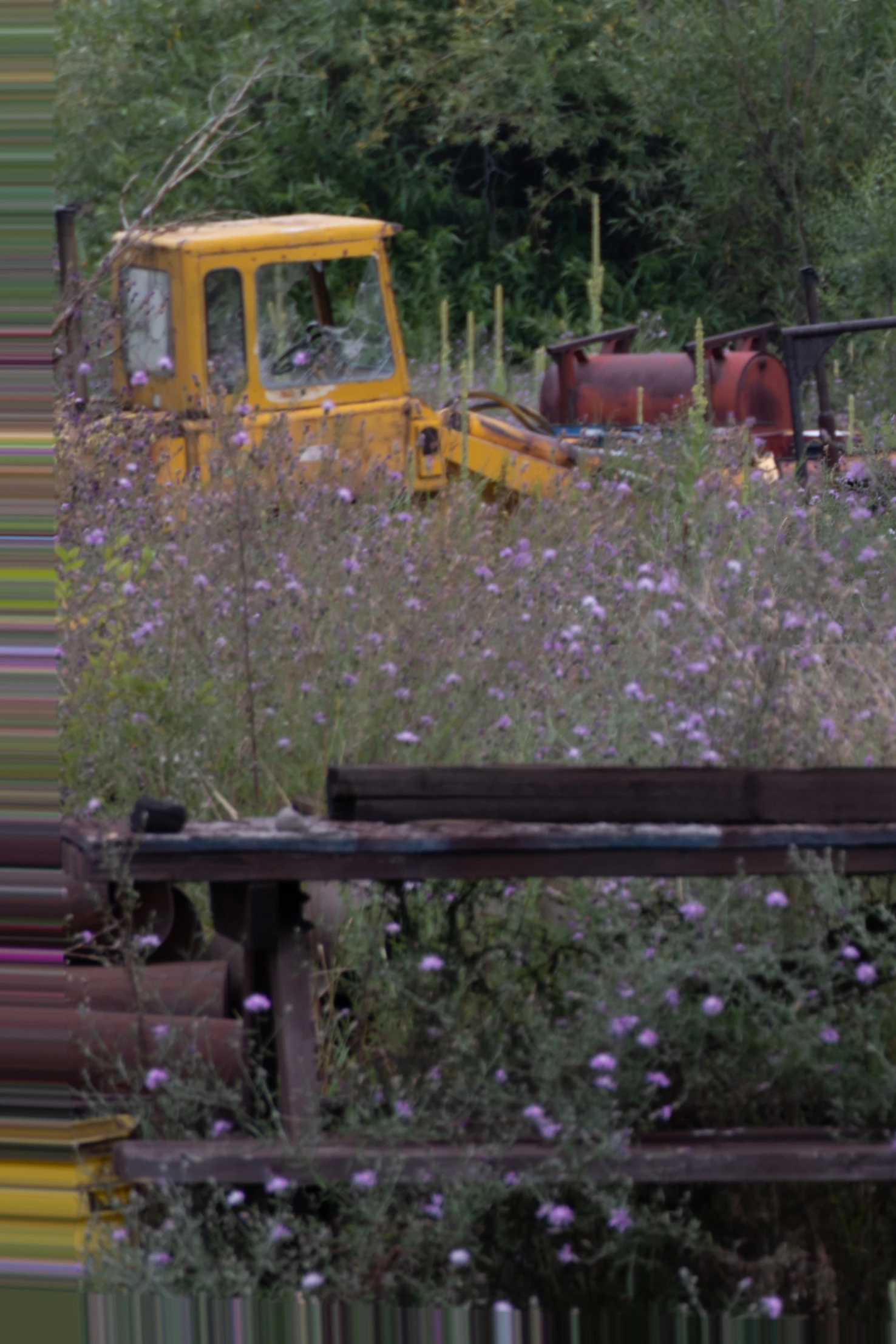

Aug 19, 2021 1:51 AM UTC
I am using the most recent updated versions of LR ( ver. 10.4) and PS (ver 22.5.0).  Yesterday's update has caused some weird artifacts on the edges of all my photos.
System is MacOs version Big Sur 11.5
Macbook Pro 2019 16"
Camera: Cannon EOS R6
I have uploaded photos to Affinity and Digital Photo Pro 4 and the artifacts don't appear.   They appear in both PS and LR and are present on all my lenses and throughout the range of each lens.  Rarely seen in the sky portion of the photo but always seen in the bottom and both sides.   Attached is a cropped version of the left and bottom side of a photo.  Oddly enough, it does not happen if I shoot JPEG, just RAW files.  I am now having to crop a considerable bit off the sides and bottom of all my photos.
Has anyone else seen this problem?

Here is the crop of one of the photos.  Hopefully you can see the lines on the bottom and left side.  I have eliminated corrupt files and corrupt SD cards.  I will not go through the steps I took but you will just have to trust me that the problem is with Adobe.   I went back and uploaded some files that I took pre-update and they are now showing the lines too.  Went back and looked at all my settings and found that if I uncheck "enable profile corrections" it will remove the lines but crops the photo.  If the photo doesn't have lines (seems to be alright at 24 mm focal length) and I uncheck the box, it leaves a really horrible vignette on all corners.  I appreciate your thinking it may be a hardware problem but I am really doubtful as I have had no problem prior to the latest update.  I have and use two different SD cards and that makes no difference.  Thanking you all for trying to help.  It is certainly a frustrating problem.
