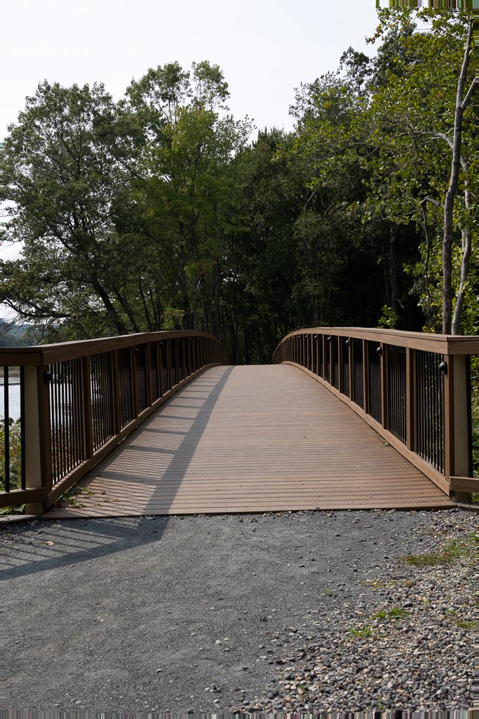

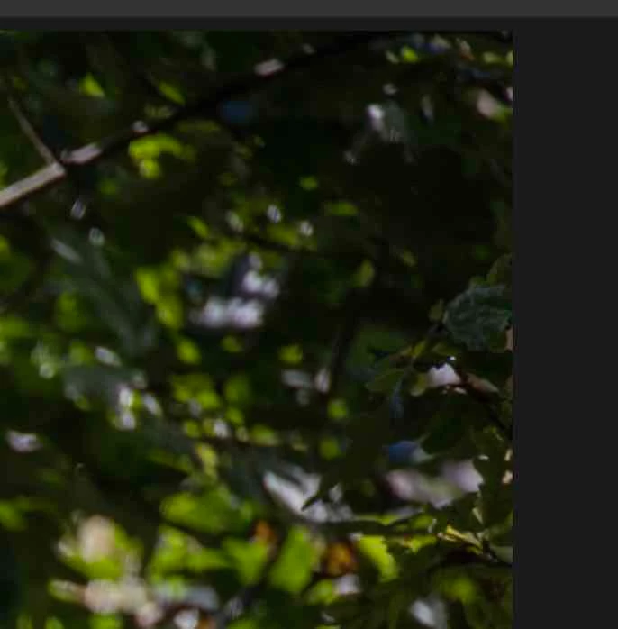

First time post so I hope I am doing this correctly. I am running the latest version of Lr Classic and have a Canon R6 with firmware 1.3.1.  As of 9/15/2021 I started to get a weird border around a lot of my photos.  Please see attached photo.
It appears to be similar to an issue that was reported back in 2017 when Canon introduced the GX camera and it turned out it was an Adobe problem.  Could this be a similar issue? Any thoughts on the best way to proceed? - down rev LR to the previous version?  The issue does not seem to show up in Canon DPP.
Thanks.

Adobe has acknowledged this bug with the v2 version of certain lens profiles. The workaround is to change to the v1 lens profile in the Lens Correction panel. See the bug report for details:
https://community.adobe.com/t5/camera-raw-bugs/p-lens-correction-profile-for-canon-rf24-240-exhibits-edge-artifacts/idi-p/12342389

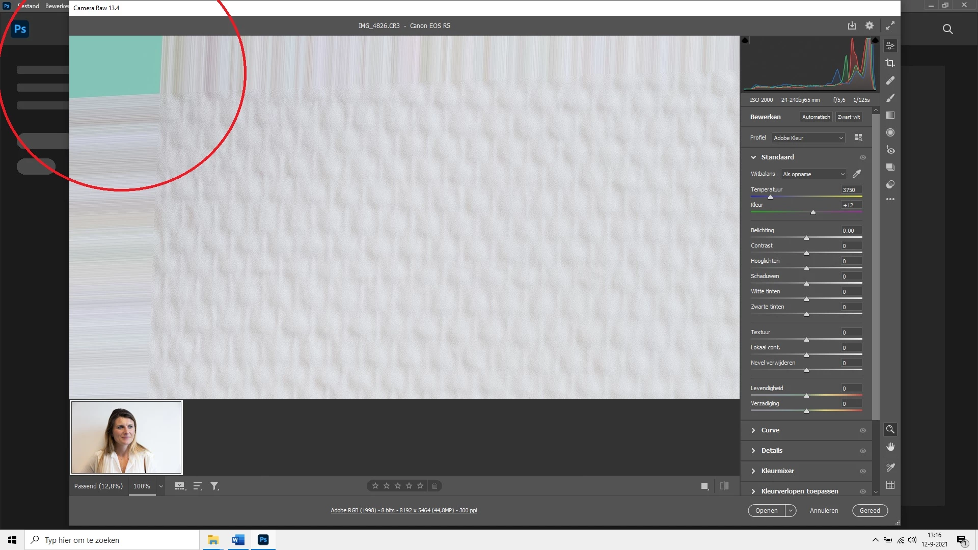

I have an Adobe creative account en probably have found a bug (Updates are up to date).
When I make a photo (canon eos R5) and view it with  e.q. faststone, there are no problems (so the camera/sensor is ok). But when I open the photo in Photoshop (RAW converter) is see al lot of lines at the edges op the photo. I have an example included! There is no way of get rid of this, only by cropping. I guess it is a bug, can you find out and help me?
Thanks in advance,
Jan Willem Hage

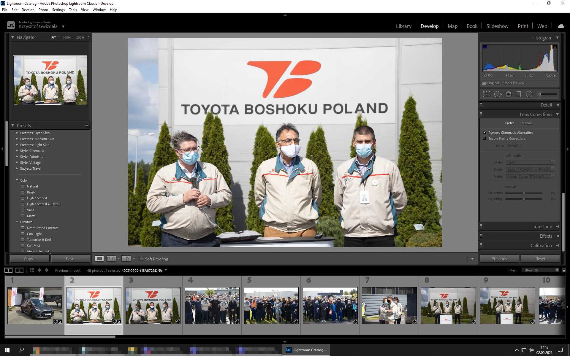

Sep 6, 2021 3:42 PM UTC
Same behaviorn happened to me yesterday: Apple MacBook Pro M1, Lightroom Classis 10.4, Canon R6. During import LR applies provile v2 and the problem apperas, I changed to "no profile version", synced on all images and everything is ok

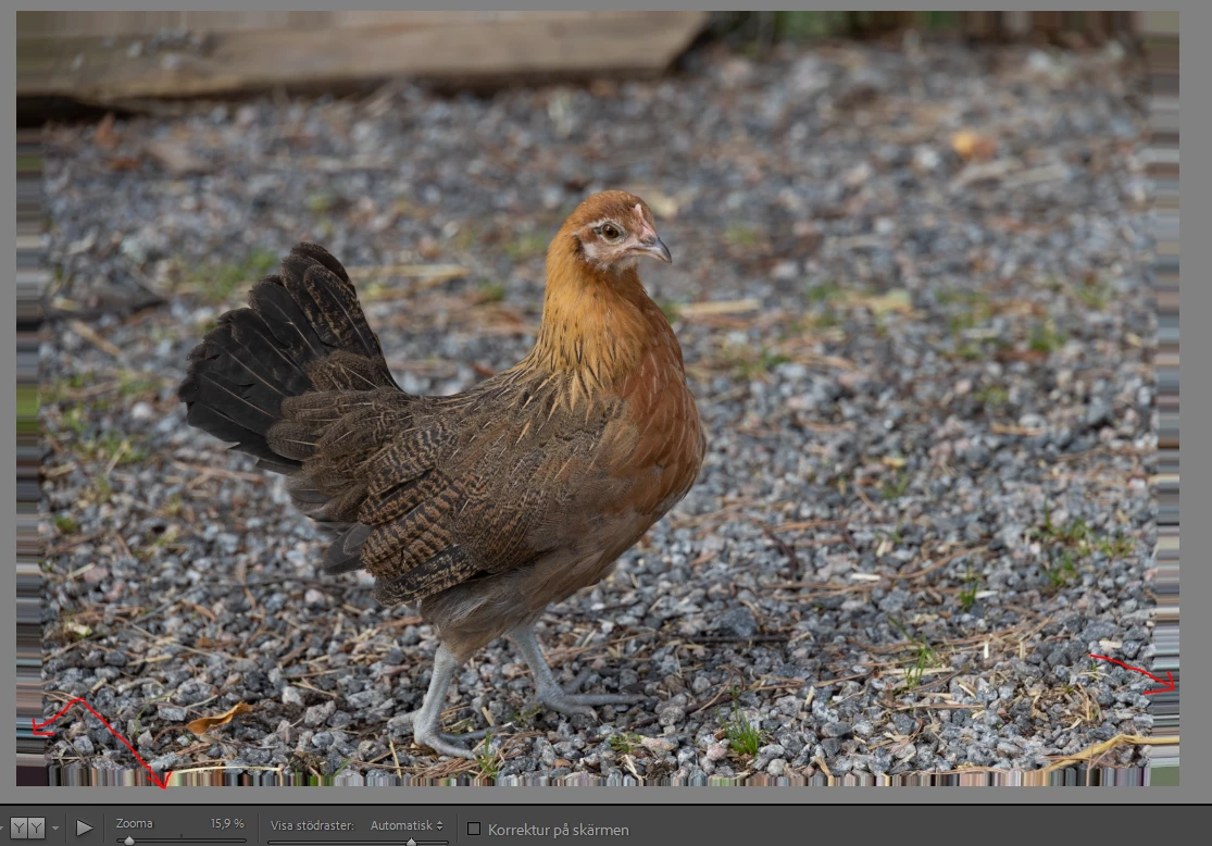

In RAW photos from Canon 24-200 (with EOS R) you can see artifacts around (when the lens profile is turned on). When the profile is not enabled, the artifacts are gone.
