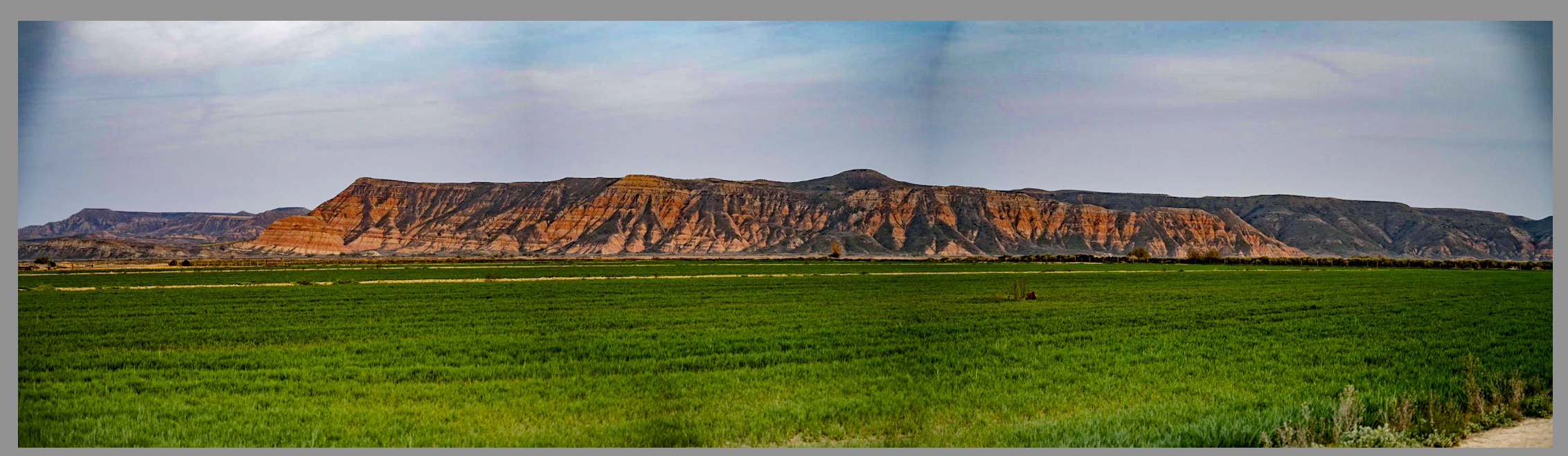

After importing and without profile corrections enabled, you can clearly see vignetting just by looking at the image. It becomes even more striking when combining the four pictures shown to a panorama and applying, just for the sake of demonstration, some (exaggerated) dehazing and histogram stretching:
This of course is not pretty and is meant to be only a demonstration. It looks to me like the dark parts are results of vignetting when stitching together the panorama.

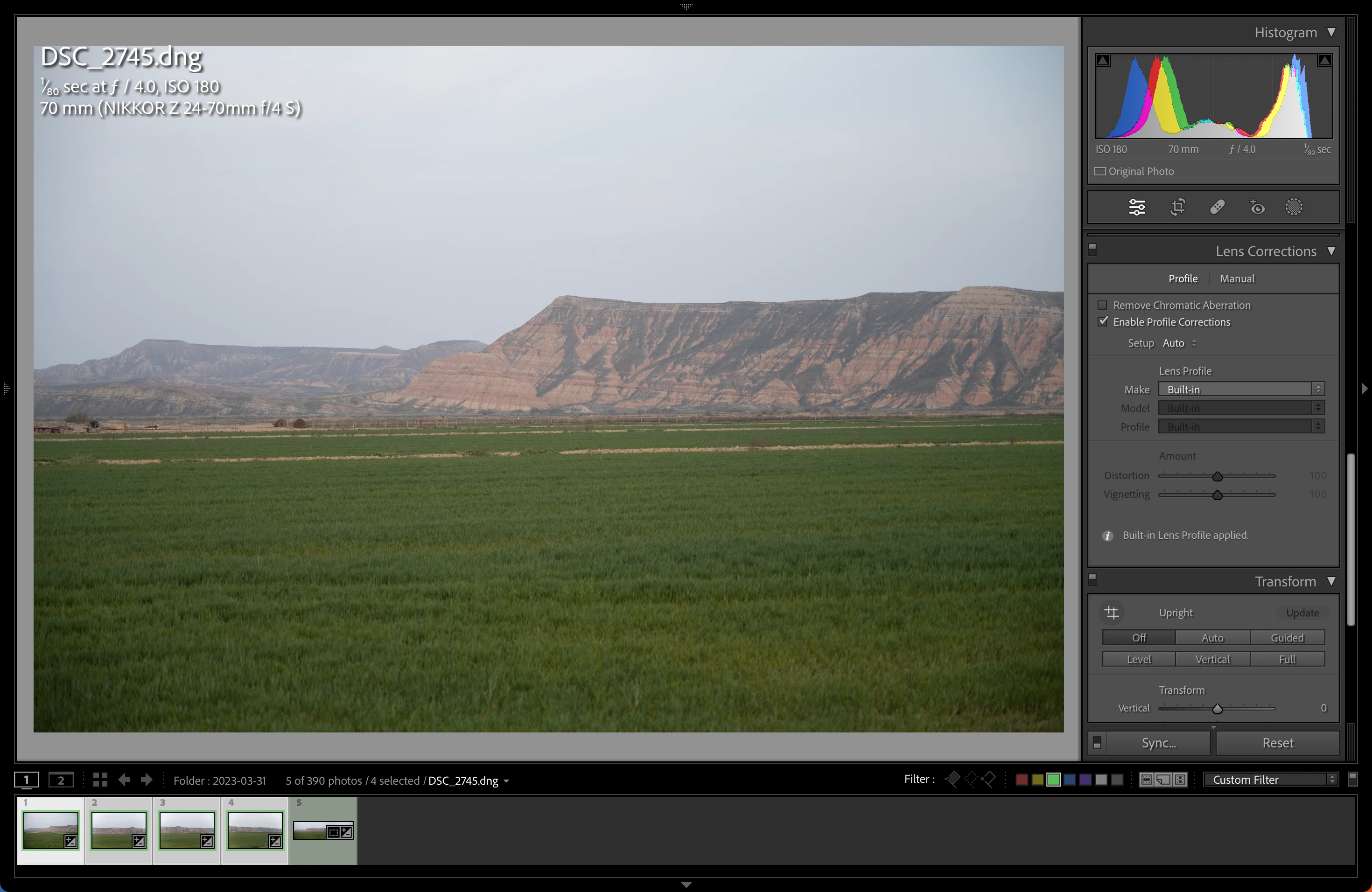

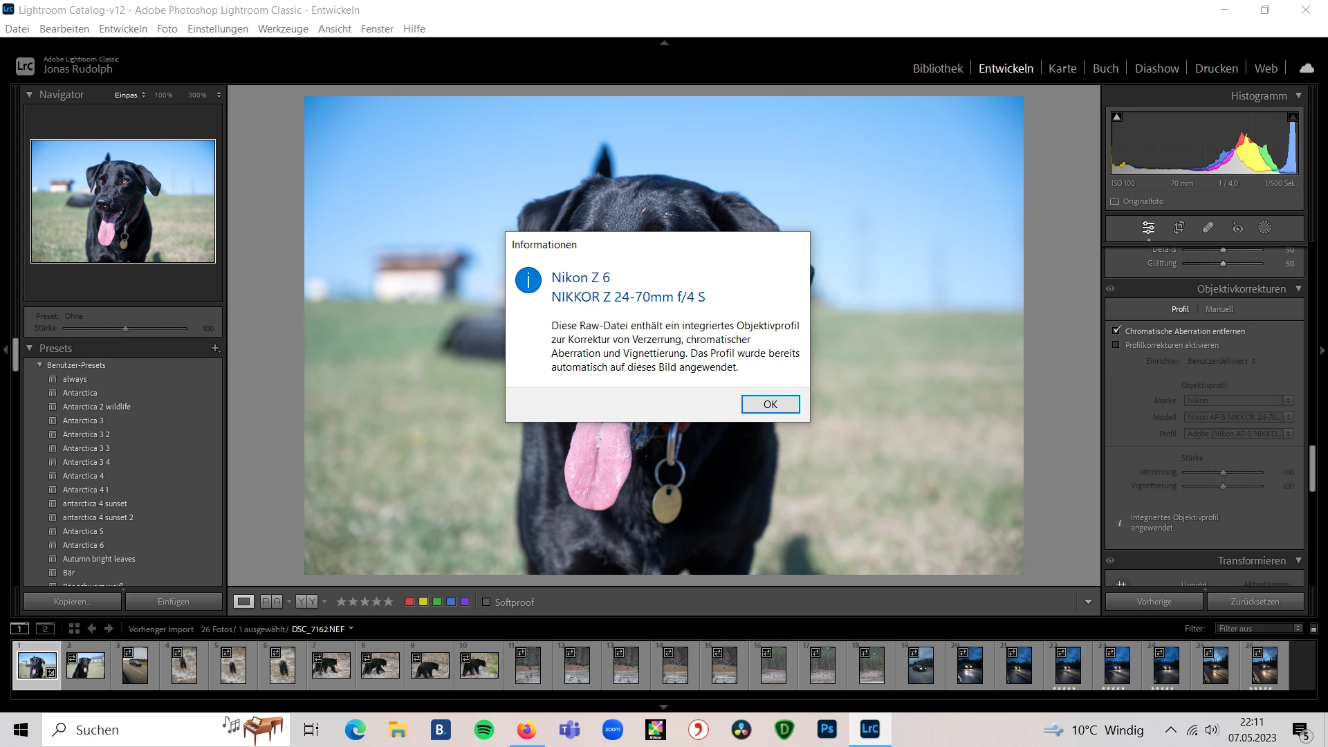

When I apply "auto" profile corrections, it will again use the "built-in" lens profile, which is equal to unticking the box:
(this is something else I don't understand with Lightroom, why is no way to remove the built-in, even when lens profile corrections are unticked? But this is a side question)
This results in the exact same panorama (I synced all edits to make sure the images are comparable).

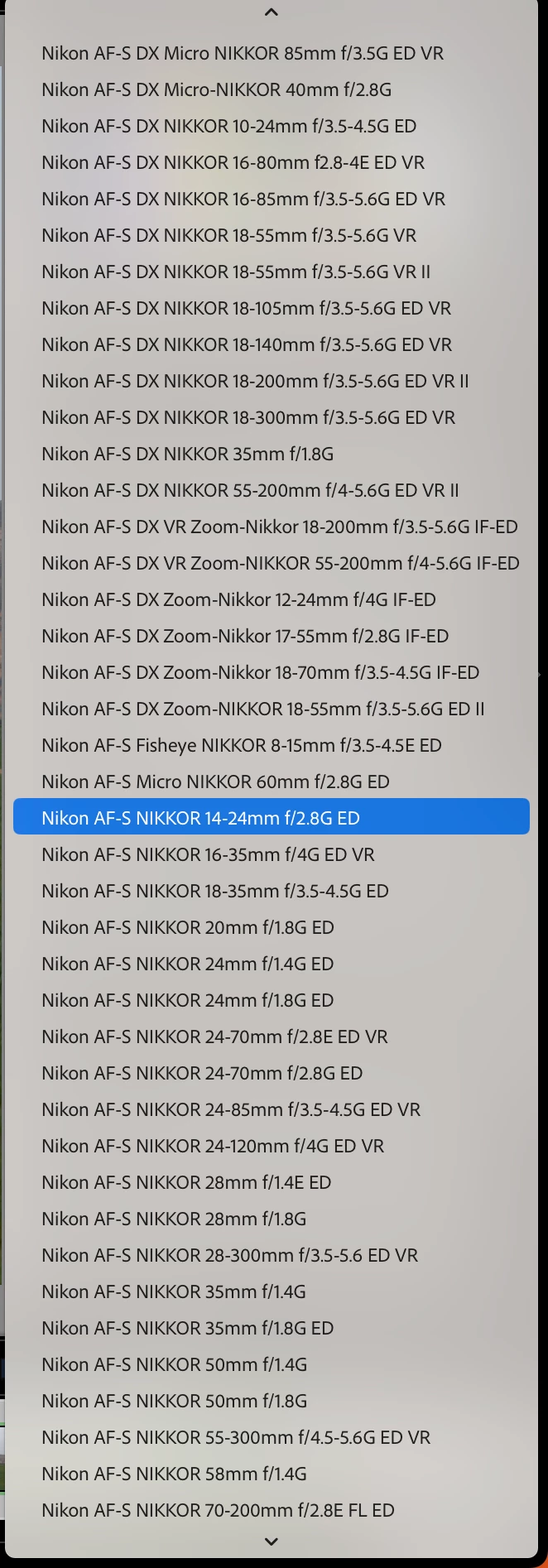

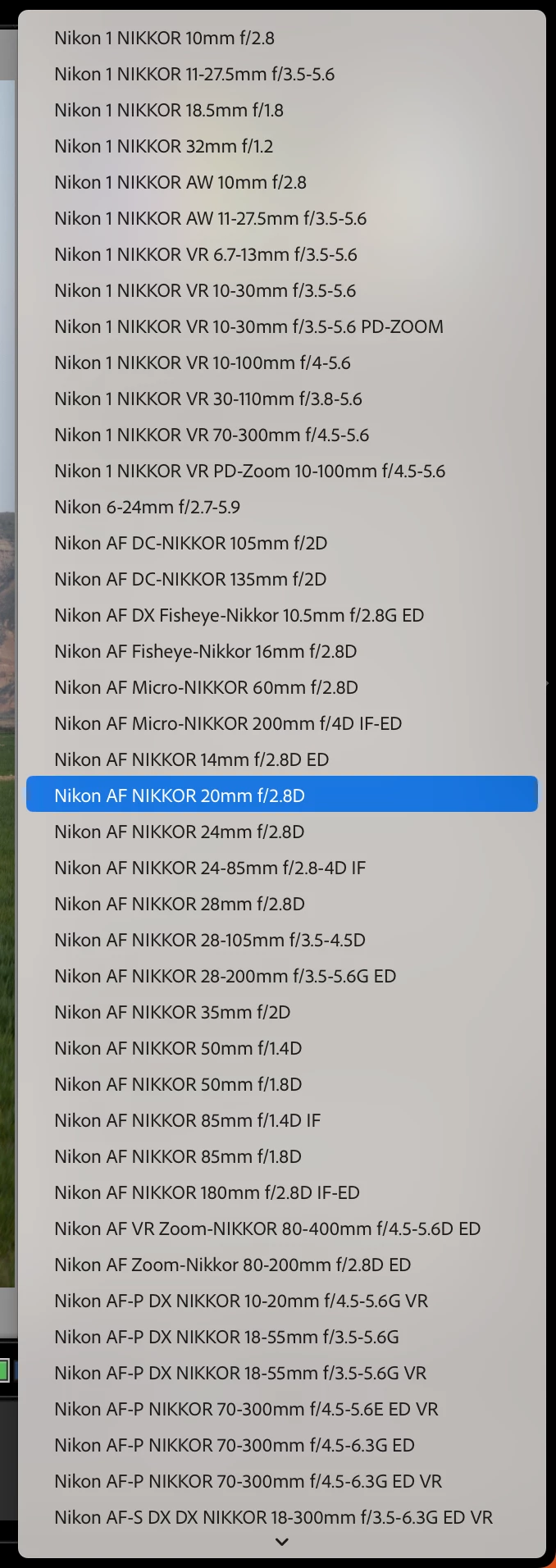

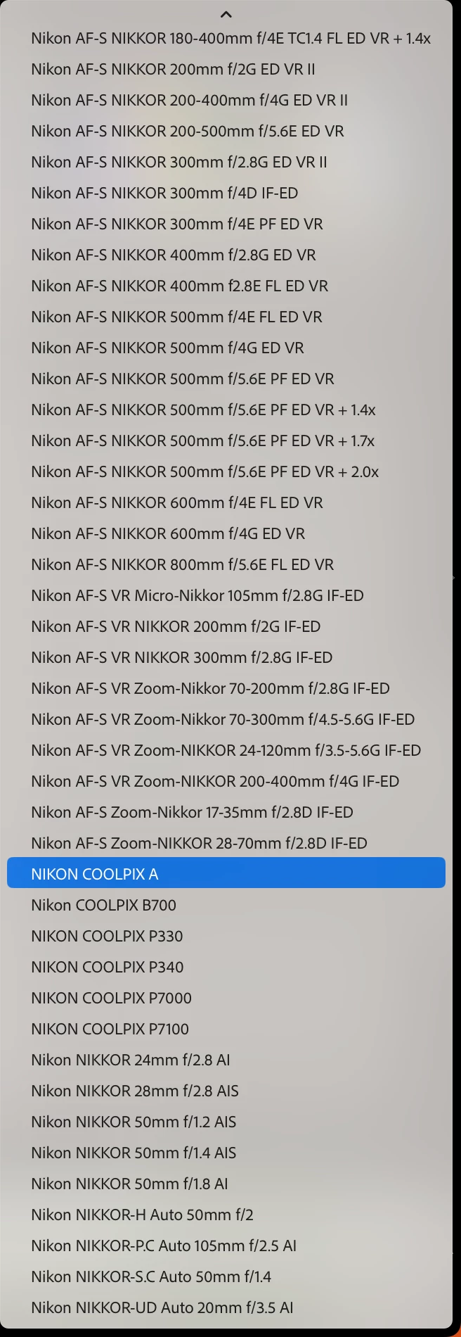

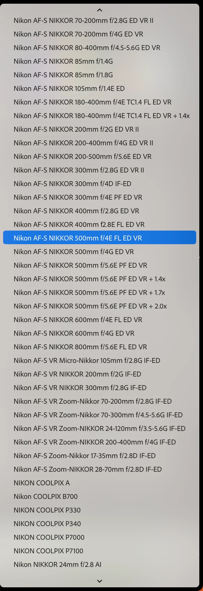

I looked at manually finding my lens but it does not appear to be there (in fact, I see no Z lenses in my dropdown at all):   
Now, I can try to manually remove the vignetting by doing something like this:
  1. Select a "more or less similar" lens from the available models in the dropdowns shown above, such as the "Nikon AF-S NIKKOR 24-70mm f/2.8E ED-VR" and apply some manual adjustments to make the vignetting in one image appear to disappear (by looking at it only)
  2. Sync the edits to all photos which will go into the panorama
  3. Generate a panorama merge preview (with auto settings to stretch the contrasts) to see if the vignetting seems about gone.
  4. Repeat steps 1-3 until the outcome of step 3 seems satisfying
You can imagine that somebody with a camera which aims to be "for perfectionists" (from Nikon's website) will not be happy with such a process and the outcome is not optimal by any means.

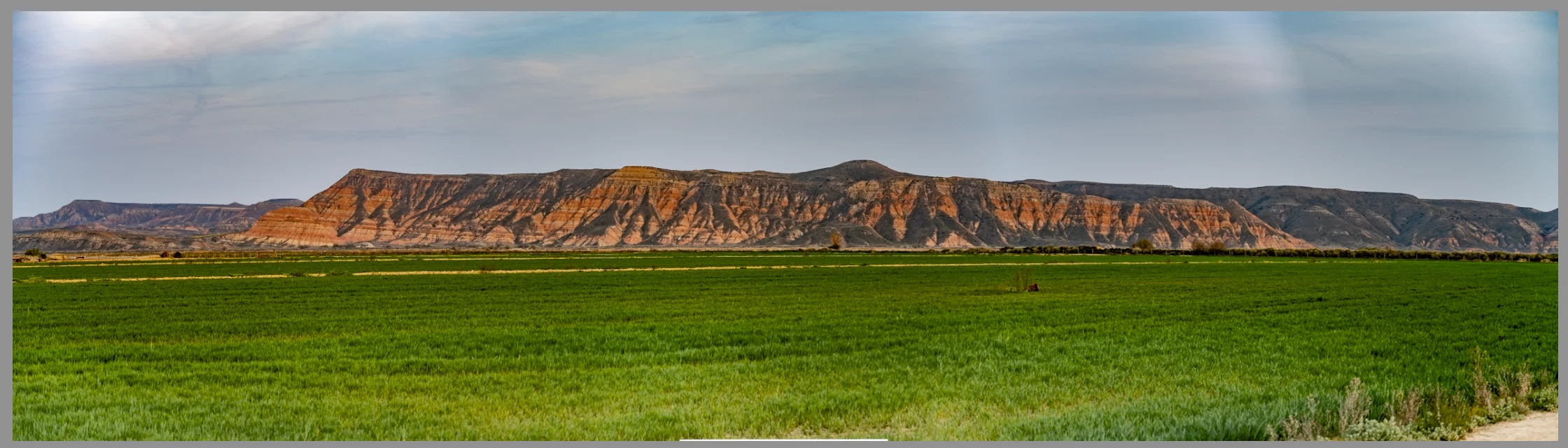

This is about the best I could get using the method above, it still looks like some dull water-damaged print.
I would really hope that Adobe collaborates with Nikon to address this issue.

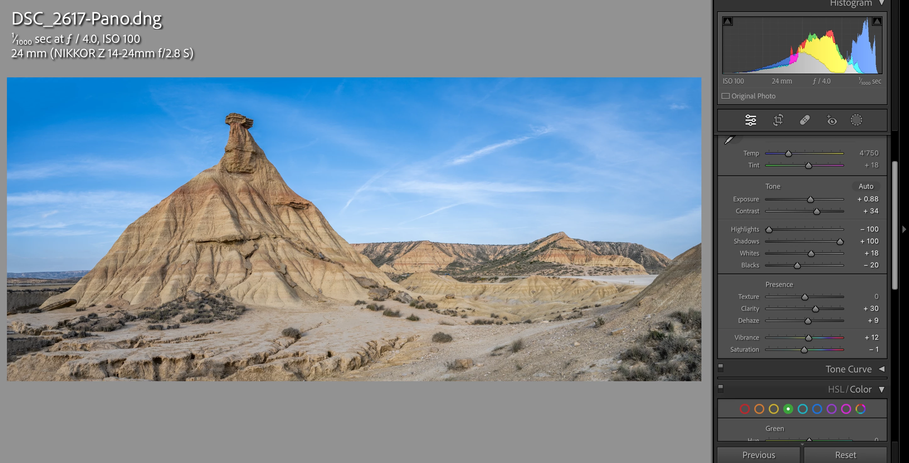

In the remaining steps, I want to demonstrate that the same steps would produce satisfying outcomes if done based on images taken with another lens for which there is a correctly functioning lens profile, such as the NIKKOR Z 14-24mm f/2.8 which I also own.
First of all: there seems to be a lens profile (see right bar) corresponding to my exact lens.
If I merge the three pictures and apply aggressive contrast enhancement, I can see no signs of the lens profile not being applied to the original images.

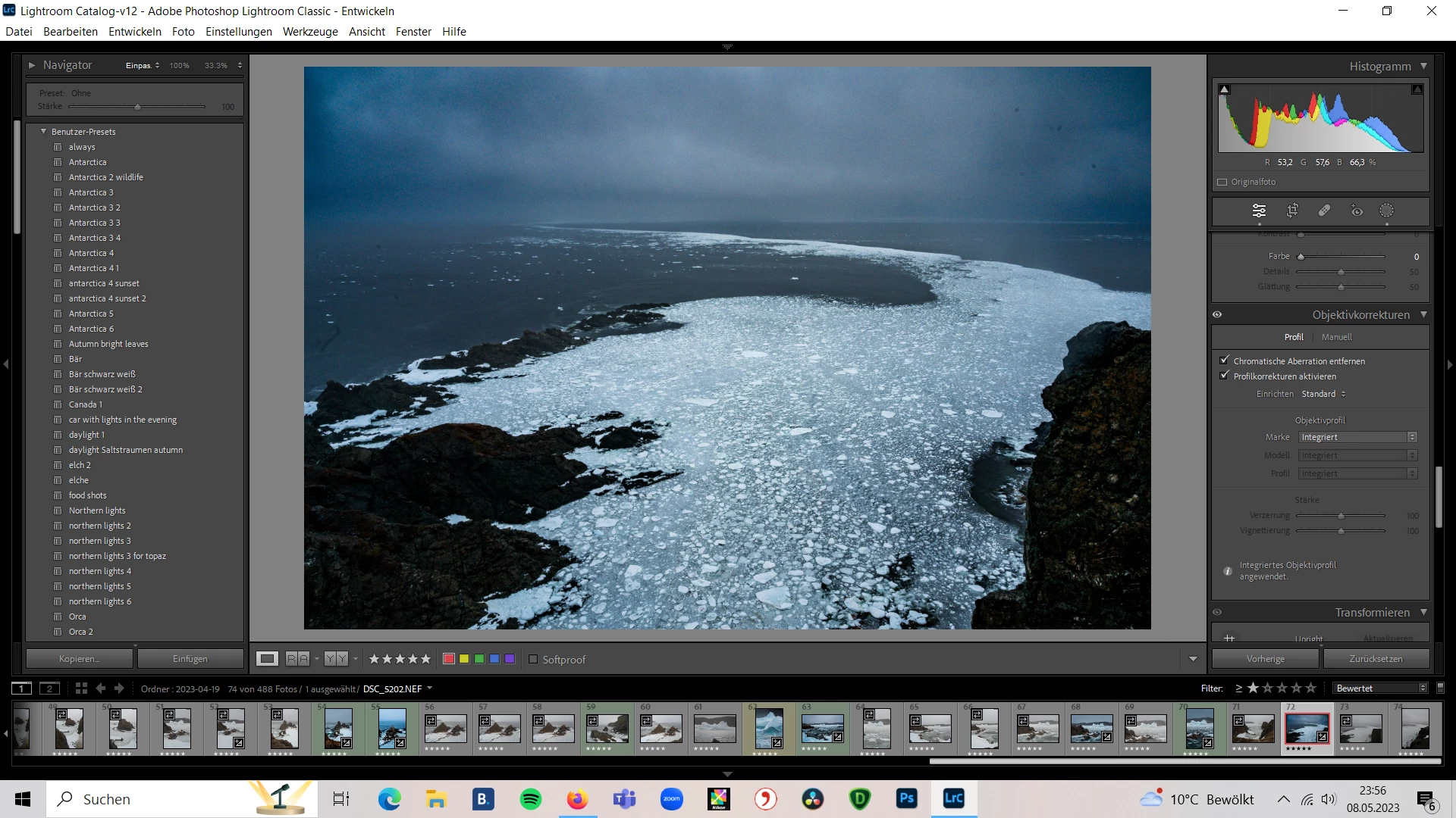

This problem unfortunately exists for every Z lens and every normal Nikon lens used through a FTZ adapter on a Z-type camera in varying amounts. Adobe does not correctly use the built-in vignetting profile that Nikon embeds in every raw file from these cameras. Nikon's software correctly corrects the vignette in its own software using the same profile data so the issue is simply the amount of correction being done I think which might not be correctly tuned. It's not always super visible but the problem is always there and has existed (and been discussed) ever since the Z cameras were first supported. This would be less of a problem if you could turn the built-in correction off and use your own profile or could use a simple slider to affect the amount of correction being applied but that is not possible for raw files from most Z cameras (only for the mk II versions) and for all Z cameras you cannot affect the amount of correction applied. Hopefully Adobe indeed takes a good look at this and better tune the correction or give us a slider for the built in profiles just like we get for the other kind of lens profiles so we can fine tune ourselves.
May 10, 2023
How long will it take until this problem is fixed? I have the same issue just not in panorama, just in normal RAW pictures with the same lens.
