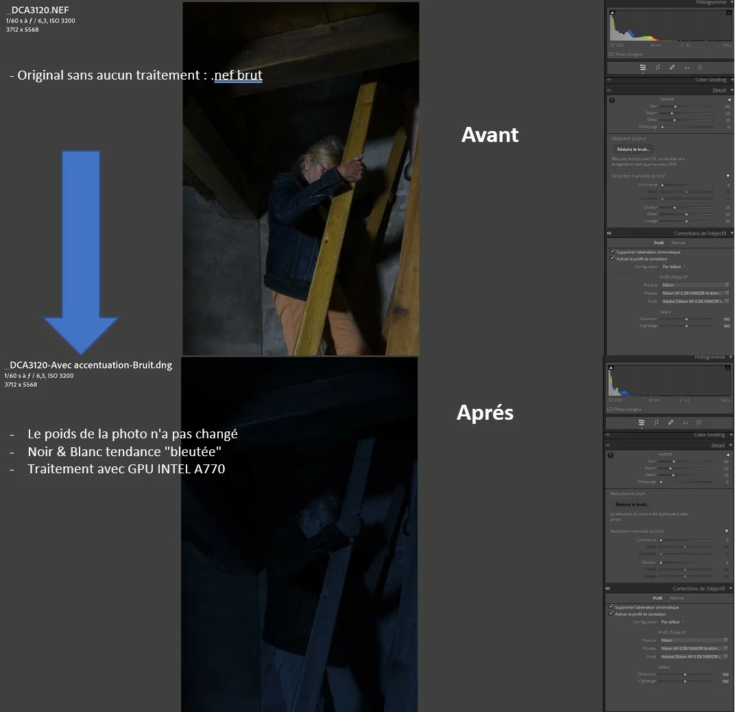

Bonjour,
Lorsque j'utilise la "nouvelle" réduction du bruit avec CAMERA RAW 15.3 à partit d'un fichier .nef non édité, brut sortie d'un nikon Z6II ou Z7II ou D500, j'obtiens un fichier .dng monochrome bleuté sans réduction de bruit, le poids de la photo ne change pas. Ce probléme arrive sur LRc 12.3 et Ps 24.5. (ce problmé arrivait dans la précédente version et sur la version BETA de Ps). Je travaille sous windows 11, 64Go de RAM DDR5, ma carte graphique est une INTEL A770 dont les pilotes sont à jour.
Ci joint une image d'illustration de la situation.
Merci de votre aide, cordialement,

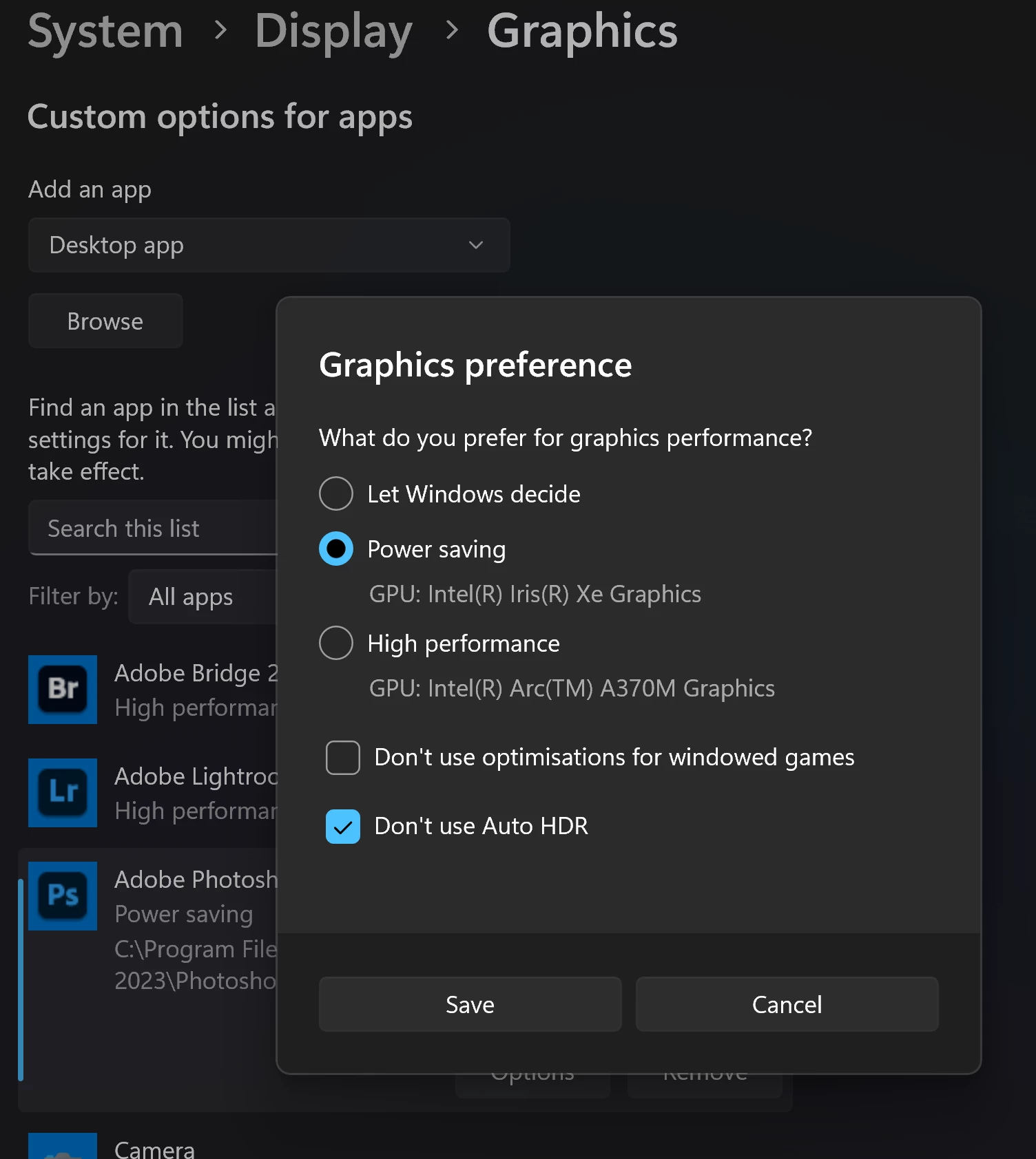

For me the culprit is clearly my discrete GPU (Intel Arc A370M), as I've now established that my integrated GPU (Intel Iris Xe) can perform AI denoise without issue (done by customising graphics setting for Photoshop to 'Power Saving', see screenshot). I'd been having the same problem where AI denoise progressively darkening images and stripping almost all the color out. However, I noticed that occasionally it would work. It then occured to me that ever since I've had the laptop (about 3 months) photoshop would randomly and periodically switch to the integrated GPU (prompting a warning), despite me customising the app as 'High Performance' to use the discrete GPU. Doing so purposefully then solved the issue. In my uneducated opinion there's clearly an issue with Photoshop and Intel Arc GPUs that goes deeper than just the AI noise feature.

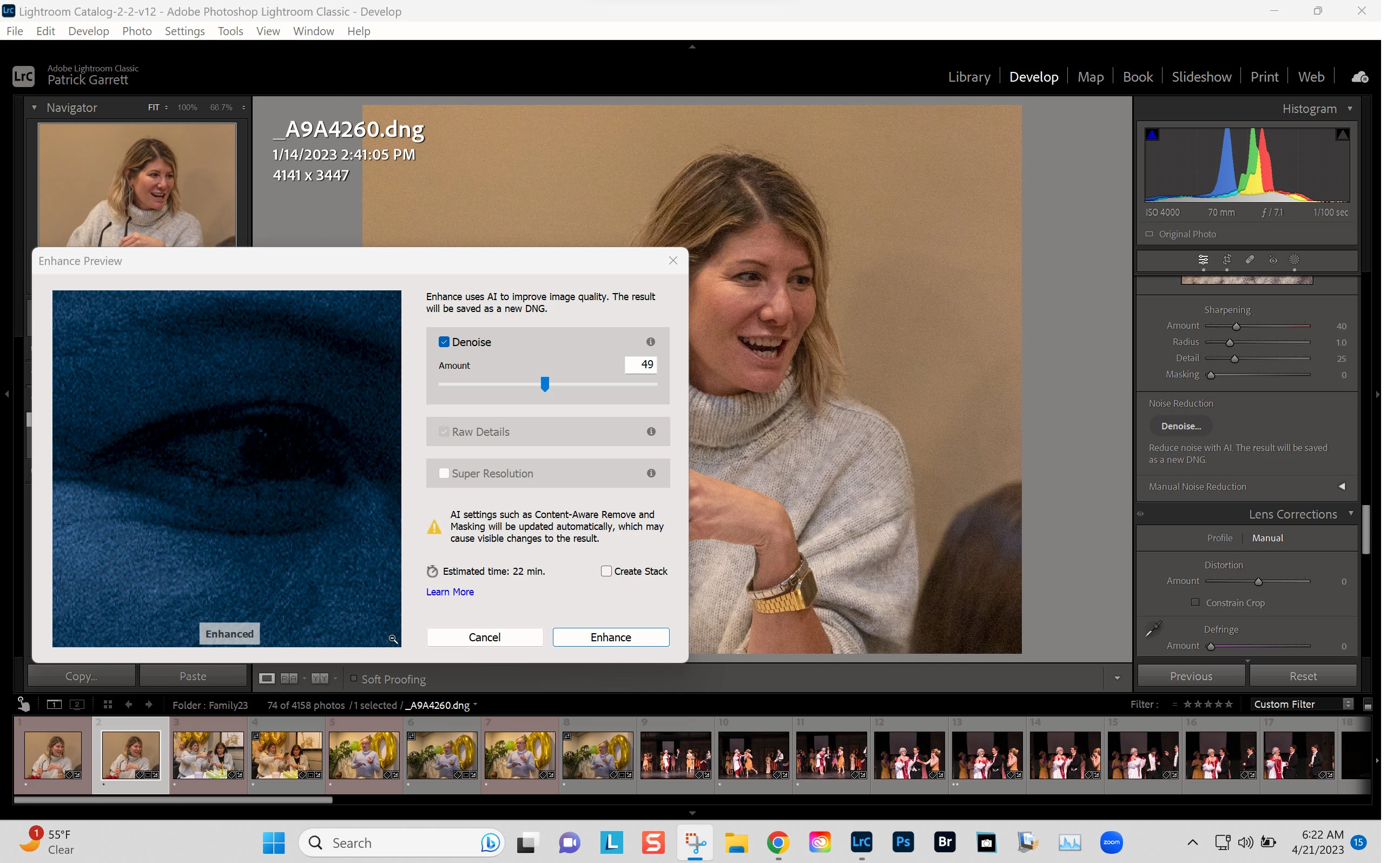

New Denoise not working.  I'm running LC12.3 recent upgrade.  the preview and saved DNG are sort of a B&W version (see attached screen capture.)  I've tried the new denoise on several different file types (CR2 CR3 DNG ARW) all with the same result.
