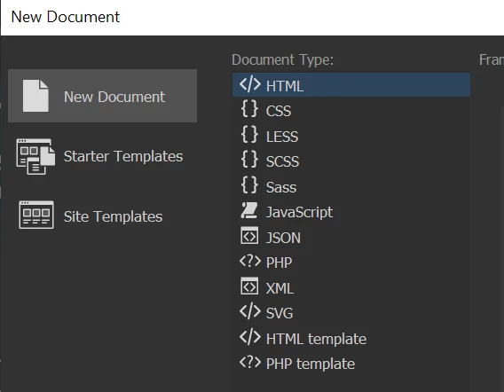

Remember, Dreamweaver is not CF intuitive.
DW's supported script types are shown below.
Adobe dropped CF support from DW in 2016.  They've since created a ColdFusion extension for Visual Studio Code.
