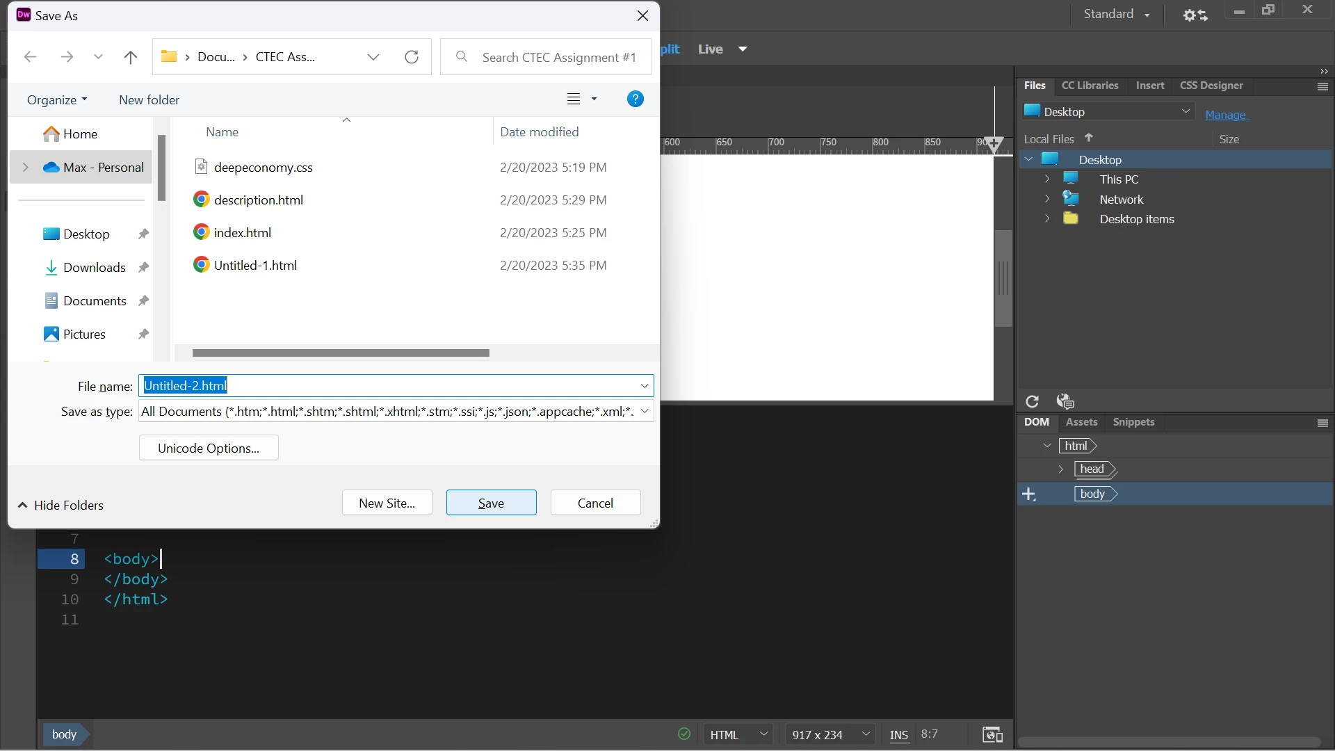

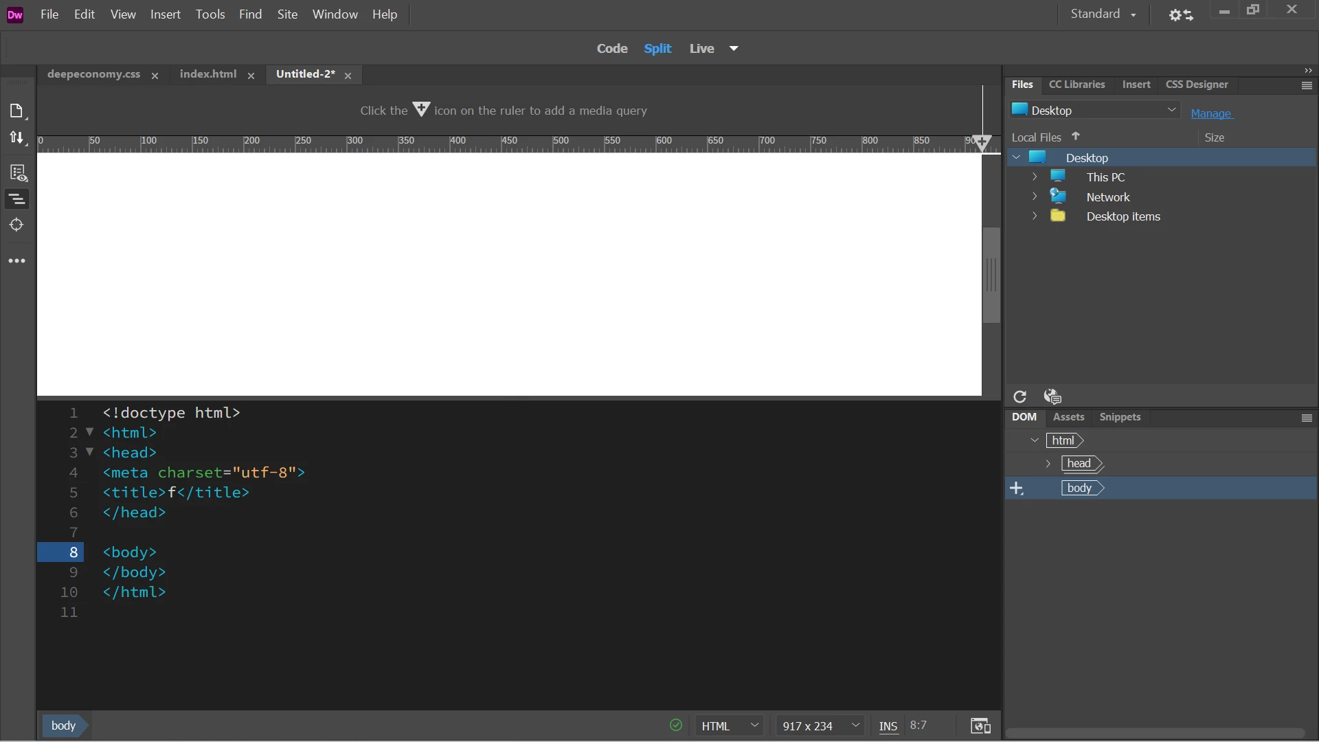

I've seen mutliple threads on this topic and have followed every instruction such as redownloading dreamweaver and restarting my computer and clearing preferences and it is only a short term solution. When I boot up my computer the next time, this glitch happens again. Everytime I create a document, HTML or CSS, right after I save I cannot see the code. I know the code is still there it just disappears from my view. I save and then it goes black. I've tried absolutley anthing and I cannot afford to reinstall Dreamweaver everytime I need to use it, it is ridiculous. My Dreamweaver is up to date and everything.

Also I am not using more than one display and and I toggled between those modes and it was all the same.  I have no idea why toggling code view makes it work but, I'm not complaining.  Hopefully this thread will help someone who's having a similar issue.
Feb 21, 2023 1:10 AM UTC
Yes.  Also within the past hour I have found a solution that is way easier to replicate. Everytime I open a new file it still does this,  however, if I go to View and toggle Code view twice everything works like normal. I have no idea why.
