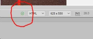

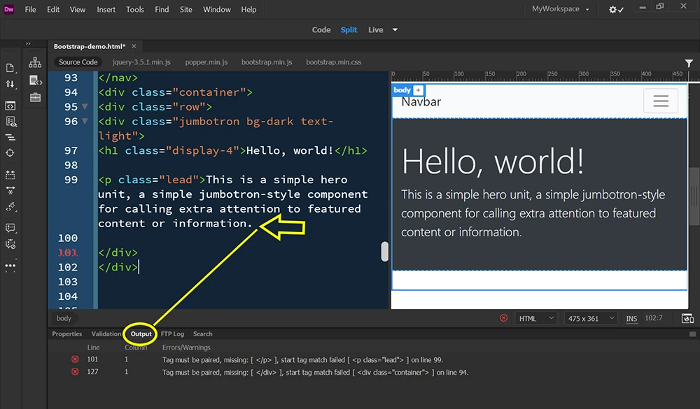

If I know there is an issue that I intend to rectify later, I can close the panel by just clicking on the 'X' icon (1). but if I fix the issue immediately and (1) turns green, I can no longer close this panel without opening the 'group' icon (2) and selecting 'Close Tab Group'.
The icon I'm talking about is shown in my image (1).
When it's red as shown here, you can close this panel.
When it's green you can't.
Hope this is more clear.
