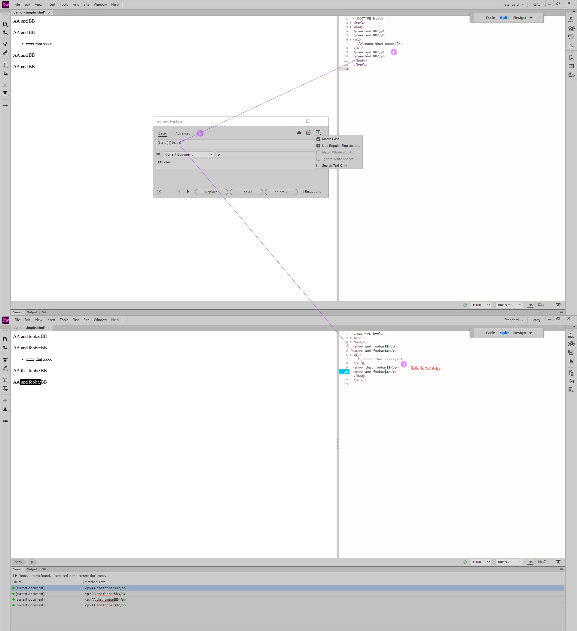

Why does Dreamweaver regex replace some word into a wrong word?
In short:
1. if you use a regex pattern contains an `or` syntax, `|`, eg:
(( and )|( that ))
2. and your replacement contains a capture group `$1`, eg:
$1foobar
3. and you perform an regex replace all in Dreamweaver
some text could be replaced with the wrong String, due to the `|` in the regex pattern. eg:
AA and BB
it should be replaced into
AA and foobarBB
but it may be replaced into
AA that foobarBB
which is wrong.
I had the exact same issue as what this web link describes (I reformated the simplified example from that link to above)
https://superuser.com/questions/1725719/dreamweaver-regex-replace-into-a-wrong-character-how-to-avoid
(For more detials, please view that link, it has better description and image.)
I am using Dreamweaver 2021 (Version 21.2)
OS Windows 10
(If someone test it, and you can / cannot reproduce the issue, please let me know.
And please let me know what version of Dreamweaver you are using that doesn't have such issue.)
