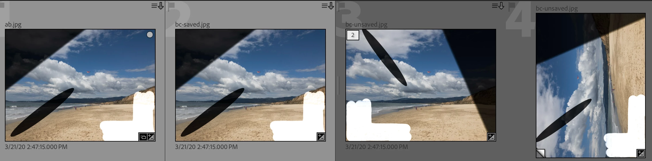

    ​@Anshul_Saini, ​@Rikk Flohr_Photography This bug, positioning copied masks incorrectly on rotated photos, has a simple cause and a straightforward fix. Copy/Sync Settings is reading the target photo's internal orientation from metadata saved to disk rather than from the catalog.
    There are still many other bugs with copying local adjustments between different orientations, as my test suite indicates, but this one is likely the most common one and perhaps the easiest to fix.
    To demonstrate, follow this simple recipe (tested on LR 15.4.1 / Mac OS 26.4.1):
    1. Uncompress and open the attached catalog. Observe there are four photos:
    ab.jpg - Photo has a linear gradient, a radial gradient, and a brush mask. Orientation in catalog: AB. Orientation on disk: AB.
    bc-saved.jpg - Photo has been rotated clockwise 90 degrees and develop settings have been saved to disk. Orientation in catalog: BC. Orientation on disk: BC.
    bc-unsaved.jpg - Photo has been rotated clockwise 90 degrees, but develop settings haven't been saved to disk. Orientation in catalog: BC. Orientation on disk: AB.
    bc-unsaved.jpg virtual copy -- this is bc-unsaved.jpg but without any rotation applied. Orientation in catalog: AB. Orientation on disk: AB.
    2. Select all four photos with ab.jpg most-selected.
    3. Do Sync Settings with just Masking selected.
    Observe that the brush masks have been correctly positioned on bc-saved.jpg and bc-unsaved.jpg virtual copy but not bc-unsaved.jpg, indicating Sync Settings is using the target photo's orientation from the disk metadata rather than the catalog:
