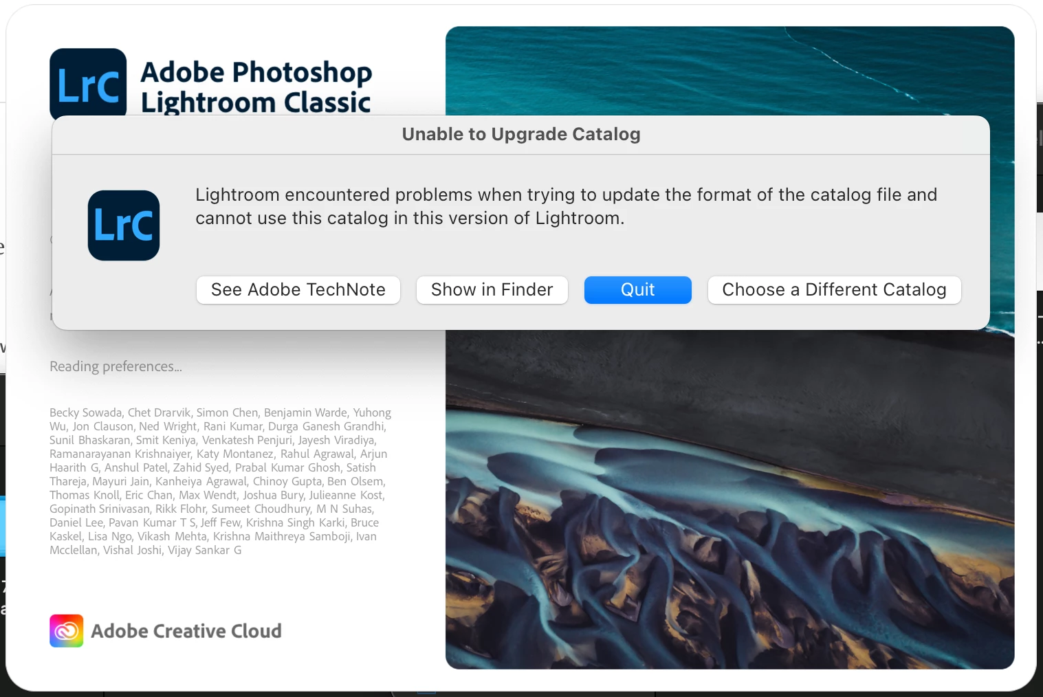

Oct 19, 2022 9:38 AM UTC
I updated my LRC to 12.0 and none of my catalogs open. I've tried a couple of fixes found on the Discussions and none of them work(so I went back to 11.5 so that I can do my work). Has anyone else had this problem?
Macbook Pro 15 2.6GHz i7
Oct 19, 2022 10:20 AM UTC
Do you get an error message? If yes please post the message word by word.
