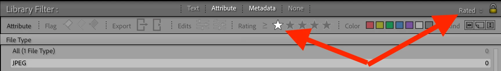

9. Type Cmd L (filters off) and again Cmd L (filters on).  Observe that the Library Filter bar's Attribute bar is now showing, with >= 1 star selected, and the name in the preset popup is Rated. This is incorrect:

- Saving a preset with the Attribute button deselected nevertheless saves in the preset the hidden previous star rating. In particular, the preset JPEG - Camera Info was saved with these two lines in the .lrtemplate:
filtersActive = false,
minRating = 1,
The second line should have been:
minRating = "<nil>",
- When "minRating" is something other than "<nil>", the command FIle > Library Filters > Enable Filters (Cmd L) always sets "filterActive" to true, even if the previous state was false.
- The built-in preset Camera Info also contains these two lines:
minRating = 1,
probably because the original developer had saved it after saving the Rating preset.

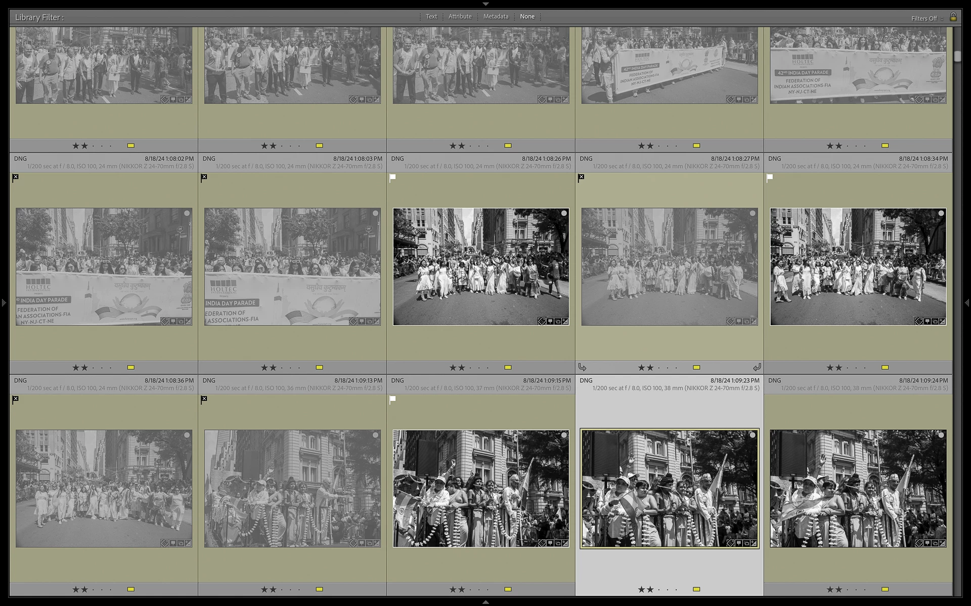

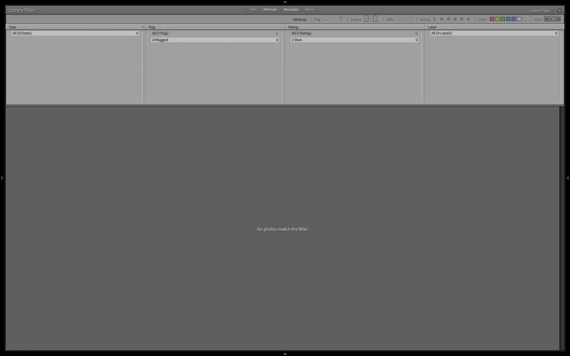

This started happening a few months ago, and I’m not sure why the behavior has changed or what I did to change the behavior?
When you were culling images and you have a custom filter applied, if you remove the custom filter (cmd / ctl + L) and then reapply the filter (cmd / ctl + L)  instead of going back to the previous custom filter preset that you were working with it goes to a blank custom filter.
How do you get it to go back to the previous filter preset that you were using? This has been the way that it has worked from almost the beginning of time and I’m not exactly sure what I did to screw it up.
Thanks in advance – CES

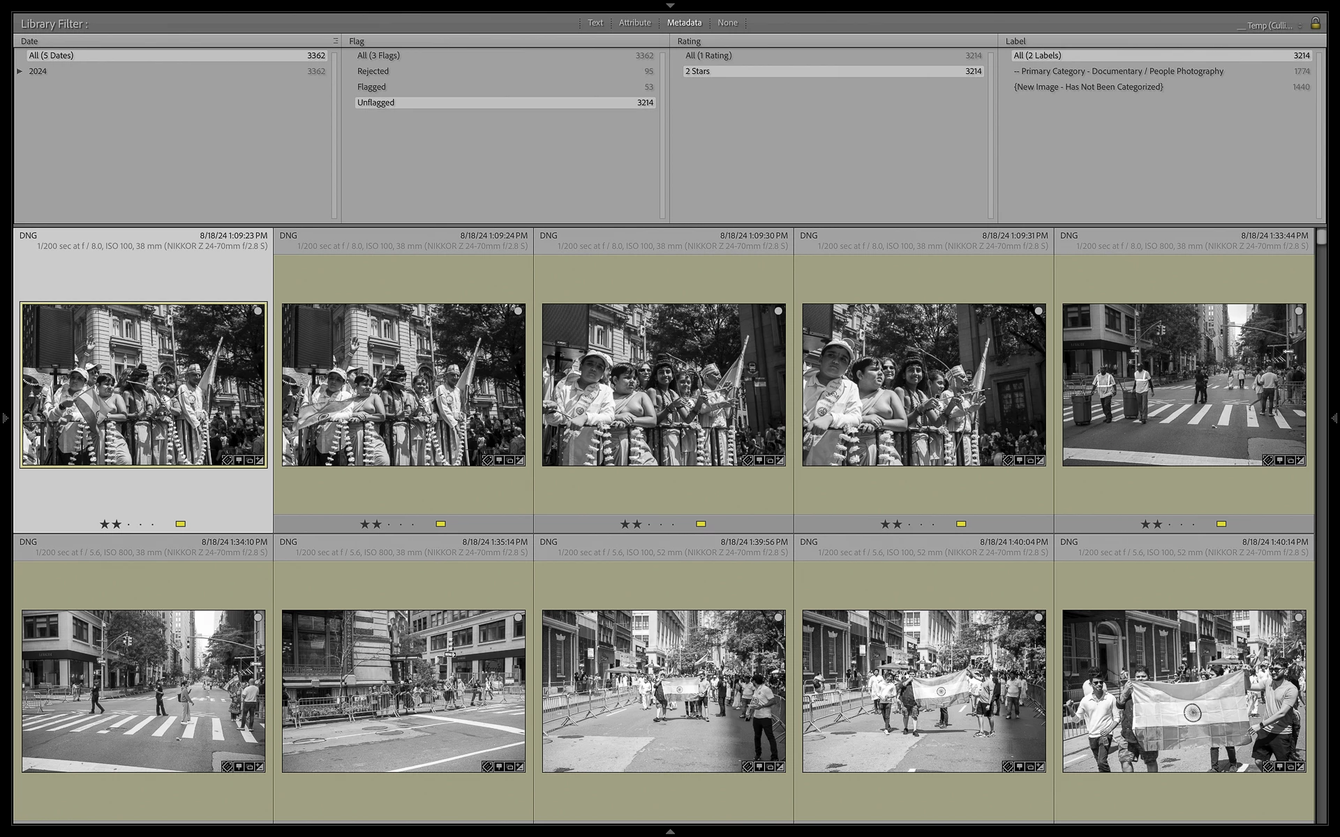

Jan 23, 2025 7:07 PM UTC
In the third screenshot, I notice that both Attribute and Metadata are apparently selected/highlighted
Jan 23, 2025 7:28 PM UTC
It' just what LR applies when you try to reapply the filter... It doesn't go back to the previous filter that was used which was the way it use to be. At some point the behavior changed.
