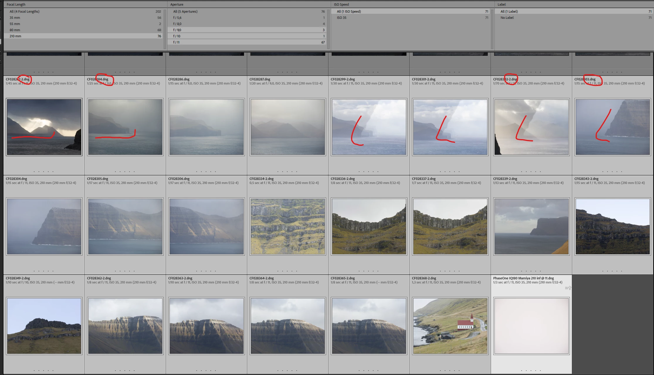

Long story short: Lr's FFC works not as described. Description tells that only first or last file in sequence is treated as the reference flat field frame, but actually every file is checked for uniformity, and if Lr decides that it is uniform enough to be treated as the reference - it is treated, and the next file treated as photo is corrected using this "new reference" file that actually is a real photo, just not-so-contrasty.
It leads to two issues:
- not all files are corrected
- if there is a file in the middle of the sequence that is not corrected, then files after (in the direction from real reference file) that file are corrupted.

Attached screenshots: with issue, and with hints where to look at. Take into account that LR processed files from the last to the first, as the reference is the last file in the sequence.
I can not attach photo file that is erroneously treated as reference because it exceeds allowed file size, but I can provide any files in some other ways if needed.
Just illustration
The same with hints

The team has looked at your post and asks if it would be possible for you to provide us the set of files. You can share them from Creative Cloud/Dropbox or similar.
Alex Matiash
May 17, 2022 3:30 PM UTC
Sure, here it is (I hope it was shared correctly):
https://www.dropbox.com/sh/5k8too3h7rzhpxm/AACwF_3ltS51zWsPgbhkvdv7a?dl=0
CF028267 - correctable
CF028284, CF028301 - treated as the reference
CF028302 - correctable
CF028303, CF028304 - treated as the reference
CF028334 - correctable
PhaseOne IQ180 Mamiya 210 inf @ 11 - reference
