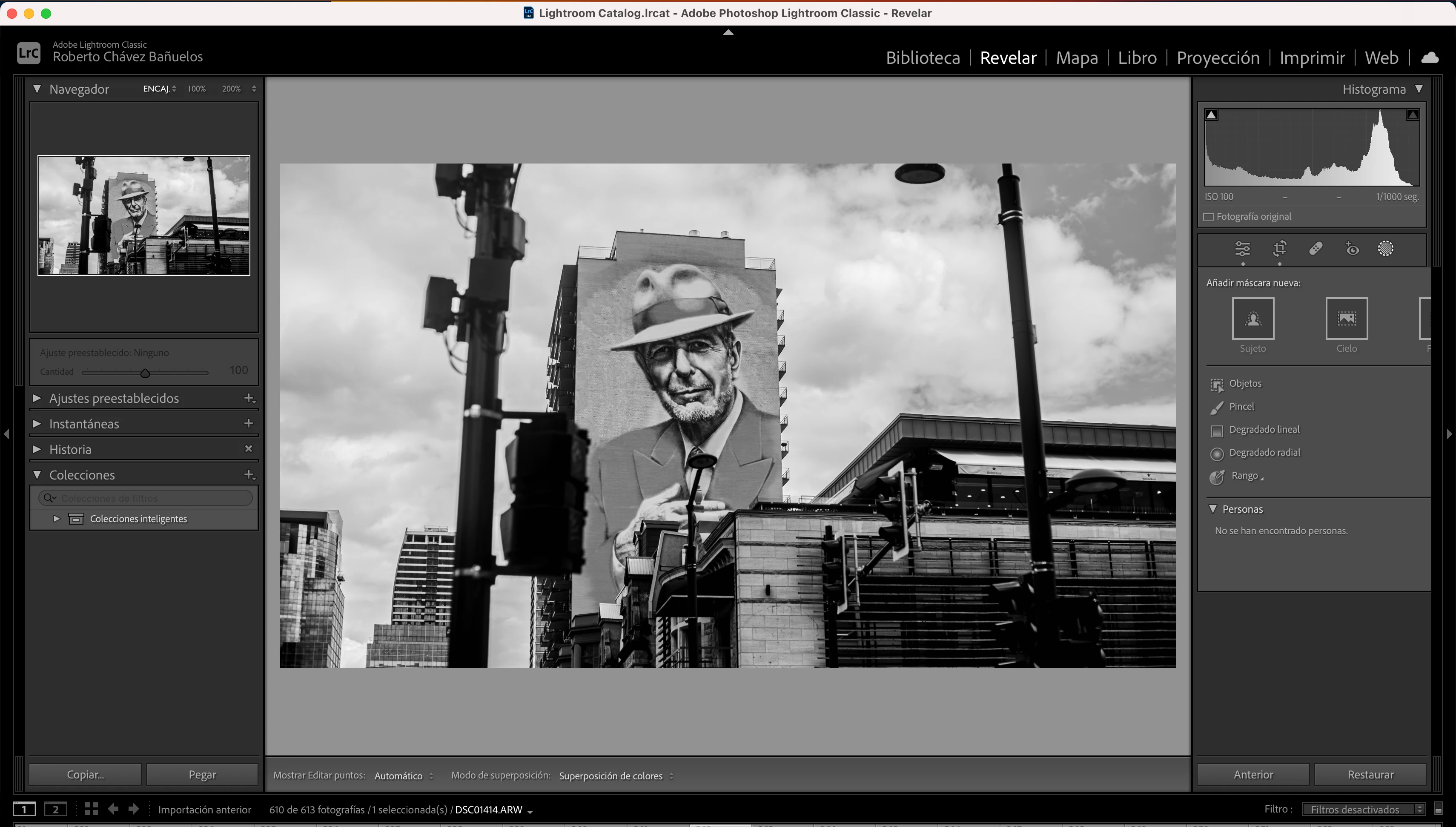

Hi! I just updated Lightroom on my computer and the side menu for the filters goes offscreen and I can't seem to find a solution for it to go back to normal. (This only happens with the filters menu bar, the regular adjustments bar has no problems fitting the screen)
Does anyone know how to do this?
I attach a picture of the problem.

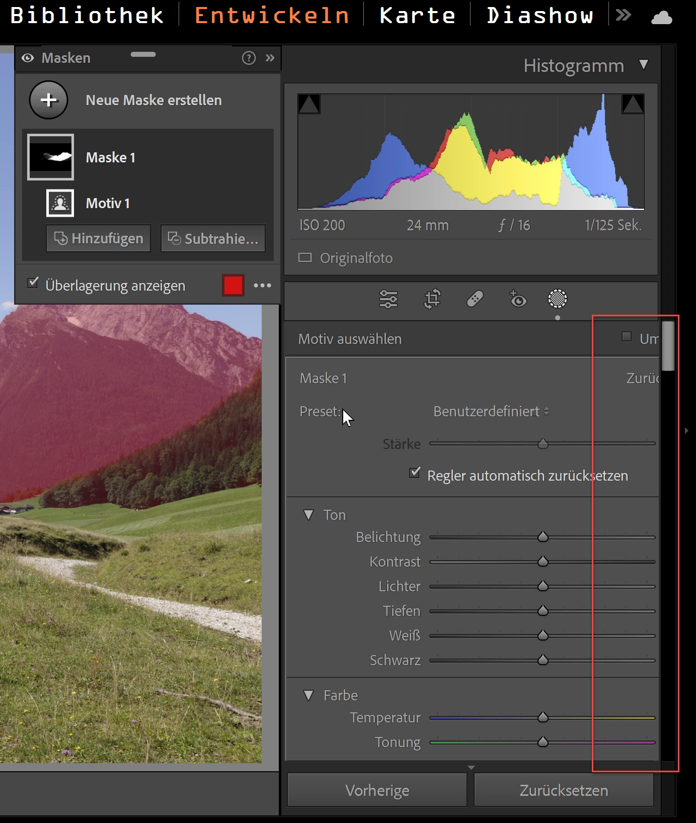

After updating from 12.4 to 12.5 and activating masks, the right part of the panel is not visible. You can draw it bigger to get it back, but at next start same problem. See attched screenshot.
Other people report the same problem in various other communities.
