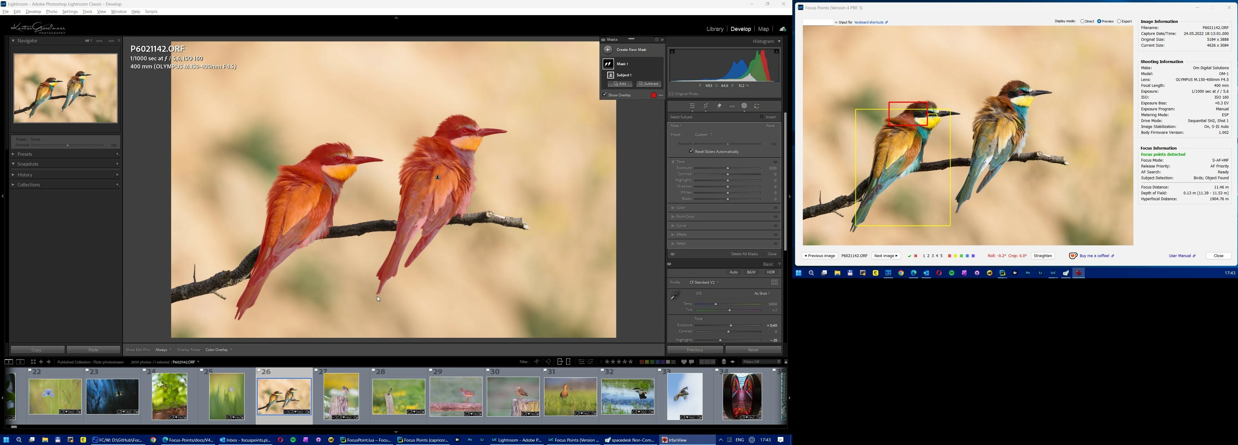

    My request concerns the behavior that occurs immediately after the floating dialog has been opened. Typically, the dialog is the active window and receives keyboard input, but it is possible to create a situation where this does not happen. Ideally, the caller should explicitly define the desired behavior so that different types of applications can be specified. E.g. an interactive dialog vs. one which is “following” (monitoring) what happens in Lightroom, even if this involves a refresh (close & reopen) of the dialog, like my Focus Points plugin does:
