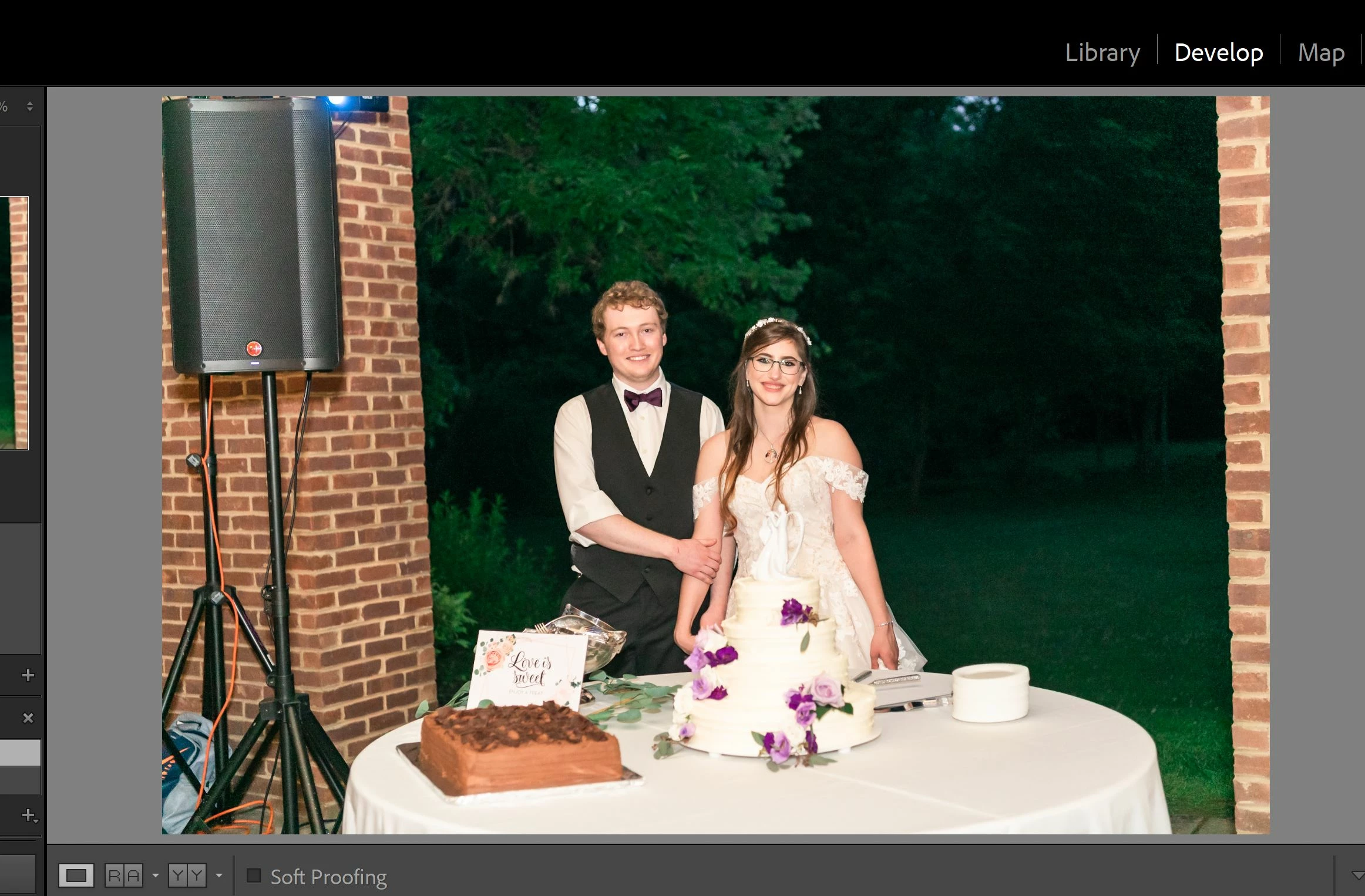

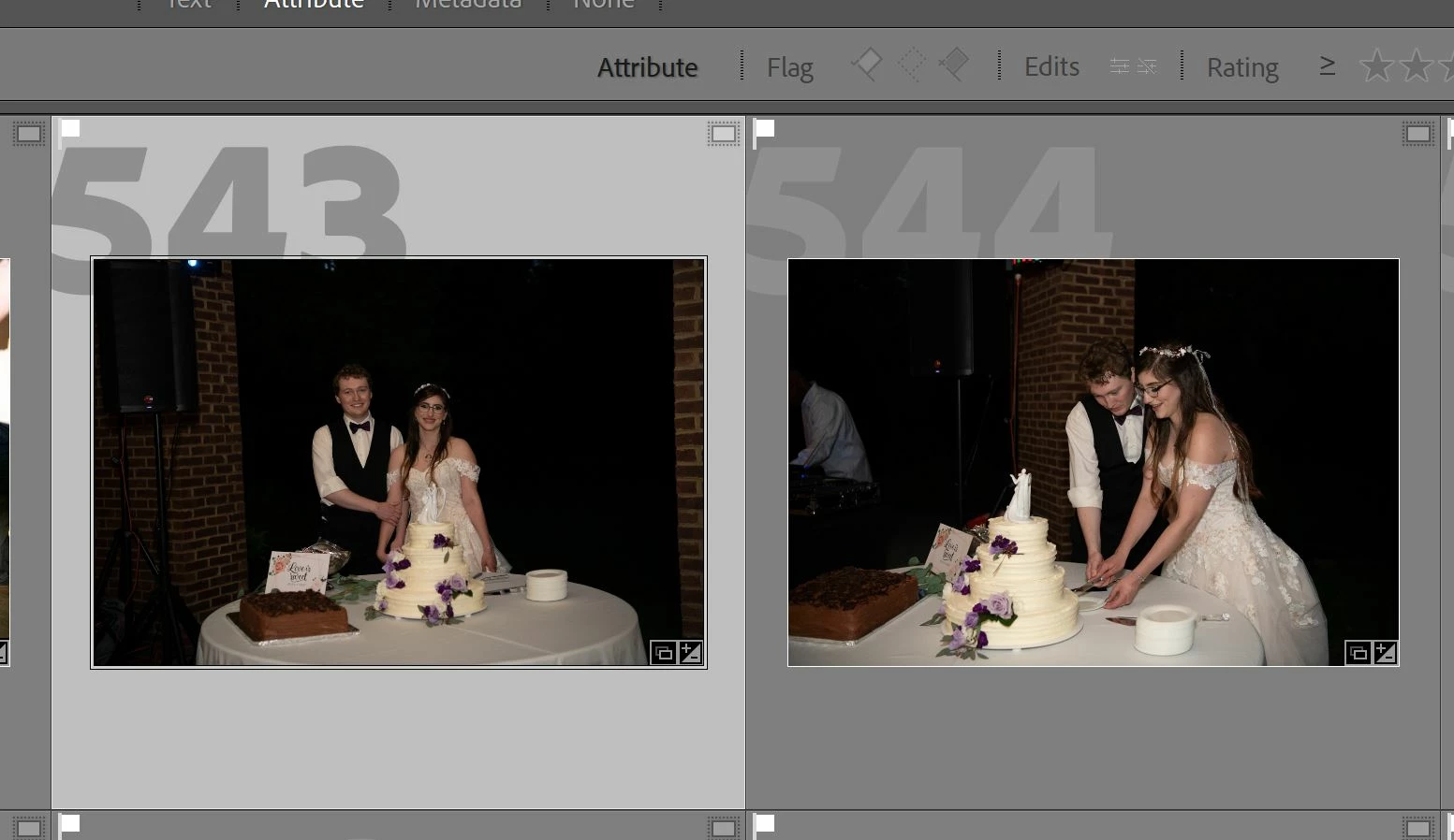

The latest update has a glitch on the sync previews (syncing edits in the library or develop module) the changes take but won't show unless you manually click on each image. The images look like they haven't been edited yet and it's very frustrating, especially for weddings. Has anyone found a fix for this?
Photo 1 is how it shows in grid view and filmstrip. ex2 is the actual edit that is on the image at that time.
