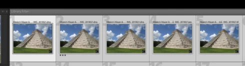

After conversion of tiffs to dngs, I have multiple dngs!!!
Here's the details...
After importing a series of tiff images, I converted the tiffs into Adobe dngs files.  After restasrting LR 7.5, I find that I have multiple dngs!?!   At least three (3)!
Really?  Seriously?
My Finder does not show these duplicates as actually existing.  So where in the heck did they come from?

I found that each dng in the Library view pointed to the same dng file in Finder.  Not knowing which one to remove, I simply chose one and viola!, they all were removed (for a given image).  The actual dng file was, of course, untouched.
I repeated the process for all of the images with duplicate dngs.  Then I optimized the catalog and restarted LR.  Next I performed an import and the individual dngs in the folder were imported and added to the catalog, one for each image.  No duplication this time around.
