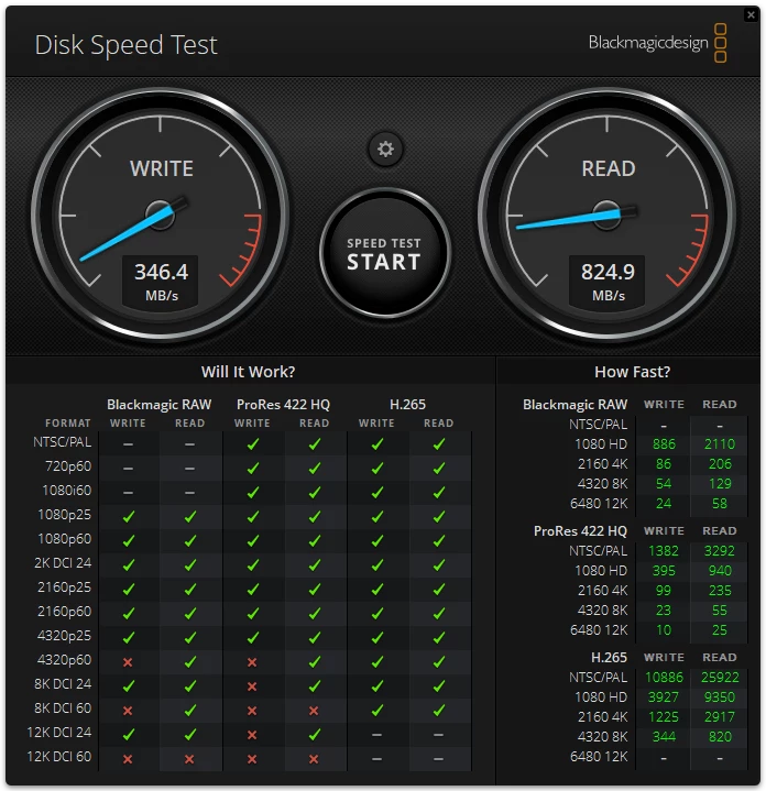

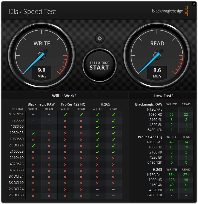

The images are stored on a NAS over a 10Gb fiber connection. The images are being imported in place (added). Build previews is set to Minimal and Smart Previews is checked. At the time of testing (and during importing) I was the only one using/accessing the NAS. With Lightroom closed, I ran Black Magic Disk Speed Test with a 1GB test file and was getting 346MB/s Write, 825MB/s Read. As soon as I open Lightroom (just open, it's literally doing nothing else. No importing, no editing, no preview generation) the disk speed drops to 10MB/s Write and 9MB/s Read. What's even more odd is that this persists after closing Lightroom, as Lightroom moves from the "Apps" to "Background Processes" in the Task Manager. As soon it drops out of Background Processes, or I End Task, the Speed Test results come back.
