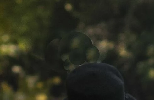

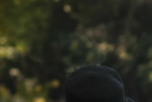

I've just upgraded my LR4 to LR5.2 and after open my LR4 catalog in LR5.2 I discovered that some photos (not all) with many spot removal applied are not rendering right:
LR4:
LR5.2:
Am I doing something wrong or is it really a sw bug?

I can confirm that altough LR 5.3 RC now does have a non-zero default setting for the feathering which makes the images that include spot healing much more look like in LR4, there is still a quite noticable difference (in fact, it appears that the transparency curve is different between both versions). The difference is noticable in particular when the diameter of the spot is close to the size of the object to be removed (i.e. there is usually no problems when removing skin blemishes etc.) .
I believe it is of paramount importance for the LR users that the images are rendered the exact same way when upgrading to a new version. This is why LR uses the concept of process versions. Note that the images may comprise a great deal of manual work iun LR to make them look as desired. For many photograhers, it is important that the look of exported images that are sent to the customer don change just because the software was upgraded.

Todd, I agree. After my post, I upgraded to 5.3RC and it did resolve the "Feather set to 0" issue, however the spots still don't look the same as they did in LR4. It looks like there were more changes made to the spot healing/clone tool in addition to the new feather control.
I used the new functionality to correct a couple of images relatively quickly, but I still think Adobe should revise this so that existing images continue to look like they did pre-5.2 upgrade. It's going to be difficult to notice all of the potential issues when doing a quick export of older images.

I updated all of my LR4 and earlier edited images manually using LR5.2. None of my images were edited in LR5.0. What I discovered is that with the new Feathering capability clone spots no longer behave the same as LR4 and earlier versions. See this post as to possibly why:
http://forums.adobe.com/message/56994...
I couldn't find one setting value (25%, 50%, 75%) that made ALL of the spots look "good." With the ability to now "click-and-drag" the spot tool it is easier to just start over on many images. Even when updating an existing unconverted LR4 catalog I seriously doubt it is possible to do this conversion "automatically" with good results on all images.
