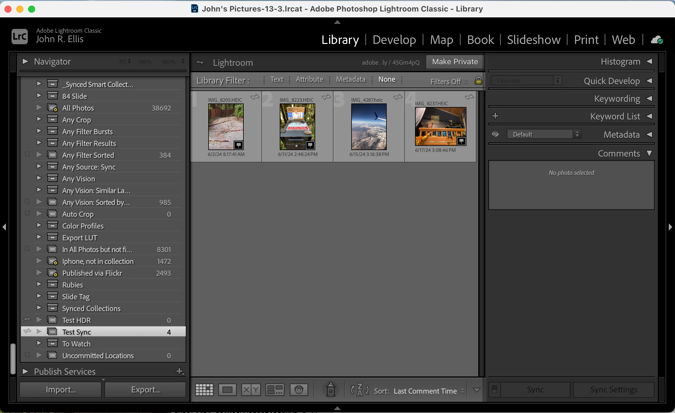

P: Notifications for likes & comments & sorting by last comment time fails

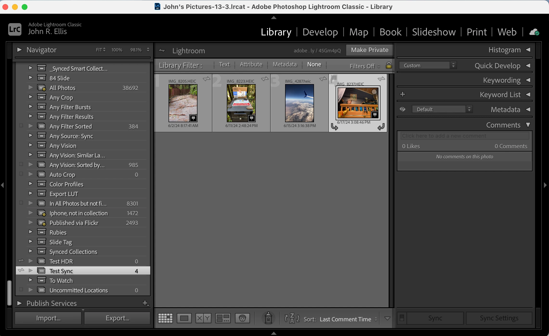

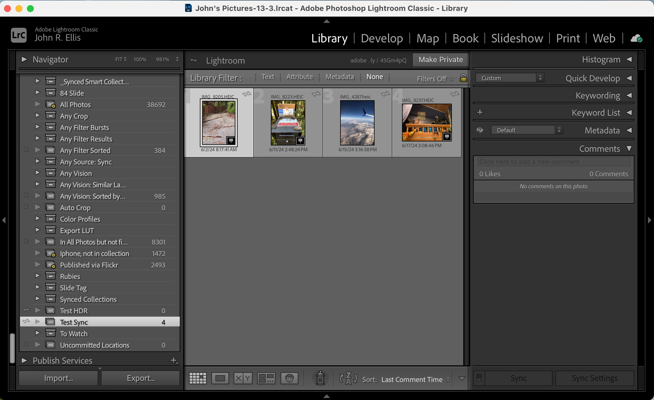

Notifications for likes and comments in shared albums (public synced collections) don't appear in LR 13.4 -- there are no yellow badges.  And sorting by Last Comment Time doesn't work.   (A previous report for the lack of badges in LR 13.3 and 13.3.1 is marked as Fixed.)
Here are the steps I took and screenshots of the results:
1.  In LRC, I created a public synced collection "Test Sync" and added four photos to it.

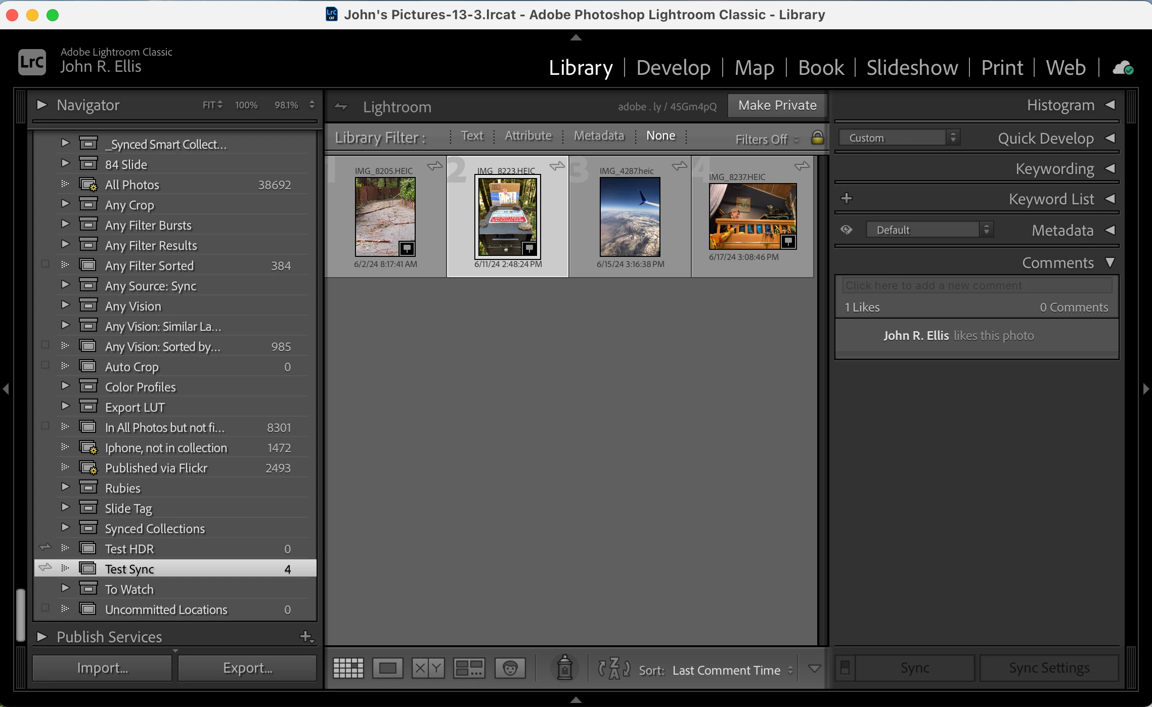

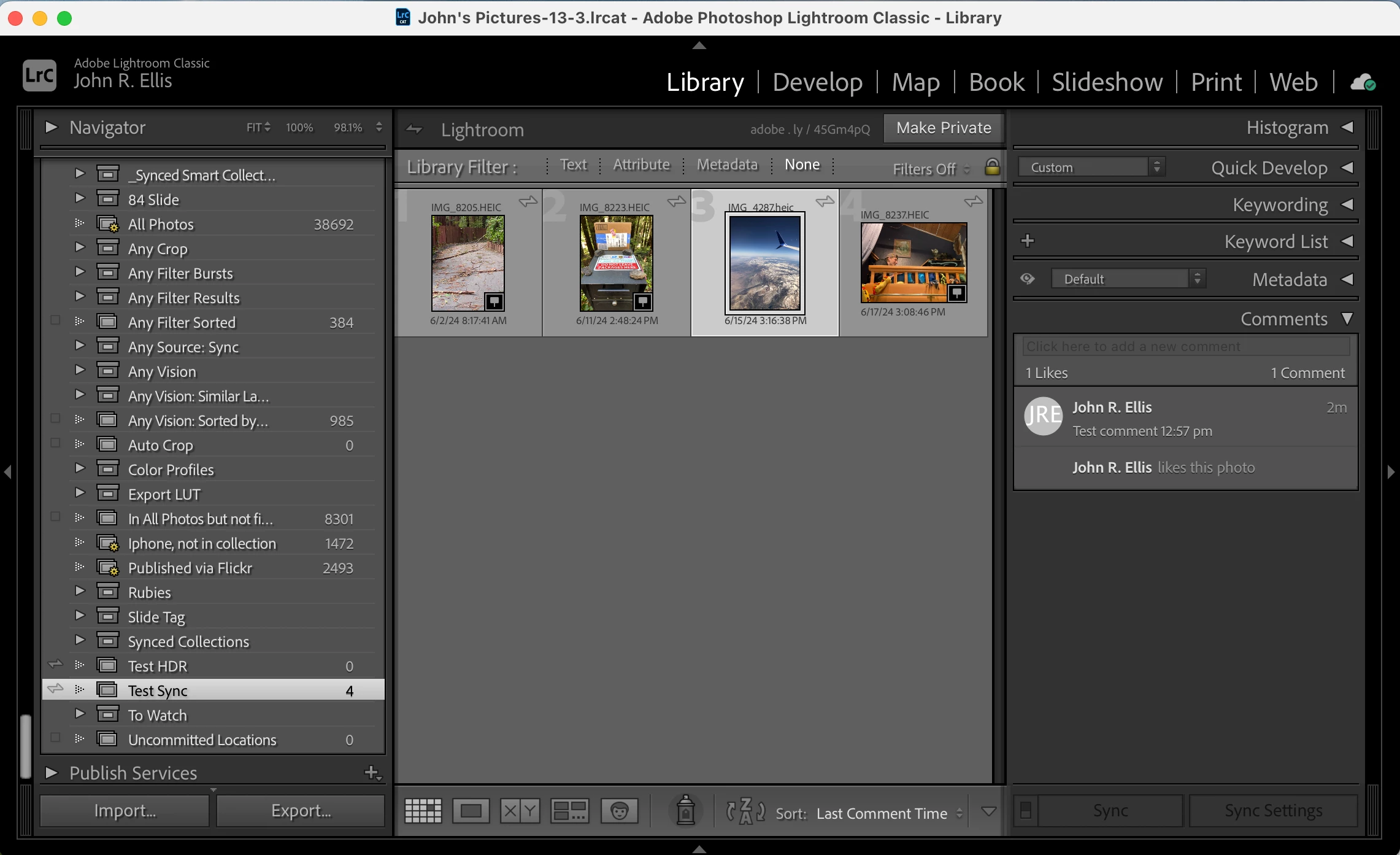

2. In LR Web, I marked the second photo with a like and the third photo with a like and a comment (photos sorted by capture time).
3. After waiting for the sync to LRC complete, the likes and  comment appear in the Comments panel. But there are no yellow badges and the thumbnails are not sorted by Last Comment Time (the second and third photos with likes and comment should sort first and second).  View > View Options > Cell Icons > Thumbnail Badges is enabled, as demonstrated by the GPS badges on the thumbnails.
These screenshots provide all the evidence:
6 replies

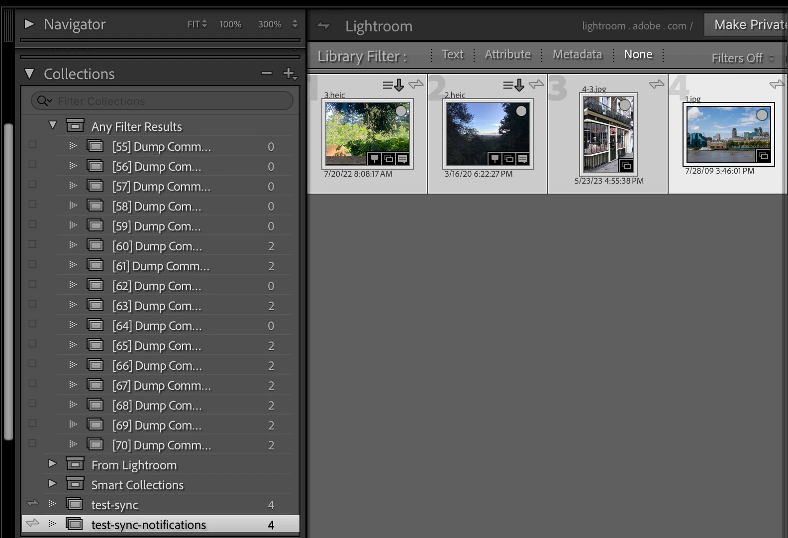

Jul 9, 2024 9:28 PM UTC
Vidhya,
Thanks for clarifying the new behavior in 13.4.

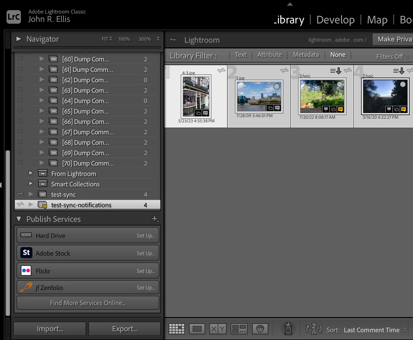

I repeated the original steps above, and the misbehavior with missing comment badges and Sort: Last Comment Time no longer appears. Compare this screenshot (correct) to the original above (incorrect):
The original screenshot showed something obviously wrong, but the misbehavior no longer occurs with those steps.
I then redid the test using another account, and it behaves as you described. I added comments and likes from a different test account (to 3.heic and 2.heic) and then from my main account (4-3.jpg and 1.jpg):
The badges appear as expected for the comments/likes from the other account, and Sort: Last Comment Time worked correctly taking account of all the comments and likes.
