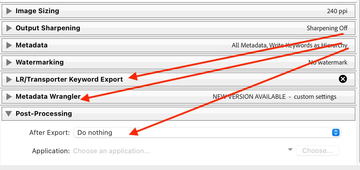

December 5, 2024
[This post contains formatting and embedded images that don't appear in email. View the post in your Web browser.]
@Addison33594689kznf, you described the crashes as occurring during exports, and the crash report shows the crash occurring while LR is trying to execute a child program. So check the settings in the Export window for the presence of a post-processing plugin such as Metadata Wrangler or a post-processing After Export program.  In this screenshot, there are two export plugins enabled, LR/Transporter Keyword Export and Metadata Wrangler:
If you see such a plugin, remove it by clicking the "x".  Ensure Post-Processing > After Export is set to Do Nothing.

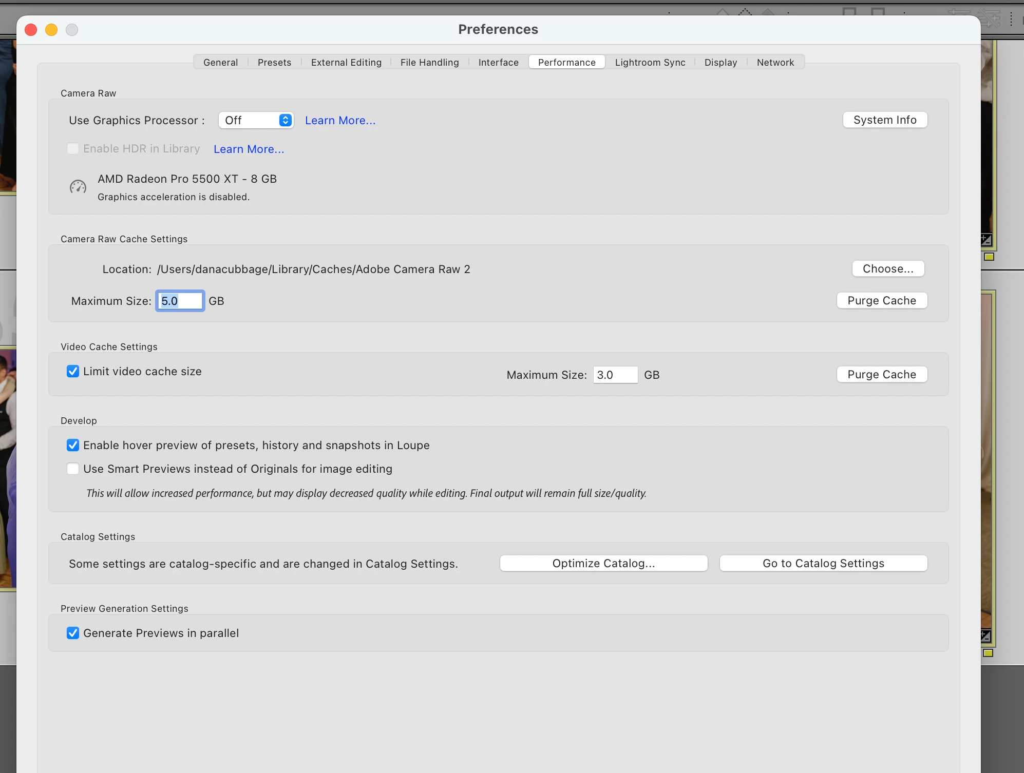

And a screenshot (below) of my Lightroom Preference settings.  I've been on chat with Adobe a ton of times over the past few weeks and we've tried the following: uninstall/reinstalling Lightroom Classic, trying older versions of LrC, changing permissions on Adobe folders, resetting LrC preferences, disabling the GPU on export, disabling the GPU completely, exporting to different hard drives, exporting from a test user on my mac, updating macOS, exporting in safe mode, etc.  Nothing seems to help.
The amount of time/images it takes for the error to occur varies.  Sometimes I can export 100 images without it stopping.  Sometimes it's only 4-5 images, then I get the error.
Adobe mentioned that there could be an issue with Intel i9 and AMD with the new version of LrC.  Just trying to see what else I can try - I really don't want to have to buy a new mac since this one is only 3 years old 😞  Thanks in advance for any insight you can provide!!
