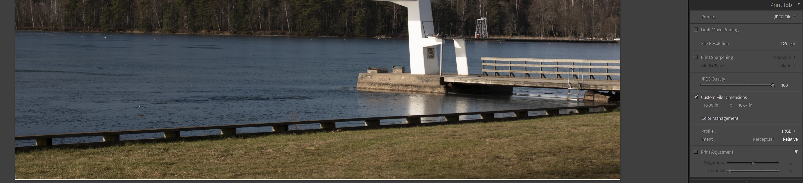

When using the Print module, a thin white line often shows at the bottom of the displayed image.
It happens only onscreen (i.e. not in the output JPEG file or print) and depends on the actual display size of the image. If I change the LrC window size or hide some panels, in sometimes disappear. In this case (outputting an aspect ratio of 4x5 portrait), just pressing T to hide toolbar makes the displayed image a bit bigger and the line disappears.
With an output of 3x4 portrait, for instance, it doesn't show with the toolbar either shown or hidden, but if I hide the top panels (F5) it appears (with or without toolbar).
In 5x7 portrait, it appears with or without toolbar.
In 16x10, it appears with the toolbar hidden.
And so on... as mentioned, it's purely based on the actual displayed image size.
It would be nice if at least it weren't ignored again.
Michael

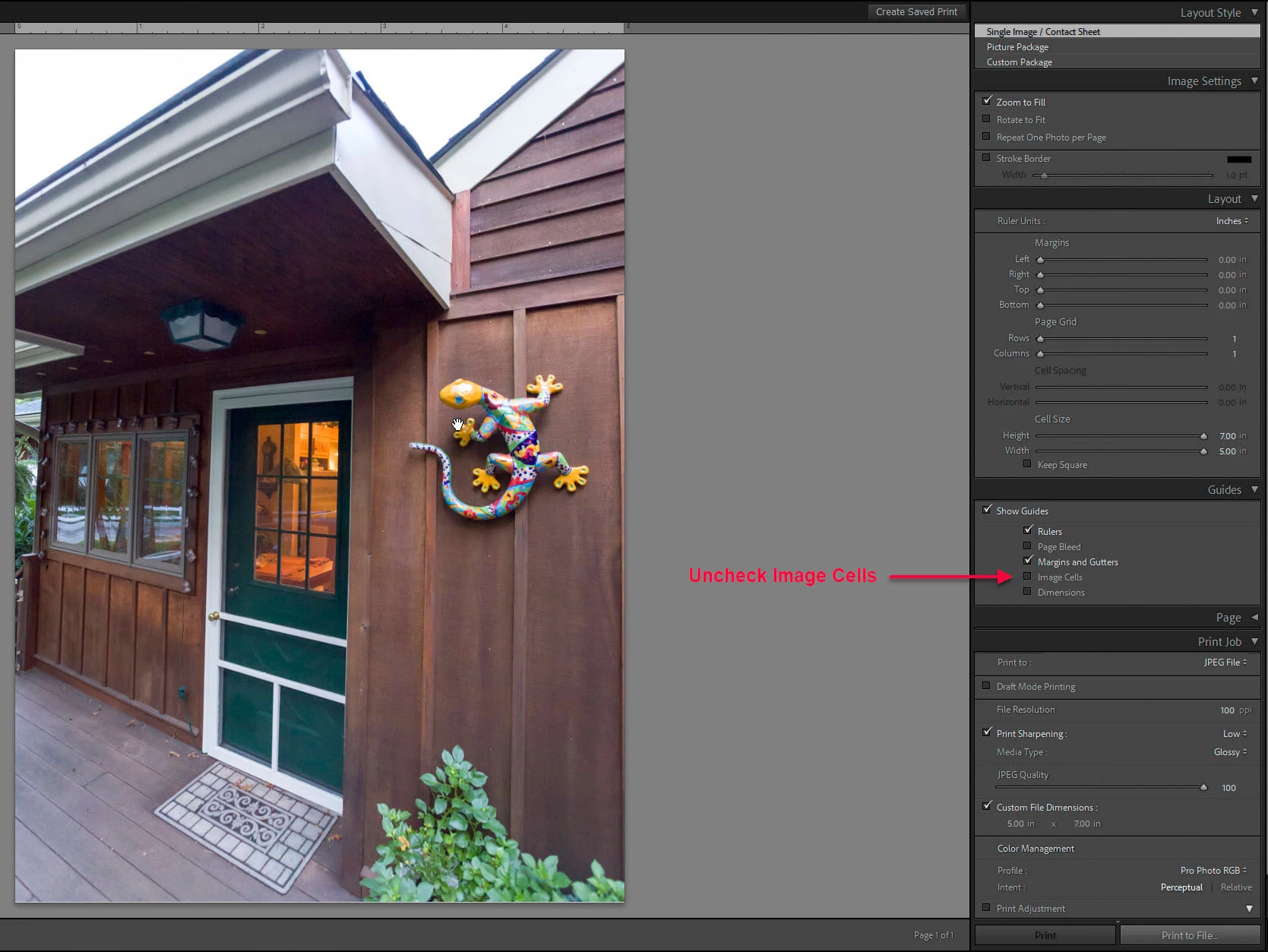

Todd Shaner
Nov 11, 2021 12:01 AM UTC
I can duplicate the bottom white line issue on my Windows 10 system using LrC 11.0. Below is a portratit 5"x7" layout with no margins. It appears when 'Image Cells' is unchecked in the Guides panel. Not sure what the signifigance is, but it appears to be a bug (rounding error?).

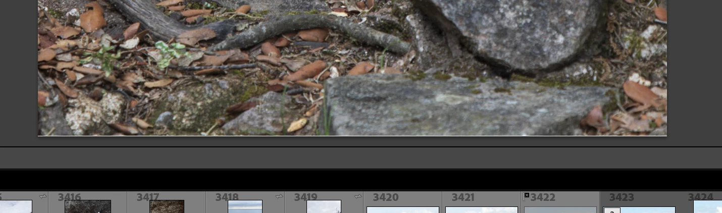

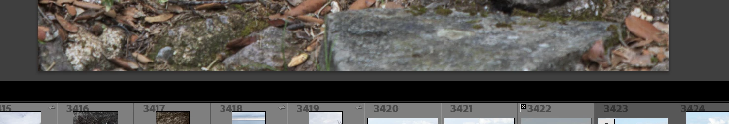

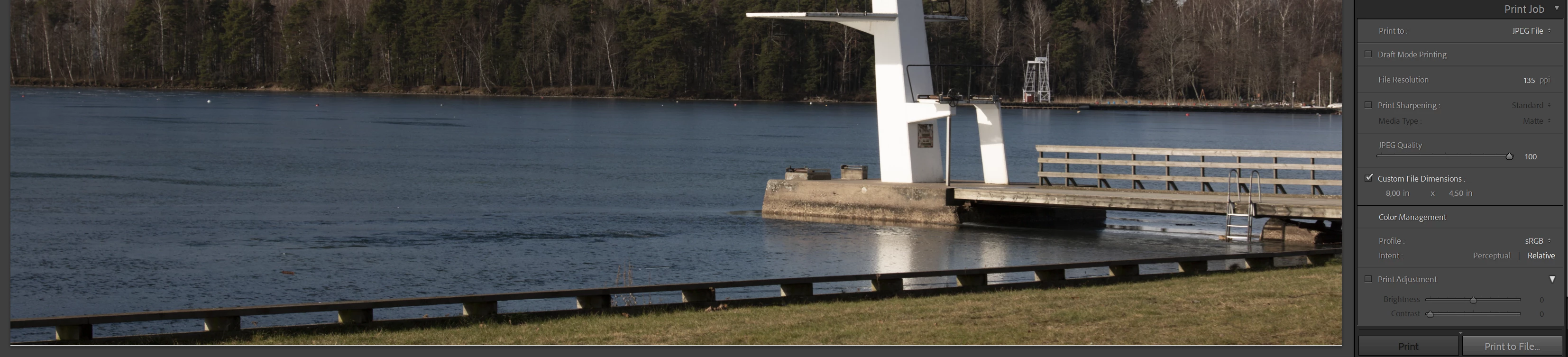

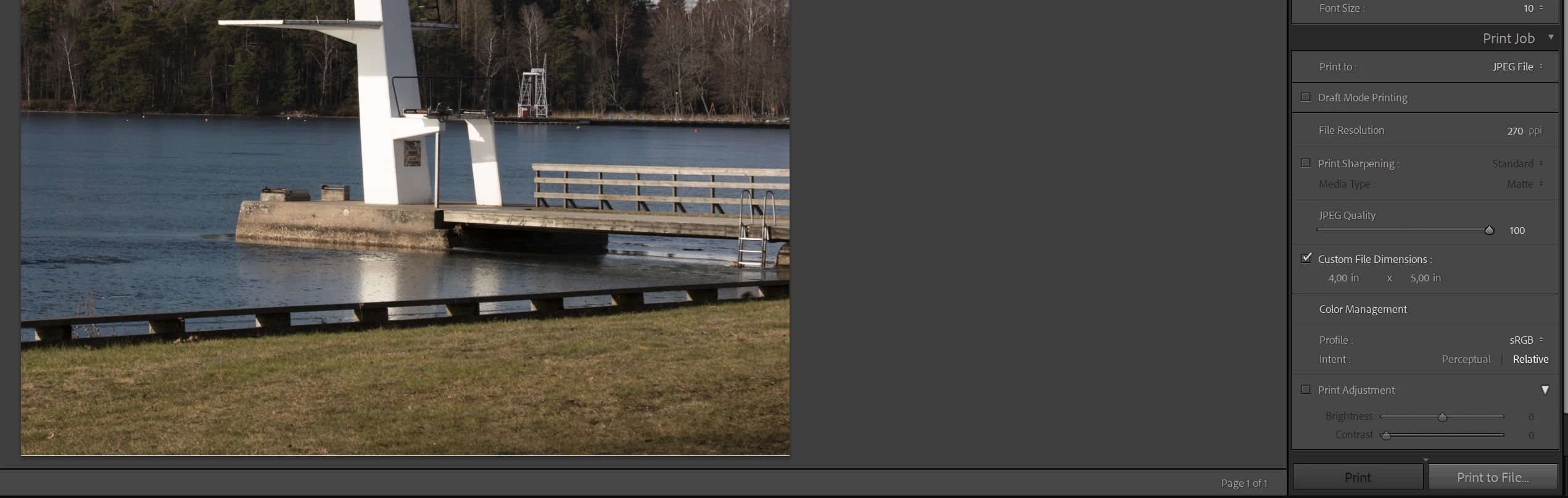

There are no very specific steps to reproduce it. It appears when I create layouts in the Print module, in a variety of aspect ratio, as mentioned, as well as different output resolutions.
Here are a few examples, with LrC fullscreen on 4K.
The white line disappears if I hide the toolbar or the top panels. If I hide both at once, the line is there.
Line visible when toolbar hidden (with or without top panel), invisible with both toolbar and top panel.
Line visible with top panel (with or without toolbar), invisible without top panel (with or without toolbar).
I could go on and on, showing/hiding different things and/or resizing the LrC window...
