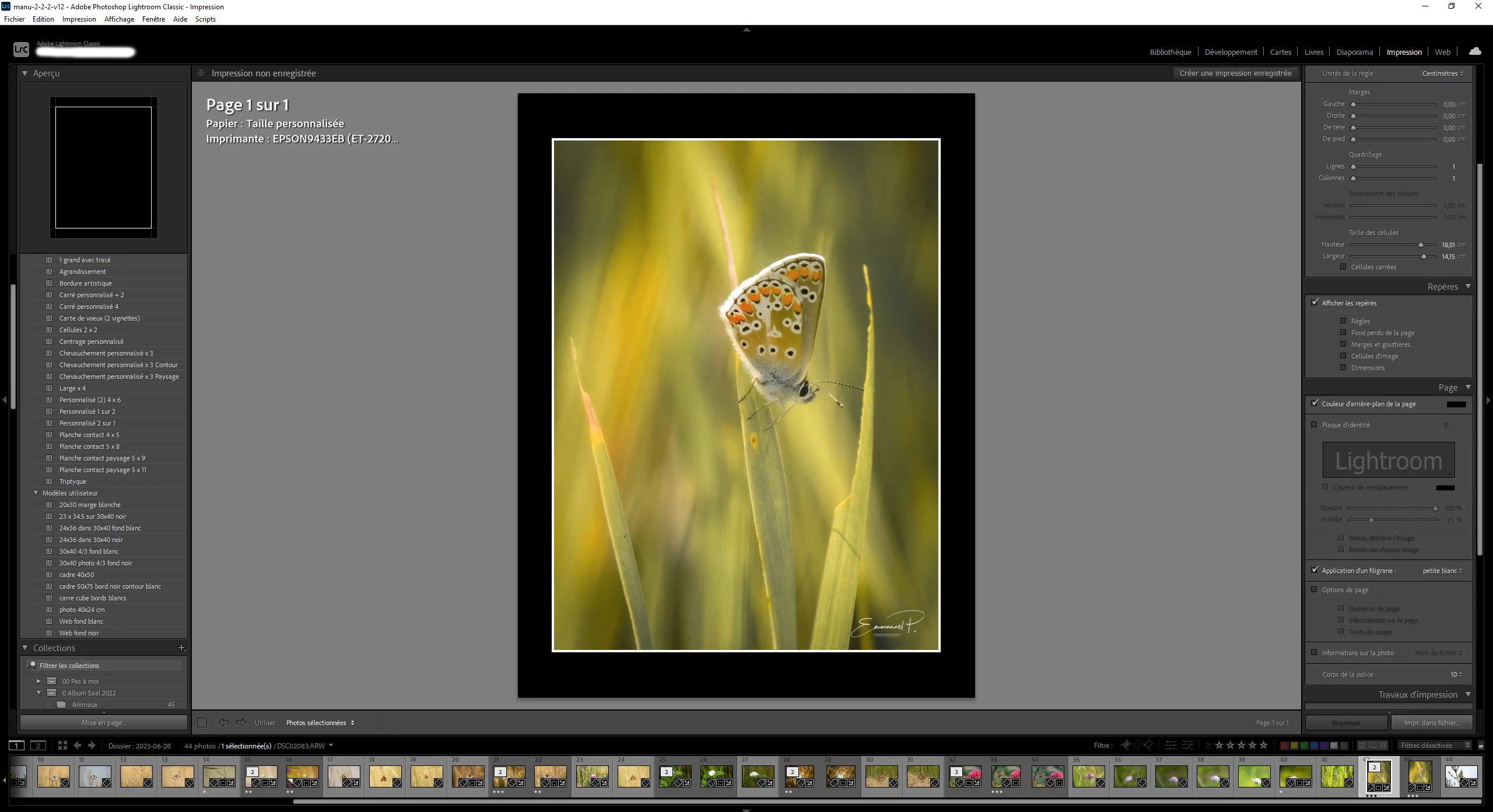

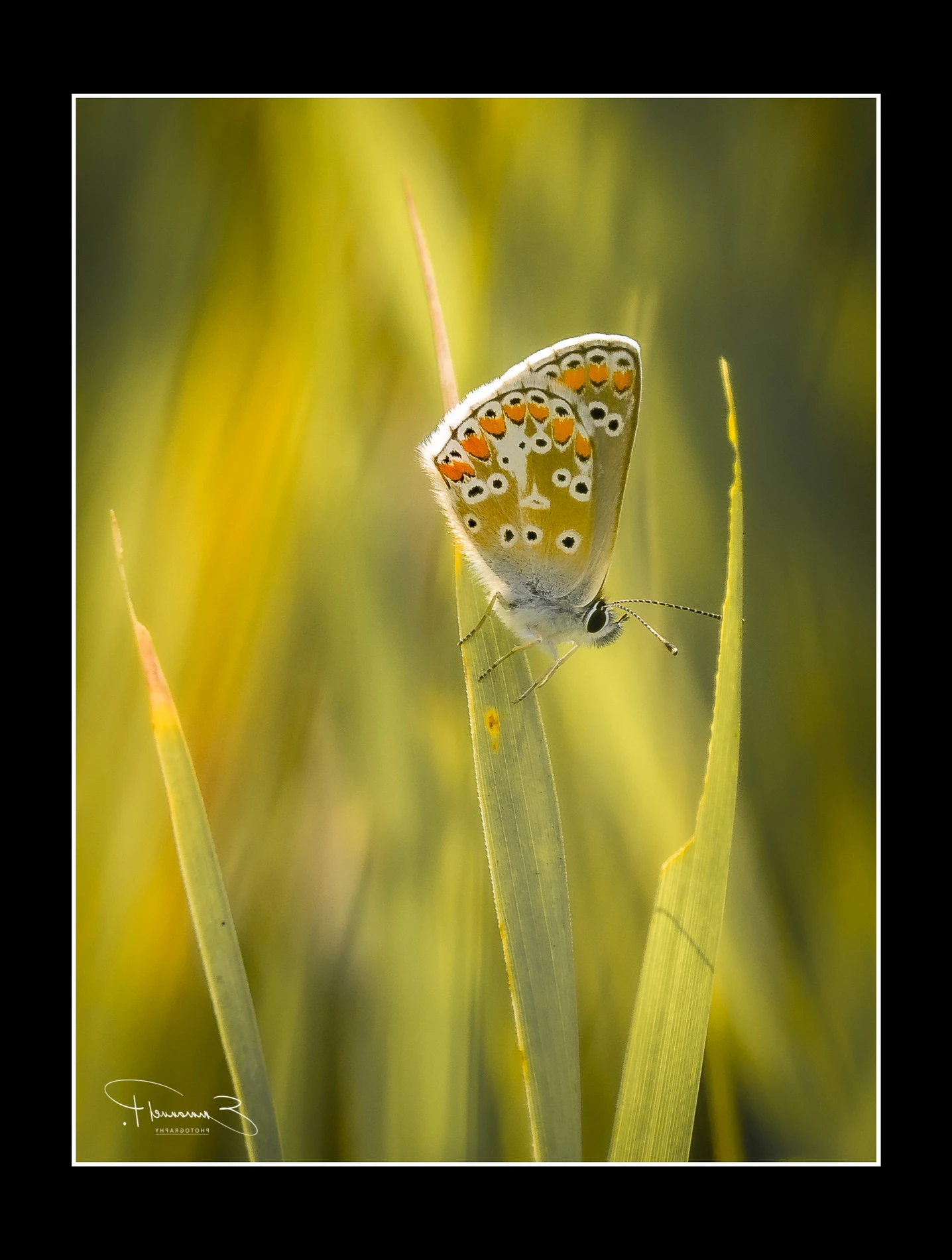

when processing my photo with LRC, if I do a horizontal flip, then modify my settings and then reset everything to 0 by pressing the button, my photo remains inverted.
If I want to print my reversed photo with my signature (watermark), the preview is correct but the file is printed with the signature reversed.

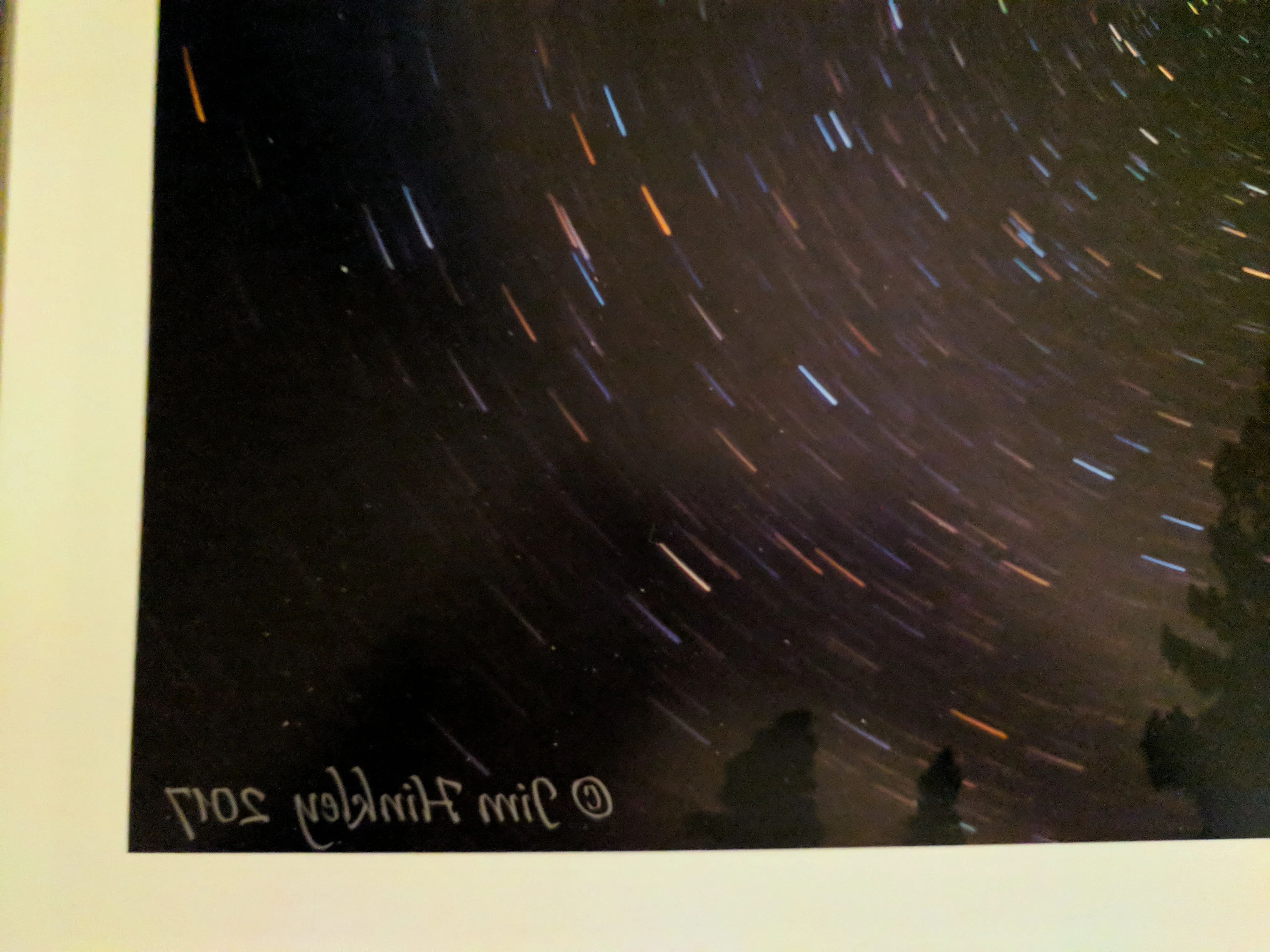

As a fairly new user of the Lightroom Classic CC's Print module, I figured I must be doing something wrong when the watermark on my image printed in mirror image.That's right, after flipping my dng file and sending it to print my Watermark was on the left side vs the right AND in written BACKWARDS (in mirror).
I am using Windows 7 Pro 64 bit Lightroom Classic CC 7.0.
In doing a little research in the forum, I see a few similar threads going back quite a while.
Chuck D Wells Aug 17, 2012 3:31 PM experienced the very same issue and a bug was noted in this :
Horizontal Flip also flips watermark when print to jpeg
MY problem is exactly as he documented with customer service rep in 2012. The preview of the print job looks perfect. It is only when you get the job off the printer that you see the reversed watermark.
Has anyone else encountered this? Unfortunately it can be a rather expensive mistake when you commit a 13"x19" print job on Pro Luster Paper!!
Thanks everybody for listening to my rant!
