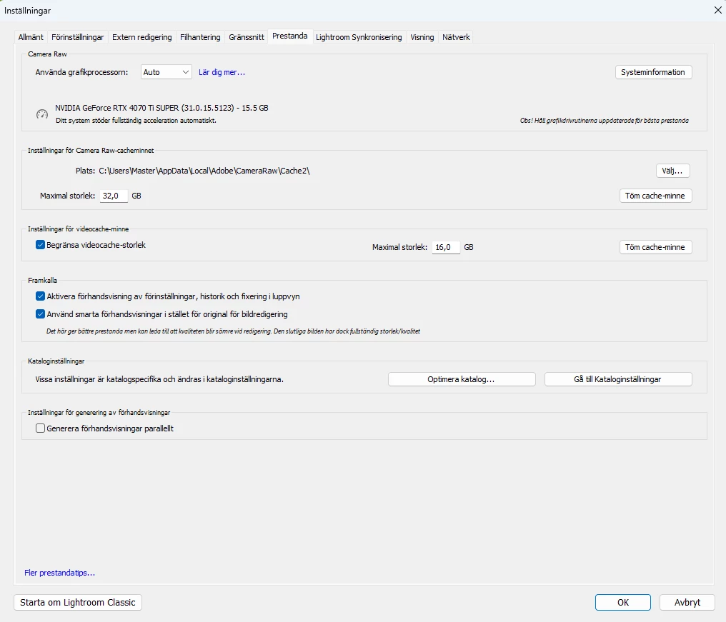

In LrC, in /preferences/performance/ what do you have for Camera RAW CACHE?
Feb 11, 2024 5:17 PM UTC
Best Regards/Torleif
GoldingD
Feb 11, 2024 5:30 PM UTC
Nothing in that screenshot look wrong. Not the issue then.

D Fosse
Feb 11, 2024 12:12 PM UTC
Denoise runs entirely in the GPU and that's where to start troubleshooting. It doesn't touch the CPU, except maybe minimally in writing the resulting linear DNG.
Is this a laptop with dual graphics? Dual graphics is always a potential conflict - you can't send data to one GPU and get it back from the other.
Please post Help > System Info.
If you have Photoshop installed, System Info from Photoshop is much more complete and gives a better picture, so it might be easier to spot problems there.
