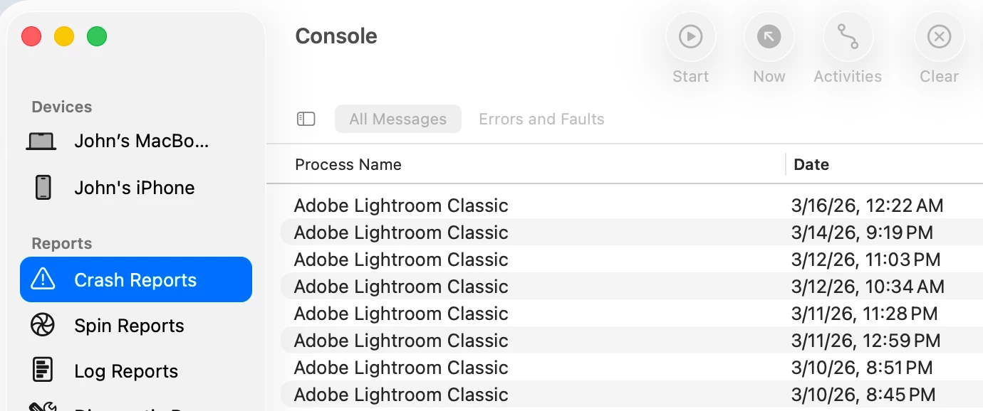

Mar 16, 2026 4:08 PM UTC
Similar crashes continue to occur regularly, once every day or so:

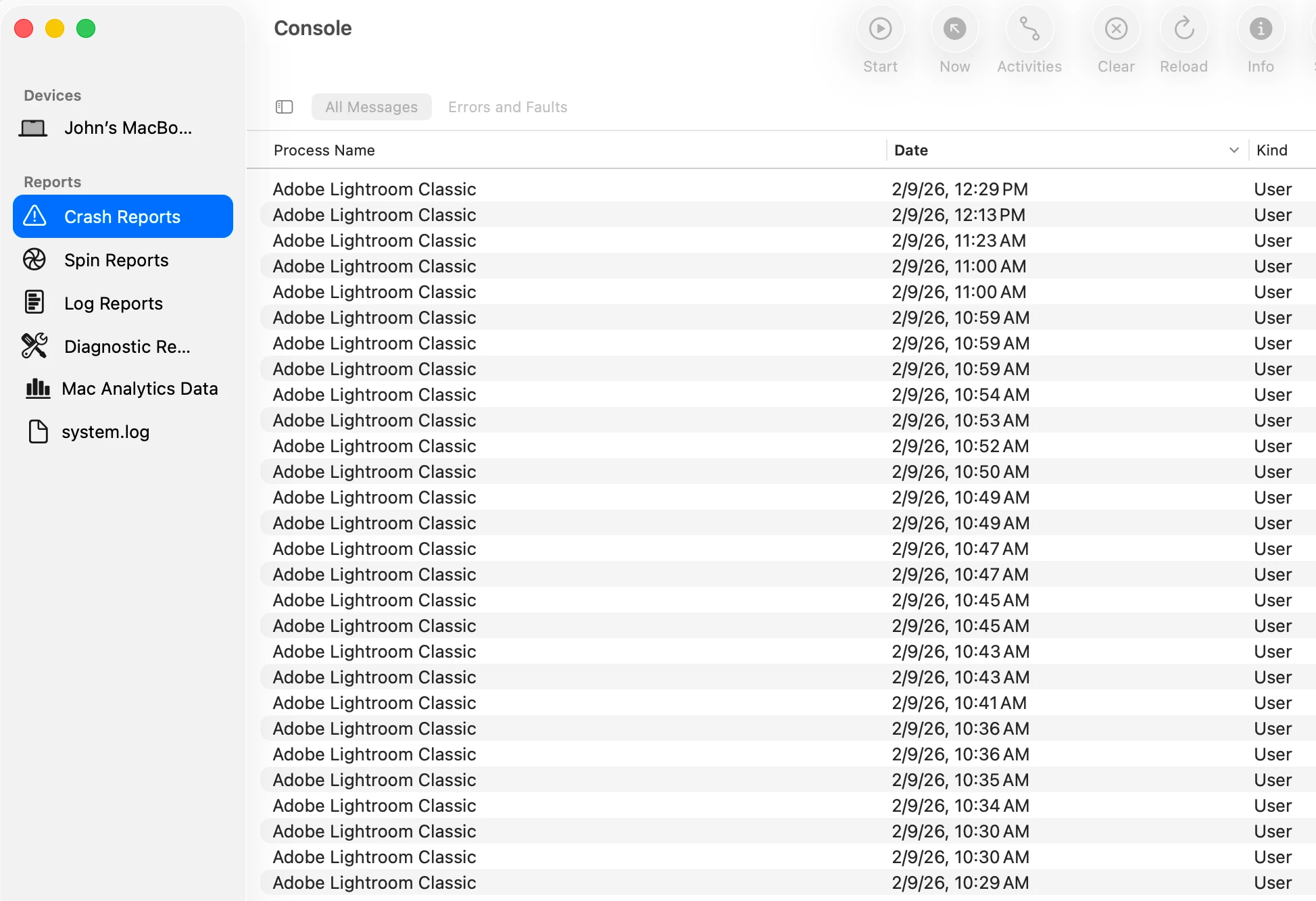

Feb 9, 2026 8:38 PM UTC
Got a long sequence of similar crashes in an idle Lightroom Classic process while I was away. I’ve attached the first one from the sequence:
