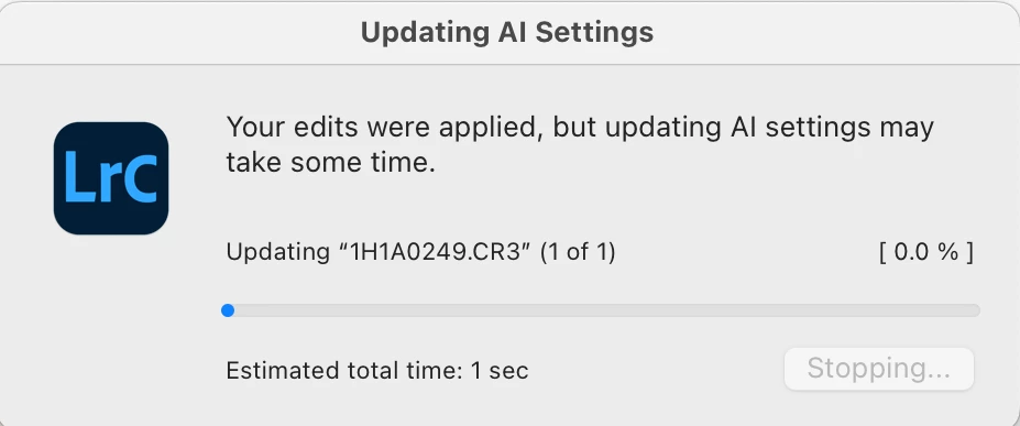

 with a preset containing AI Settings, this will trigger the calculating ai settings dialog in newer LrC versions most of the times.
Issue 1)
When calling LrTasks.sleep(1) immediately after the call and keeping the withWriteAccess lock some time does prevent the dialog from showing up and seems to bring LrC in a state where it won't show the dialog anymore even without the LrTasks.sleep(1). This seems pretty random to me (maybe some race condition). But sometimes my LrC is in a state where it won't trigger the dialog.
This is rather annoying and inconvinient, but the more serious issue is:
Issue 2)
When LrC does show the dialog, it seems to show it for every photo separately, leading to many dialogs popping up and blocking each other as seen in my screenshot
One cannot cancel the below dialogs and when trying to cancel the frontmost it just sits in the "stopping" state forever.
 Generally as i said it seems somewhat fragile to get LrC to show this dialog at all (sometimes it is in a state when it wont show it and sometimes it does). So there is some smell of race conditions.
Generally from my perspective the best solution would be to allow the plugin to trigger the AI Settings calculations via the SDK, so that it can be triggered under a controlled flow after all photos have been updated.
Alternatively it would probably be good to only trigger one update after all photos have been updated and the writeAccessLock has been freed.

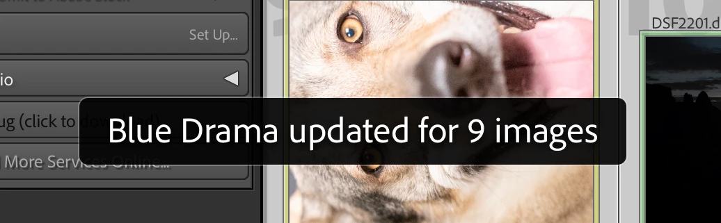

johnrellis
mar 3, 2024 11:56 p. m. UTC
[This post contains formatting and embedded images that don't appear in email. View the post in your Web browser.]
I also observed bad behavior when running your script:
With "if false":
- In Develop, with just 9 photos selected in the filmstrip, LR 13.2 / Mac consistently locks up while showing the dialog for the third or fourth time, and after clicking Stop I have to force-quit it:
- In Library Grid view with the same 9 photos selected, LR showed the bezel off and on and it didn't lock up:
While that was going, I noticed the CPU usage was high.
With "if true":
- In both Develop and Library, I see multiple dialogs pop up and clicking Stop shows "Stopping" but then LR locks up.
Traducir
