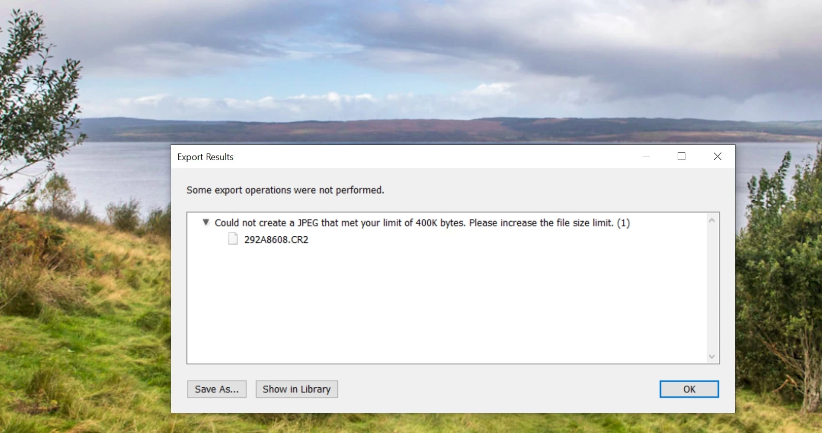

I've been asked to report this as a bug in Lightroom Classic v11
When a Select Sky mask is added, and 'All Metadata' is selected for export, an error message is generated, screenshot attached. This forces the user to choose a larger file size that may be desired in the circumstances. If a different Metadata setting is chosen, the problem does not occur.
It seems that Select Sky and All Metadata have a compatability issue.

JohanElzenga
Oct 29, 2021 6:03 PM UTC
The explanation might be that 'All Metadata' includes Camera Raw settings (i.e. develop settings) and the new masks are part of that. So if you want to export with all metadata, then use the option without Camera Raw settings (or accept that such masks are too large to keep the image size down below 400 KB).
-- Johan W. Elzenga
JohanElzenga
Oct 29, 2021 5:31 PM UTC
Confirmed on MacOS. I think that the mask itself is added to the metadata, and thus making it impossible to keep the file size limited to 400K.
-- Johan W. Elzenga

I've just updated to the new Lightroom Classic v11, but am having an issue with the 'Select Sky' mask. If I use it to select and adjust the sky, then try to export it I get an error message as shown in the attachment. This doesn't happen with any of the other masks, including 'Select Subject'. The error does not appear if there's an obvious clear line between sky and horizon with no obstructions, but that was never a problem anyway. The point of the sky masking update is surely to make complex masking easier.
Depending on the complexity of the selection, I have to increase the file size typically to 1mb in order to export. I don't want to do that as the exports are usually for my website and this will increase page loading times.
Any help/insight would be much appreciated.
