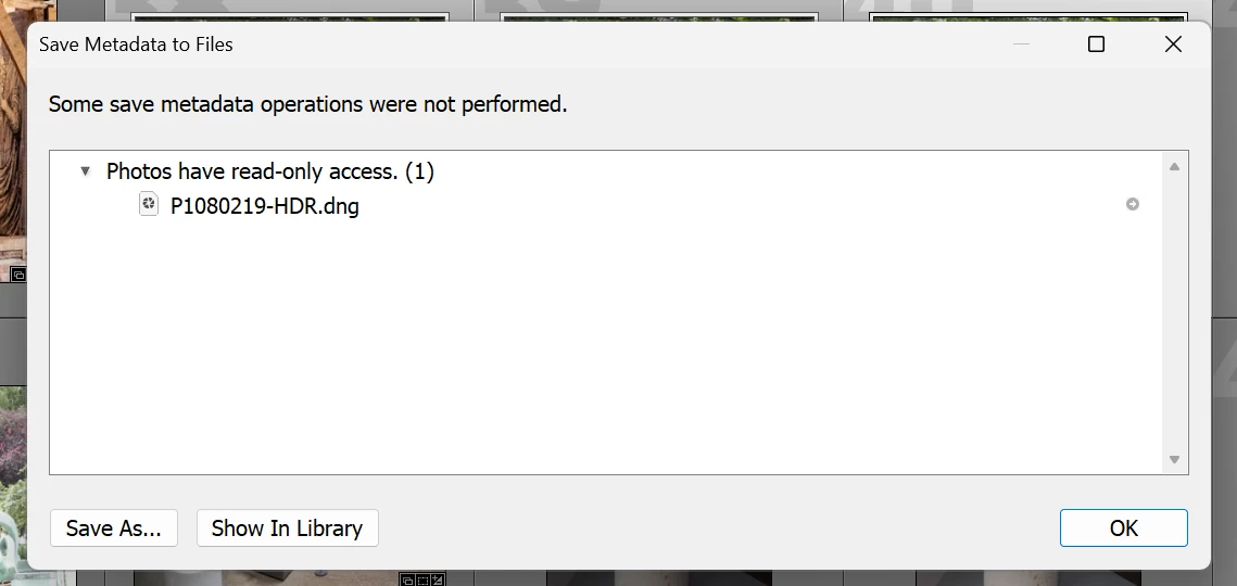

I am getting the same fault described in the bug report at https://community.adobe.com/t5/lightroom-classic-bugs/p-quot-some-save-metadata-operations-were-not-performed-quot-error-occurs-when-merging-to-hdr/idi-p/12249439, But thought it worth raising a new report because:
  • It happens every time, whether in batch mode or not.
  • I have Face Detect and Address Lookup both switched off.
The symptoms are that whenever I perform an HDR or a Panorama Merge operation, it runs ok until the final "Merge" operation which ends by putting up a dialog box with the error message quoted above in the title (see screenshot).  After clicking OK in this box the file appears to be created correctly, and is not read-only.  (The containing folder is reported as Read-only, but it is impossible to switch this off, and has no other effect on creating files within it.  Reportedly Windows has been like this for a long time.)
I am running on: Windows 11, with all latest updates applied;  Lightroom Classic release 13.4.
