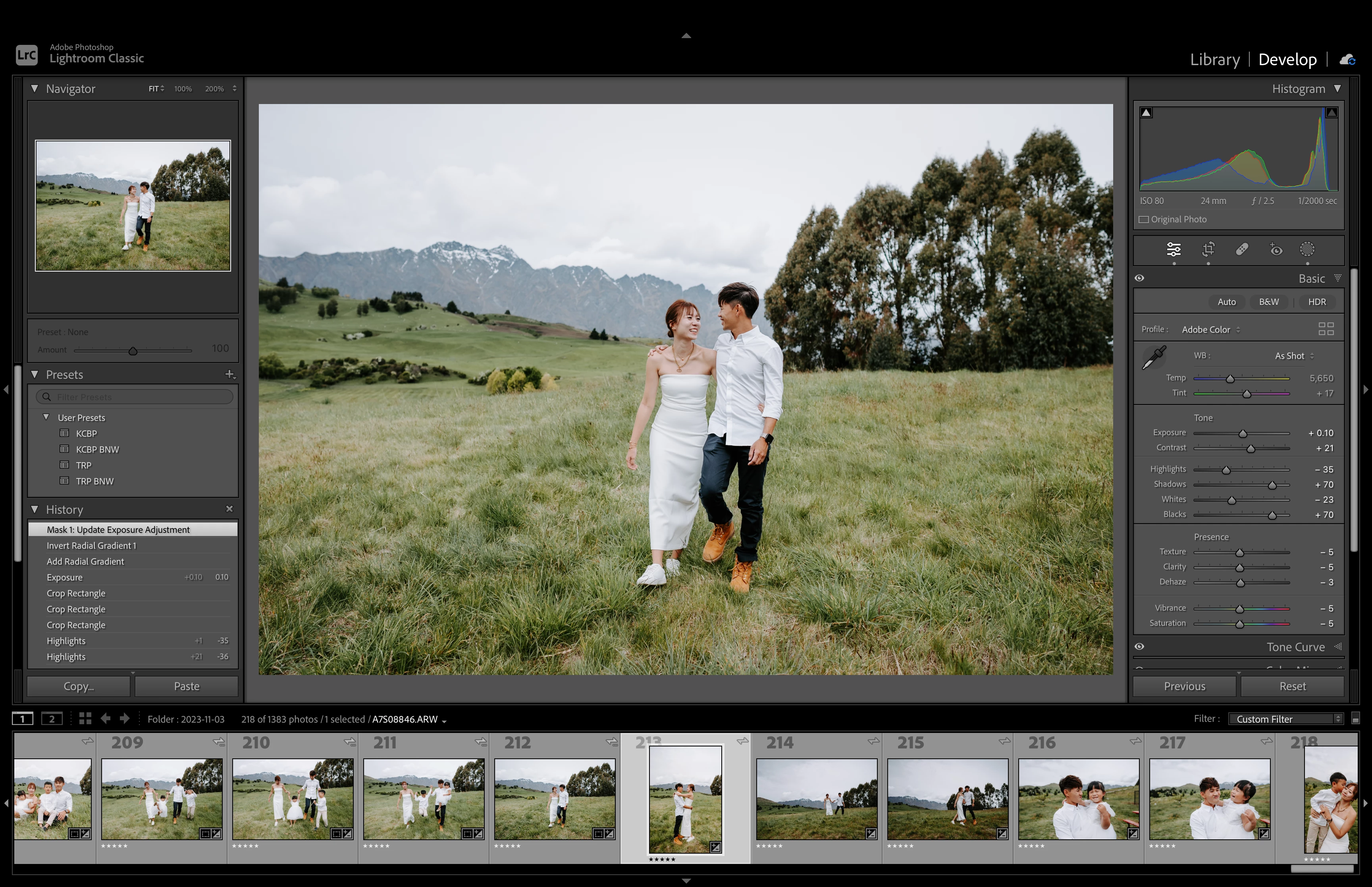

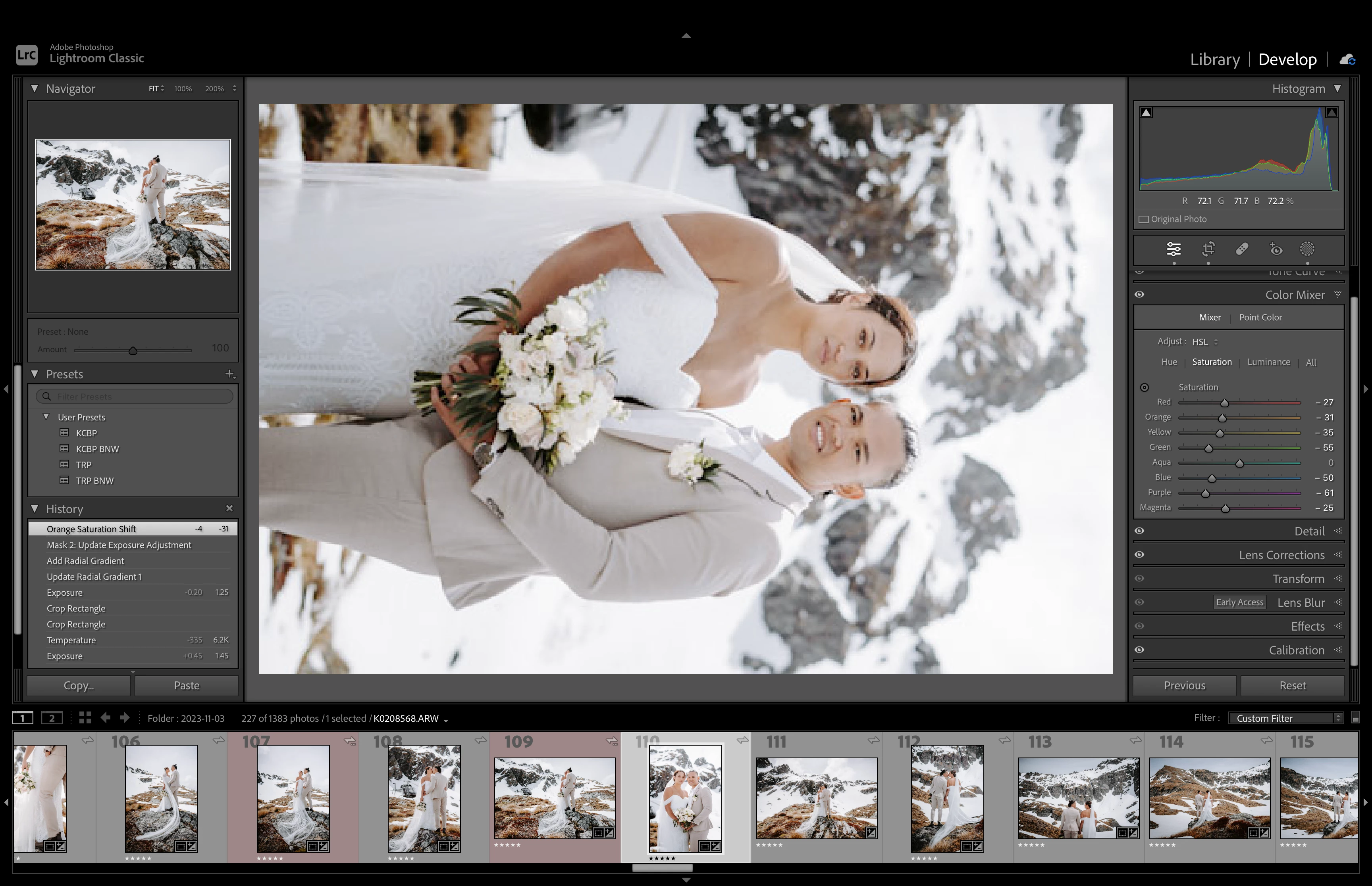

Correct me if I'm wrong...but by engaging capslock and using 1 to advance you are simply using the rating to advance? In the screenshot I posted last I was using capslock + 5 to advance as I use 5-star ratings to temprarily rate images. I have created a couple of lovely videos using your method with both the 5-star rating advance method + the 1-star rating method to advance through images. Both reuslting in the same issue.
I think you might want to try editing at the pace I do without the circus tricks and see if you come across the issue under normal circumstances...If not, then you are for one reason or another not expericning what the other 250+ users on this thread are experiencing.
