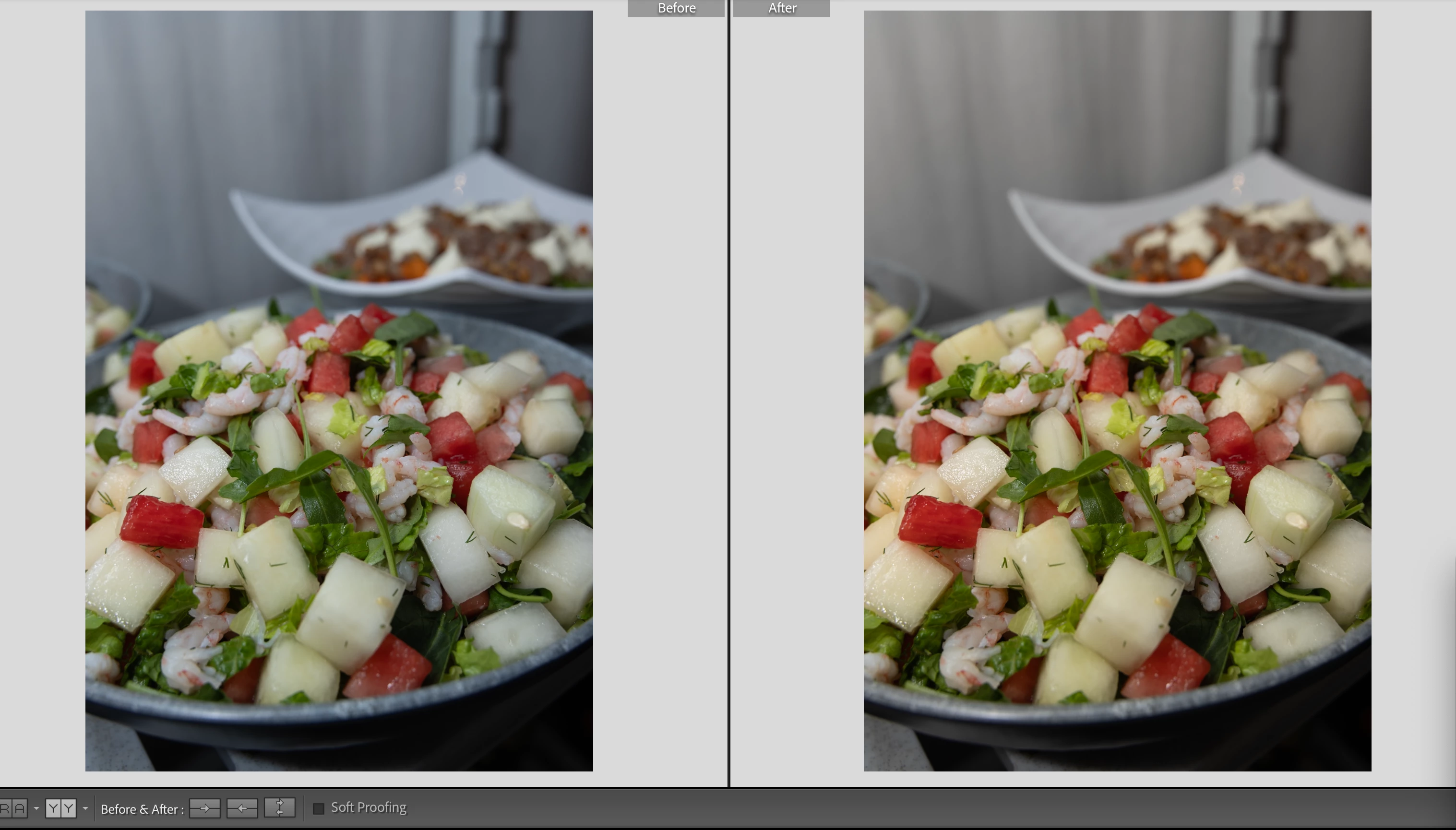

Jun 7, 2024 8:57 AM UTC
I have had this problem for a while now, and the problem is that my before and after looks different after importing (raw) them to lightroom classic.
Before is colder and looks better than after and I have not done anything for the photo, reset does not help.
I have iMac.

I now realize that an issue I experienced when upgrading my v13 catalogs to v13.3 may also be related to this.
Several photos suddenly receive an additional history step "Multiple Settings". That step does not change the develop settings, but when I do a before view the white balance of the before view has visually changed!?!
This is the same phenomenon we see with the imported photos that are given the "White Balance: As Shot" step out of the blue.
I have not adjusted the white balance myself. Before the upgrade, the white balance was the same in the before and after view.
The white balance of the after view after the upgrade is the same as the white balance of the before and after views before the upgrade. That was expected because no WB adjustment was made by the user.
The white balance of the before view after the upgrade is different from the white balance of the before and after views before the upgrade and the after view after the upgrade. That was not expected.
I mention it here because it might ring a bell among the developers.
