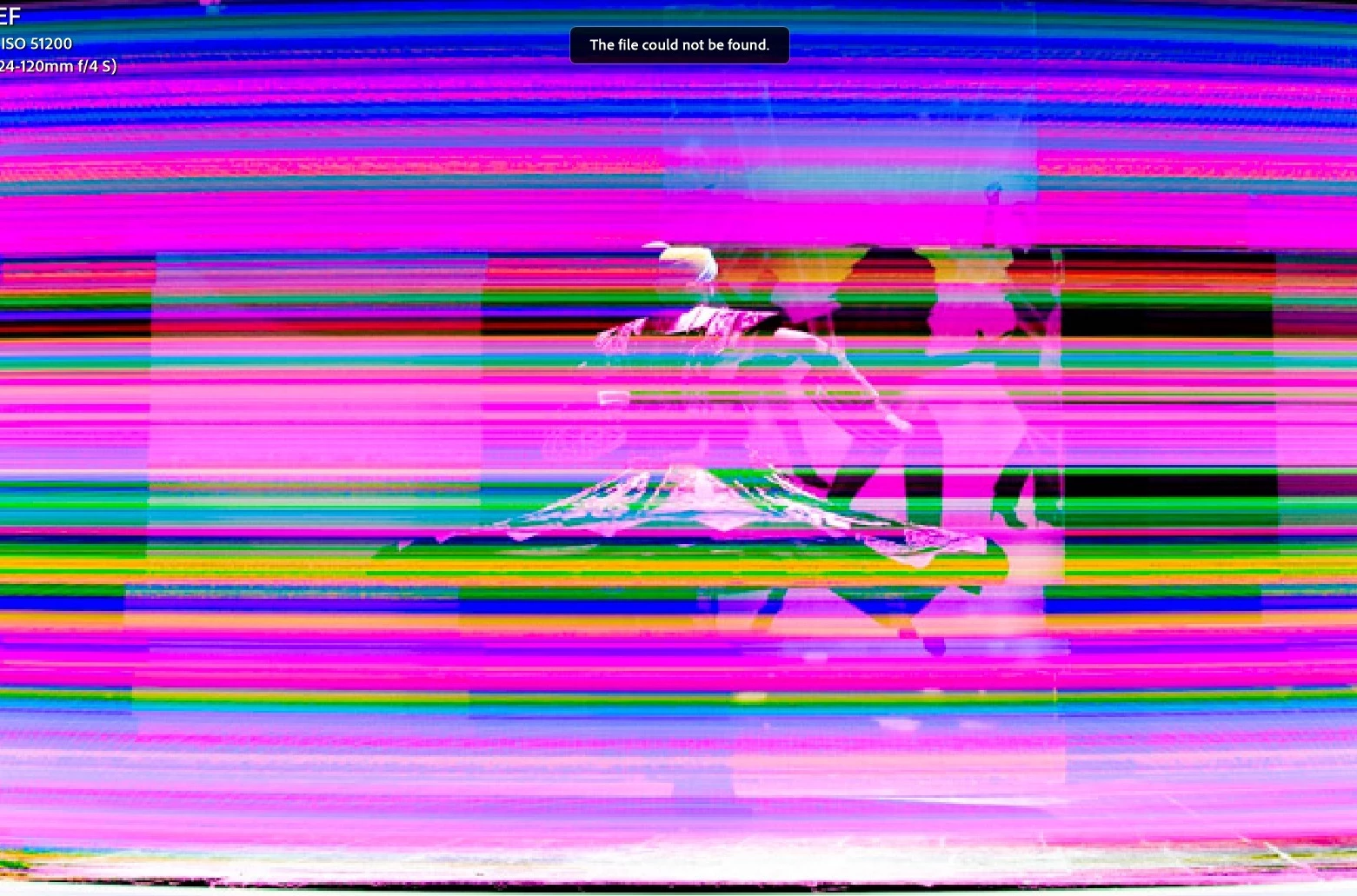

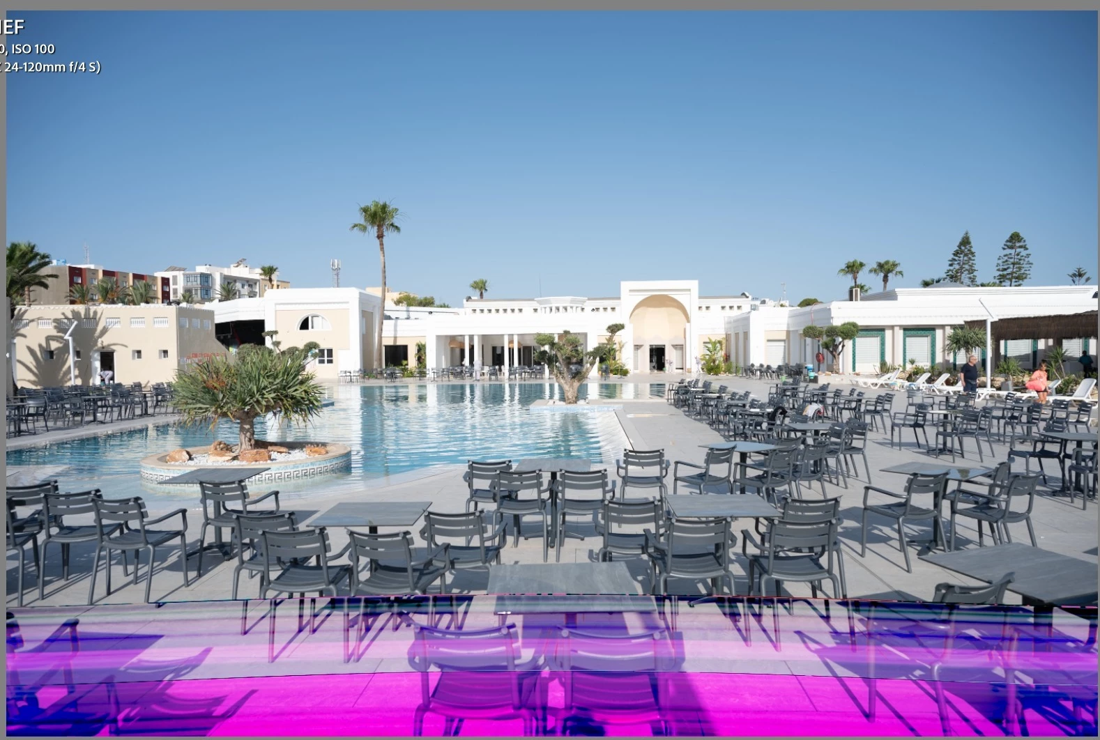

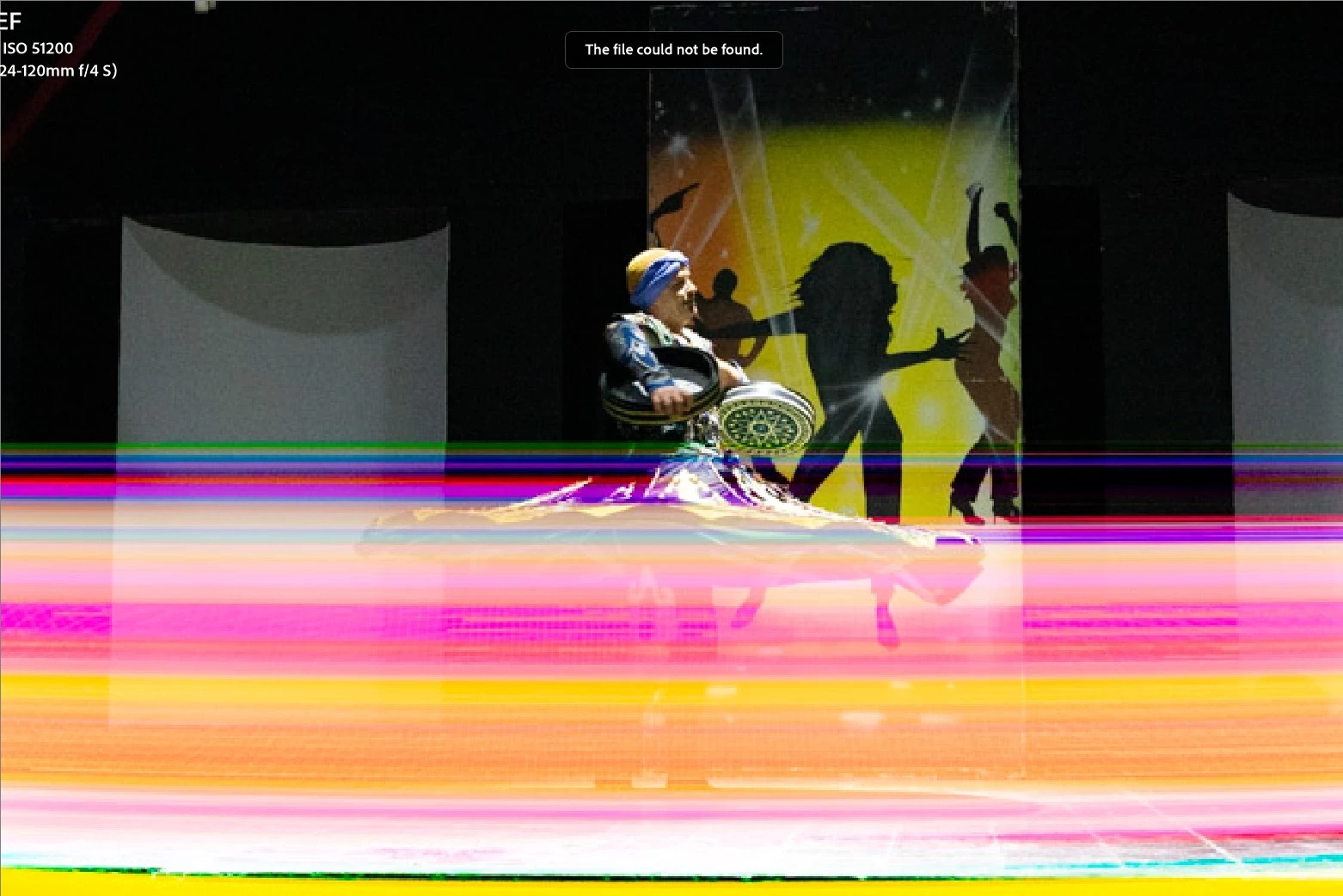

Hello, my raw files are getting color distorted in Lightroom.
I tested different card reader, different apps and different PCs.
This issue is showing on exactly one PC, not any other in the household.
I will try updating graphics drivers tomorrow, Lightroom was up-to-date in the time of the incident.
Image shows distorted even when exported.
Attaching examples of affected images.
Thank you for your tips.

    This looks like file corruption. When you say they don’t look like this on the other computer, do you mean the exact same copies (images are on an external drive you use on both computers) or different copies of the same images?

    June 22, 2026
    Hello, it’s different copies of the same images.
    I am also using different card readers to download the image from the same card.

    Then this is probably indeed file corruption. The cause can be a number of things. Hard disk problems, a faulty USB port that you use to connect the card reader, anything else that can disrupt reading the image into Lightroom.
