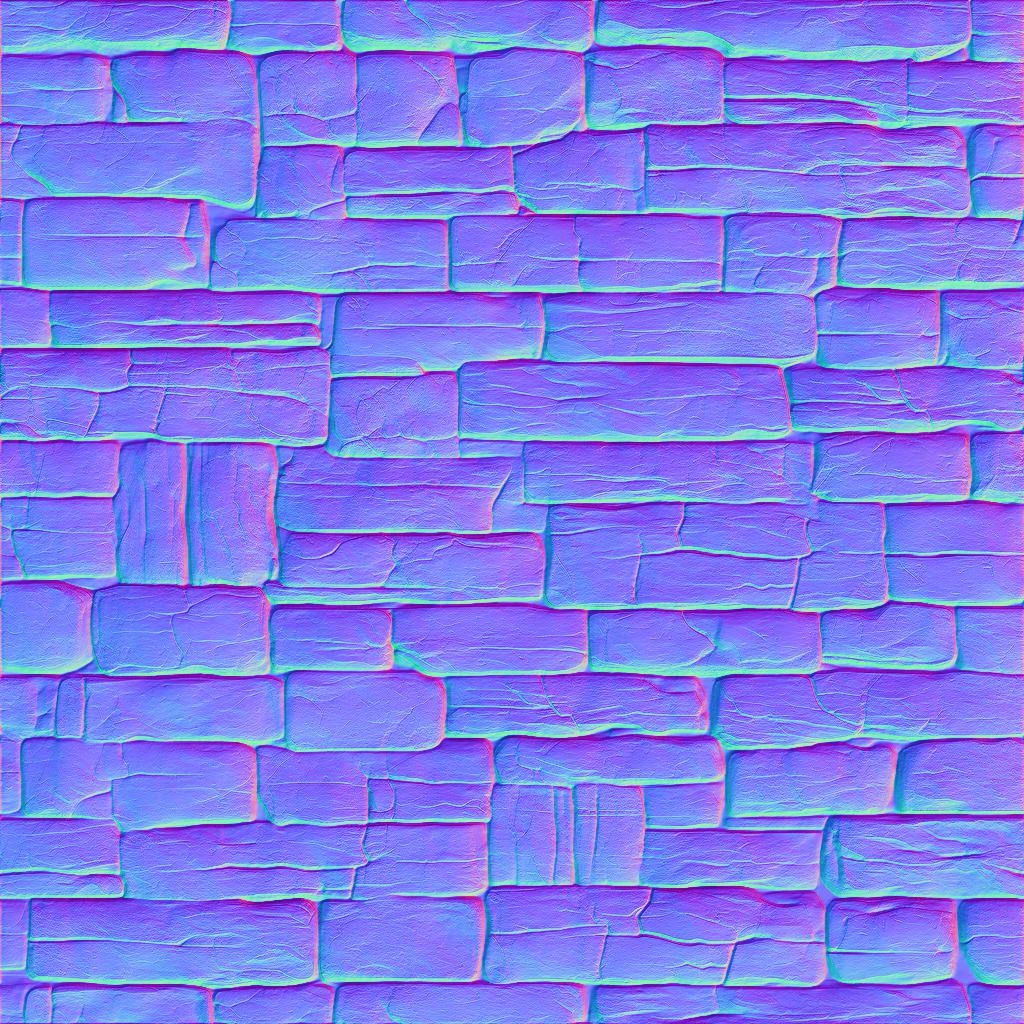

I can't see any difference when siwtching my project settings from OpenGL to DirectX when outputting a Normal Map.
I think, this is a bug and should be fixed.
I compared two Normal Map Exports. One is Exported with DirectX and one is Exported with OpenGL.
The Normal Maps are 100% identical.
It only exports with DirectX and OpenGL doesn't seem to work.
I was running a test and checked the map inside a game engine, that's using OpenGL.
And yes, the shadows are upside down, shows that the export for OpenGL ist not working even when the project is setup with OpenGL.
Please can you check and let me know if you can reproduce that issue?
DirectX Export
OpenGL Export:

I hear you PixelFun!
Adobe... a core fundamental element of 3D texturing software is to be able to output maps correctly... without getting that right as your primary foundation... the entire program is, well... kinda pointless unless you are only concerned about DirectX!
PLEASE, please fix this ASAP.
After a few tests on Version 4.3.3 - Empanada, running Windows 10.  Below were the results.
1. Changing the Project Normal format option (in Edit/Preferences), from DirectX does NOTHING. Adobe already knows this and were meant to remove the option from the menu so as not to continue to cause confusion. I was informed that exported Normal maps were to be determined by choosing the appropriate Export Preset (in Export/Export As/Material Settings/Preset dropdown).
2. Changing the Export Preset annd exporting as PNG DOES change the Normal map format to OpenGL (I tried Blender, Lens Studio, Spark AR and Unity). However... I was not able to export 16bit PNG Normals. The only way to get a Normal map in 16bit was to either use the Default Export preset... which is locked to DirectX... or to use my own custom preset which I set up in Substance Designer (which is what I have been doing for the last 6 months because Adobe still have not fixed the issue).
PixelFun, if you want I am happy to share the preset I made (although I cannot remember how I made it exactly ... I made it out of neccessity and frustration and works for my current needs. Anyway, hit me up if you want to try it).

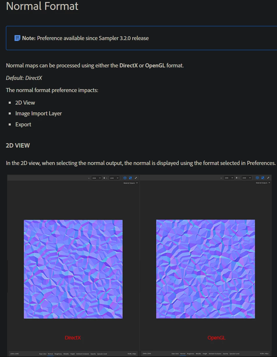

Cyril Dellenbach
September 28, 2023
Thanks for your responses.
To answer you @leighv123, I'm not exactely sure when this change occured (I could investigate if you want), and the Normal format under the Preferences sets up which format the Default export preset will (should) use, in addition to which format an imported normal map will take.
As for the documentation issue, I've notified the person in charge, so thanks for the report.
As @bernhardrieder mentioned, one thing is for sure (and this thread highlight it), the current state of the Normal format isn't intuitive, and following these messages, we now have discussions on the subject.

Cyril,
Thanks for your response.
When did Sampler stop OpenGL support?  I was unable to find that information anywhere in the release notes.
Also the documentation still states that the normal format preference impacts the 2D View, Image Import Layer and Export (see attached images).
If this is not the case is there any point in having the option to set Normal format in Preferences/Project setting?
Thank.
