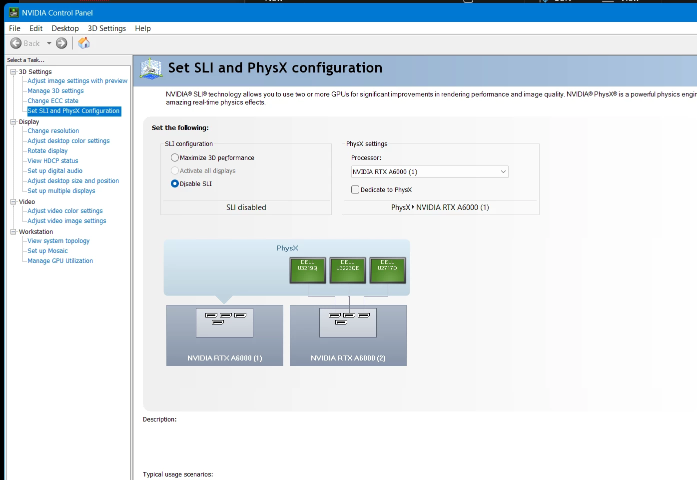

Yes, confirming that Substance 3D Sampler launches without issue when 'SLI Configuration' is set to 'Disable SLI' (remember that NVLINK is a physical connection which remains in place unless manually removed).  The behavior of the three connected displays changes in single GPU mode and is a bit funky (resolutions change) but these issues can probably be addressed via other settings.

Changing the SLI mode while the GPU is in use and experiencing a crash is due to a driver limitation. This occurs because the GPU device disappears and is recreated with the “new” configuration.

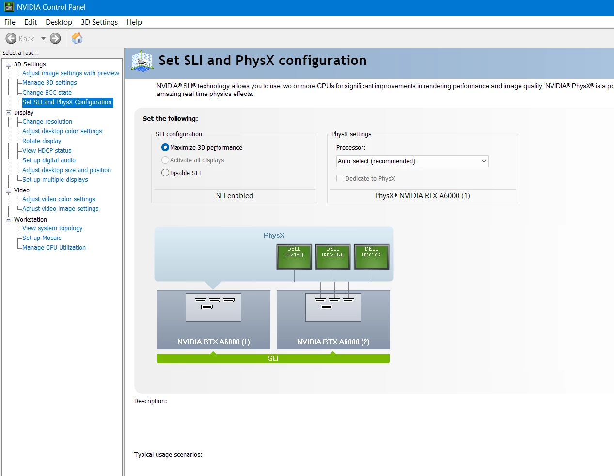

We are running two NVIDIA RTX A6000 GPUS which are physically connected via NVLINK and via the NVIDIA Control Panel (version 8.1.969.0) have the 'SLI configuration' set to 'Maximize 3D performance'.   Enabling SLI allows applications to see 96GB of shared GPU memory.
After changing the setting to 'Disable SLI' and selecting either one of the RTX A6000 GPUs, Adobe Substance 3D Sample launches and runs without crashing.

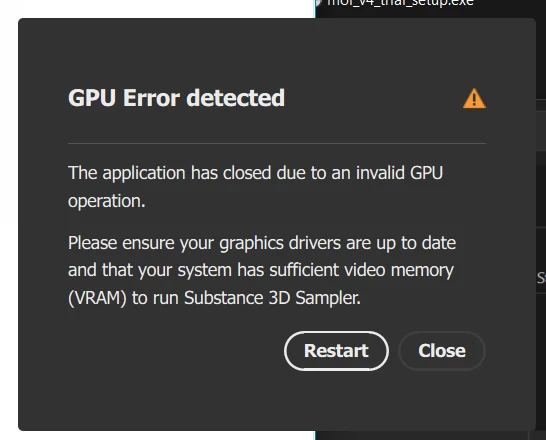

After disabling and re-enabling SLI, Substance 3D Sampler generated a pop-up error message that did not appear during previous crashes:
So it looks like something related to SLI and NVLINK is the culprit.

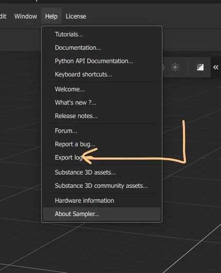

@Ares Hovhannesyan, thanks for your note. Sampler 3D crashes before I can even get to the menu in your pic.  The Adobe help link sent by @Marion3D includes instructions on how to locate the log.txt file in case the app crashes before you can get to the help menu, which I've already done.  My goal is to send the log file to Adobe privately without exposing it to the world since it contains some identifying information about the system.
Ares Hovhannesyan
Dec 6, 2025 2:45 PM UTC
How to export log file.  Go to help menu, export. Then attach Ffile.
