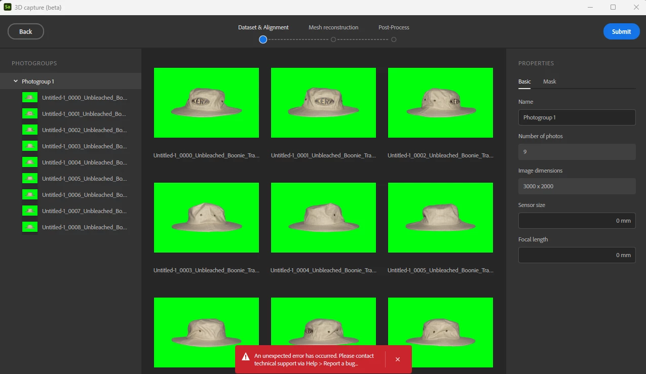

I've just got started on Adobe Sampler and I'm trying to convert a set of images from a product photoshoot into a 3D object.
Importing the photoset goes fine, but it comes up with "an unexpected error occured" in the alignment process.
I made the images transparent PNGs in the hopes that it would be super easy for the AI to find the object but even with bight green background JPEG, it threw up the same error.
Any advice?

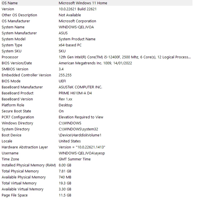

My PC specs are attached, as well as a error log and a screenshot of the error!

Considering your screenshot and the log, your project has very probably not enough picture to compute the 3D model. I advise you to have around 60 images in order to make a clean scan.

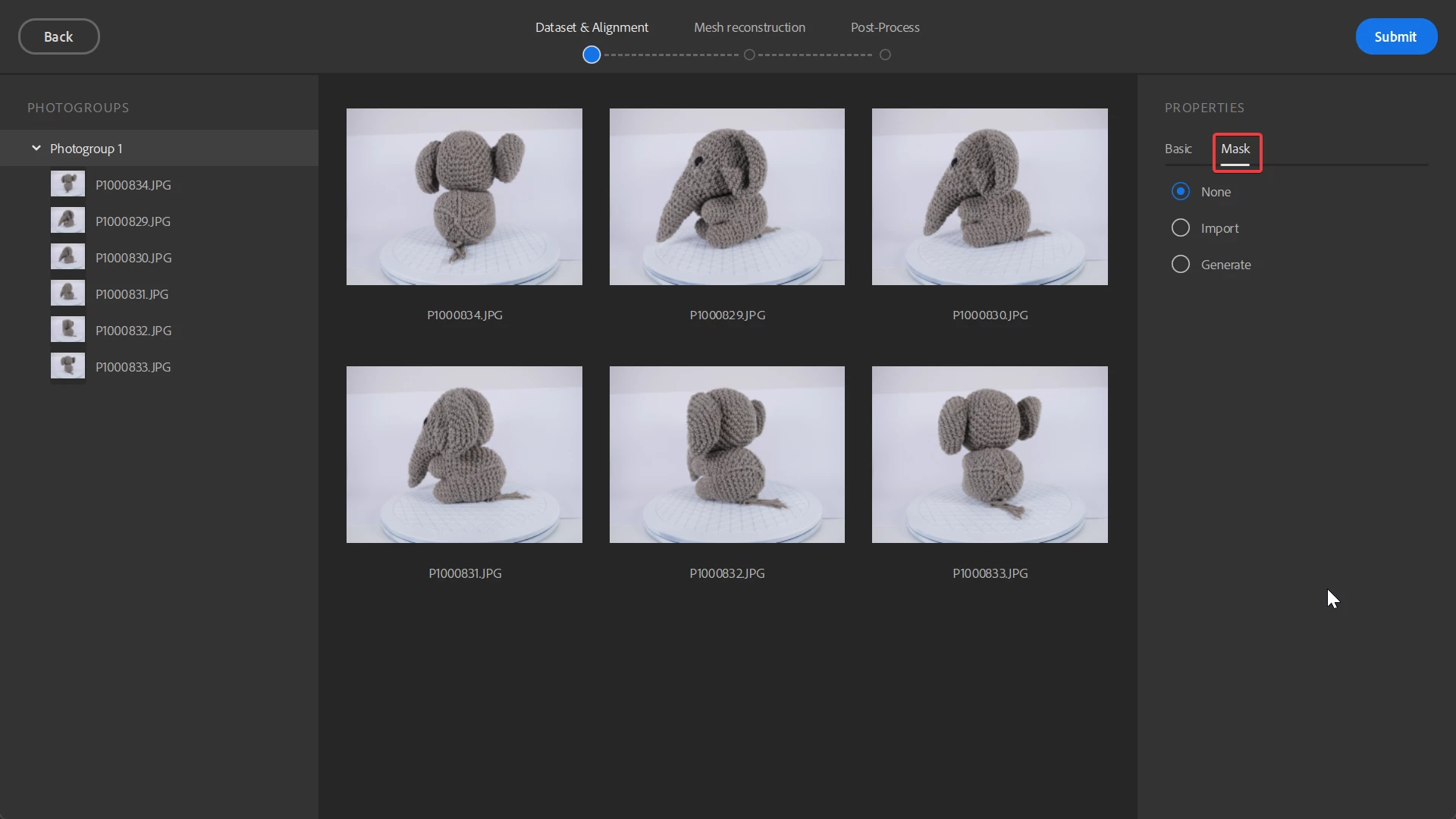

The green background shouldn't be an issue, but just so you know, Substance 3D Sampler has natively an option to mask your object.
